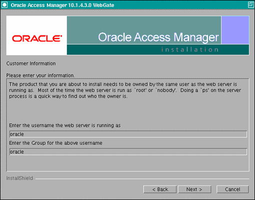

In the Customer Information screen (Figure 11-1), enter the user name and user group that the web server is running as. Click Next to continue.

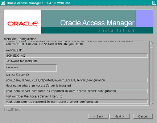

In the WebGate configuration screen, provide the details of the access server that will be used. You must provide the following information:
WebGate ID, as provided when the OAM configuration tool was executed
Password for WebGate
Access Server ID, as reported by the OAM Access Server configuration
Access Server host name, as reported by the OAM Access Server configuration
Access Server port number, as reported by the OAM Access Server configuration
The Access Server ID, host name, and port are all required.You can obtain these details from your Oracle Access Manager administrator. Click Next to continue.
Figure 11-5 Access Server Configuration Screen
