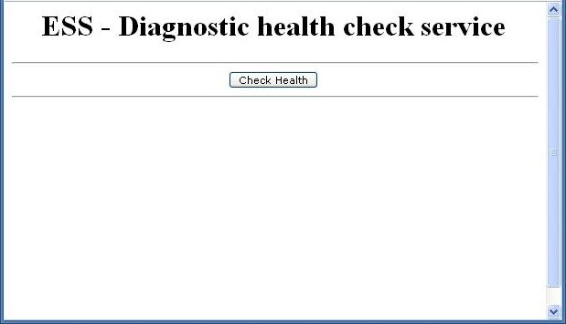

The Oracle Enterprise Scheduler Diagnostic Health Check page displays, as shown in Figure 2-1.
Login to the diagnostic servlet using an Oracle WebLogic Server administrator username and password.
Click the Check Health button to verify the installation.
