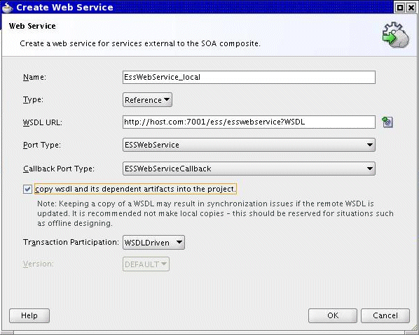

In the Name field, enter a service name, or accept the default name.
In the Type field, from the dropdown list select Reference.
In the WSDL URL text field enter the value for the WSDL URL manually, for example:
http://host:port/ess/esswebservice?WSDL
In the SOA Resource Lookup dialog, click OK.
In the Create Web Service dialog, in the Port Type field, from the dropdown list select ESSWebService.
In the Create Web Service dialog, in the Callback Port Type select ESSWebServiceCallback from the dropdown list, as shown in Figure 10-3.
Select the checkbox Copy WSDL and its dependent artifacts into the project. This allows the local copy of the Oracle Enterprise Scheduler abstract WSDL and ESSTypes.xsd files to be moved into the SOA composite project.
Keeping a local copy of a WSDL file may result in synchronization issues if the remote WSDL file is updated. Making a local copy of the remote WSDL file is therefore not recommended. However, doing so may be useful for certain scenarios such as offline designing.Click OK. Now the External References lane in composite.xml displays the new web service, as shown in Figure 10-4.
