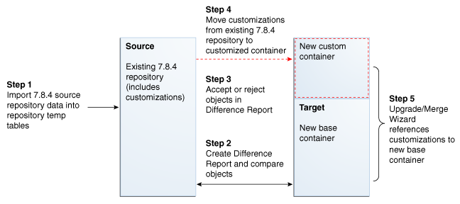

In Step 1 of the high-level process flow, you import the existing 7.8.4 DAC repository into the repository temporary tables. The existing 7.8.4 repository is referred to as the source in the Upgrade/Merge Wizard.
In Step 2, you create a Difference Report that compares the existing repository with the new base container, which is referred to as the target. (The new base container is the version to which you are upgrading and is the version you imported from the file system.)
In Step 3, you accept or reject the objects that the Difference Report shows as being either present or changed in the source but not the target. See Resolving Object Differences in the View Difference Report for a description of how objects are merged based on the action you take.
In Step 4, after you have resolved the differences, you then execute the merge. In Step 5, the Upgrade/Merge Wizard references the customizations in the newly merged custom container with the new base container.

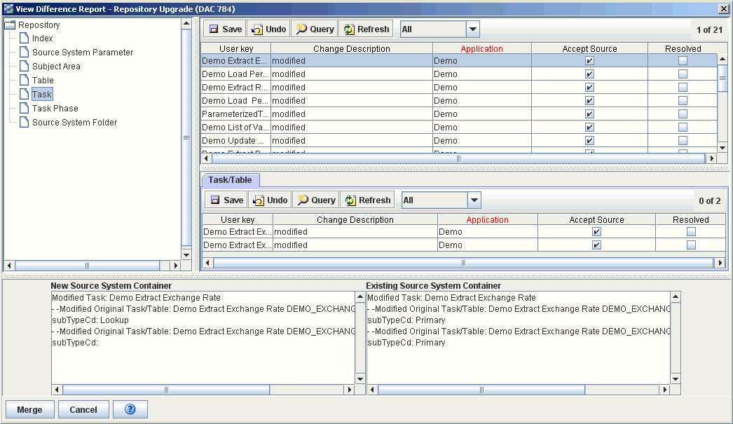

The View Difference Report dialog displays the differences between the existing and new DAC repositories.
In the View Difference Report dialog, resolve the differences between the existing (source) and new (target) containers, that is, between the release 7.8.4 DAC repository and the repository that contains the new base container. To resolve the differences, you need to deselect the Accept Source check box for each object that appears in the difference report.
For detailed information about the View Difference Report, see "Resolving Object Differences in the View Difference Report".
In the navigation tree, select the repository object for which you want to view the differences between the existing and new repositories.
If the object selected in the navigation tree is a hierarchical object, the subtabs for the child objects appear in the bottom pane of the Object Difference window.
(Optional) Filter the objects that appear in the Object Difference window by selecting one of the options from the drop-down list in the toolbar.
For parent objects in the top pane and any child objects in the bottom pane, deselect the Accept Source check box.
For detailed information about these options and the merge outcome, see "Possible Repository Merge Outcomes Based on Your Decisions"
If a child object has been changed but not the parent object, the parent object will still appear in the Object Difference window even though it has not been changed.(Optional) After you have deselected the Accept Source check box for each repository object, select Resolved check box to indicate you have resolved the object.

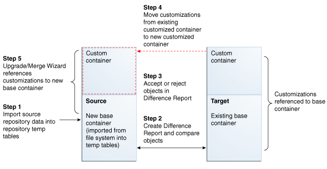

The Refresh Base option enables you to upgrade an existing customized DAC repository. You should use this option if you are upgrading from a DAC release higher than 7.8.4. If you are upgrading a DAC repository in the release 7.8.4 format or lower-numbered releases, see "About the Repository Upgrade (DAC 784) Option".
The Refresh Base option enables you to compare a new base container with the existing customized repository and to create a Difference Report. If you want to upgrade an existing customized DAC repository without comparing repositories and creating a Difference Report, you can use the Simplified Refresh From Base option. See "About the Simplified Refresh From Base Option" for more information.
Figure 15-3 shows a high-level process flow for using the Refresh Base option to upgrade existing customized repositories from DAC releases higher than 7.8.4, such as Oracle BI Applications 7.9 and higher.
The term base is used to refer to a source or target container that you have not changed or customized in any way.
In Step 1 of the high-level process flow, you import the repository data for the new base container from the file system into the repository temporary tables. This repository is referred to as the source in the Upgrade/Merge Wizard.
In Step 2, you create a Difference Report that compares the new base container with the existing repository (including customizations). The existing customized repository is referred to as the target.
In Step 3, you accept or reject the objects that the Difference Report shows as being present or changed in the source but not the target. See "Possible Repository Merge Outcomes Based on Your Decisions" for a description of how objects are merged based on the action you take.
In Step 4, after you have resolved the differences, you then execute the merge. In Step 5, the DAC references the customizations in the newly merged repository with the new base container.

The Simplified Refresh From Base option is similar to the Refresh Base option. It allows you to upgrade from a DAC repository from an older release of Oracle BI Applications to a new release, but you cannot compare repositories and create a Difference Report.
If you want to upgrade a DAC repository from an older release of Oracle BI Applications to a new release and you want to compare repositories and create a Difference Report before merging the repositories, you must use the Refresh Base option. See "About the Refresh Base Option" for more information.
Before you begin this procedure, do the following:
Determine what customizations were made to the existing DAC repository.
Make sure you have renamed and backed up the existing DAC repository into a different database. When you backup the DAC repository, you export the DAC metadata, in XML format (using the DAC's Export tool), into a folder other than the standard DAC export folder where backups are stored (DAC\export). For instructions on exporting DAC metadata, see "Exporting DAC Metadata".
To upgrade the DAC metadata repository
Upgrade the existing DAC repository tables to be compatible with the new DAC repository release.
Configure the new DAC Client version to read the DAC metadata from the existing DAC repository.
Log in to the DAC and select Yes if prompted to upgrade the repository tables.
Export the custom applications from the existing custom repository to a folder other than the standard DAC export folder (DAC\export) or the folder into which you backed up metadata in the previous format.
Import the new DAC metadata for the application from the standard DAC export folder (DAC\export). Select the Truncate Repository Tables check box.
For instructions on importing DAC metadata, see "Importing DAC Metadata".
Import the customized DAC metadata that you exported in Step 2, and deselect the Truncate Repository Tables check box.
This will append all the custom data to the repository, thus bringing in the customizations, which include the following:
All modified data.
All newly created custom data.
All deleted data.
Refresh the source system container to locate any missing objects in the customized application. The missing objects are any new objects that the preconfigured applications may have that are not referenced in the custom applications.
Navigate to the Upgrade/Merge Wizard by selecting Tools, then DAC Repository Management, and then Upgrade/Merge Wizard.
From the drop-down list, select Simplified Refresh From Base, and then click OK.
Select the appropriate container from the Source System Container drop-down list, and click OK.
Confirm that you want to refresh the source system container.
Rebuild all the subject areas and execution plans in the customized application to include any new changes in the object dependency. For information about building subject areas and execution plans, see Chapter 7, "Customizing ETL Processes,", Chapter 9, "Designing Subject Areas," and Chapter 6, "Building and Running Execution Plans."

The Replace Base option enables you to upgrade the DAC repository when you are phasing out an older release of a transactional application and moving to a newer release, for example, phasing out Siebel 7.5.3 and moving to Siebel 7.8.
Figure 15-4 shows a high-level process flow for using the Replace Base option to upgrade the DAC repository when you are phasing out an older release of a transactional application and moving to a newer release.
In Step 1 of the high-level process flow, you import the repository data for the new base container into the repository temporary tables. This repository is referred to as the source in the Upgrade/Merge Wizard
In Step 2, you create a Difference Report that compares the new base container (source repository) with the existing base container (including customizations). The existing base container is referred to as the target
In Step 3, you accept or reject the objects that the Difference Report shows as being present in the source but not the target or changed in the source but not the target. See Possible Repository Merge Outcomes Based on Your Decisions for a description of how objects are merged based on the action you take.

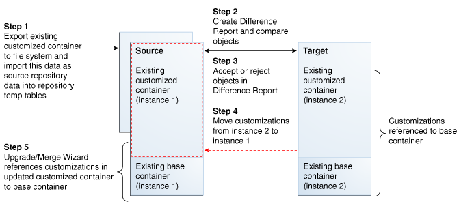

The Peer to Peer Merge option enables you to merge DAC repositories of different instances of the same release. For example, in a development environment you may have two instances of a DAC repository used with Oracle BI Applications release 7.9.5 that you want to merge.
Figure 15-5 shows a high-level process flow for using the Peer to Peer Merge option to merge DAC repositories of different instances of the same release.
In Step 1 of the high-level process flow, you export one instance of the existing customized source system container to the file system and then import this container into the repository temporary tables. This repository is referred to as the source in the Upgrade/Merge Wizard.
In Step 2, you create a Difference Report that compares the instance 1 container (including customizations) with the instance 2 container (including customizations). The instance 2 container is referred to as the target.
In Step 3, you accept or reject the objects that the Difference Report shows as being present or changed in the source but not the target. See Possible Repository Merge Outcomes Based on Your Decisions for a description of how objects are merged based on the action you take.
In Step 4, after you have resolved the differences, you then execute the merge. In Step 5, the Upgrade/Merge Wizard references the customizations in the newly merged container with the instance 1 base container.

The View Difference Report dialog enables you to resolve the differences between the existing and new DAC repositories. To resolve the differences, you either accept or reject the objects that appear in the existing repository but do not appear in the new repository.
Objects in a source system container have an ownership property. The categories of ownership are original, reference, and clone. The ownership property is maintained when an object from the existing repository is merged with the new repository. For example, if an object in the existing source system container is a reference and you want to merge it into the new repository, it will be moved into the new container as a reference. For more information about object ownership properties, see "About Object Ownership in DAC".
Table 15-2 shows the merge outcomes based on object type.
This section describes the main features of the View Difference Report.
Navigation Tree
The navigation tree displays the repository object types that are compared in the existing and new repositories. When you select a repository object in the navigation tree, the differences are listed in the object difference window.
Object Difference Window
The Object Difference window lists the differences found between the existing and new containers for the object type selected in the navigation tree. If the object selected in the navigation tree is a hierarchical object, the subtabs for the child objects appear below the Object Difference window. The following columns appear in the Object Difference window and in the subtabs:
User Key
Unique identifier for the object.
Change Description
Indicates the type of difference that exists between the containers.
Container
The new or target container.
Accept Source
Selecting the Accept Source check box indicates you want to accept the change that appears in the source container. For detailed information about the possible merge outcomes, see "Possible Repository Merge Outcomes Based on Your Decisions".
Resolved
Optional field that indicates the object difference has been resolved. Note: This field is for user reference only. It does not have an affect on the merge process.
Subtabs for Child Objects
If the object selected in the navigation tree is a hierarchical object, the subtabs for the related child objects appear in the bottom pane of the Object Difference window.
Text Fields
The text fields in at the bottom of the dialog, labeled "New Source System Container "and "Existing Source System Container," display a textual and hierarchical representation of the object difference selected in the Object Difference window.
Query Functionality
You can query for objects in the Object Difference window and in the subtabs. For more information about the DAC query functionality, see "Using the DAC Query Functionality".
Difference Type Filter
The drop-down list in the Object Difference window toolbar enables you to filter the list of differences based on the Change Description. The following filter options are available:
All. Displays all changed objects.
Added-Source. Displays objects that were added in the source container.
Added-Target. Displays objects that were added in the target container.
Cloned-Source. Displays objects that were cloned in the source container.
Cloned-Target. Displays objects that were cloned in the target container.
Deleted-Source. Displays objects that were deleted from the source container.
Deleted-Target. Displays objects that were deleted from the target container.
Modified. Displays objects that were modified differently in the source and target containers.
The View Difference Report shows the changes between two containers based on object type.
For more information about object types and their ownership properties, see "About Object Ownership in DAC".
