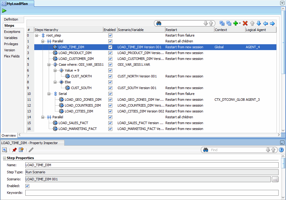

Figure 14-1 shows a sample Load Plan created in Oracle Data Integrator. This sample Load Plan loads a data warehouse:
Dimensions are loaded in parallel. This includes the LOAD_TIME_DIM, LOAD_PRODUCT_DIM, LOAD_CUSTOMER_DIM scenarios, the geographical dimension and depending on the value of the ODI_VAR_SESS1 variable, the CUST_NORTH or CUST_SOUTH scenario.
The geographical dimension consists of a sequence of three scenarios (LOAD_GEO_ZONE_DIM, LOAD_COUNTRIES_DIM, LOAD_CITIES_DIM).
After the dimensions are loaded, the two fact tables are loaded in parallel (LOAD_SALES_FACT and LOAD_MARKETING_FACT scenarios).
The Load Plan Editor provides a single environment for designing Load Plans. Figure 14-2 gives an overview of the Load Plan Editor.
Figure 14-2 Steps Tab of the Load Pan Editor
The Load Plan steps are added, edited and organized in the Steps tab of the Load Plan Editor. The Steps Hierarchy table defines the organization of the steps in the Load Plan. Each row in this table represents a step and displays its main properties.
You can drag components such as packages, integration interfaces, variables, procedures, or scenarios from the Designer Navigator into the Steps Hierarchy table for creating Run Scenario steps for these components.
You can also use the Add Step Wizard or the Quick Step tool to add Run Scenario steps and other types of steps into this Load Plan. See Section 14.2.2.1, "Adding Load Plan Steps" for more information.
The Load Plan Editor toolbar, located on top of the Steps Hierarchy table, provides tools for creating, organizing, and sequencing the steps in the Load Plan. Table 14-2 details the different toolbar components.

Define the Exception and Restart Behavior
Exception and Restart behavior can be set on the steps in the Steps Hierarchy table. See Section 14.2.4, "Handling Load Plan Exceptions and Restartability" for more information.
Regenerate Scenarios
To regenerate all the scenarios of a given Load Plan step, including the scenarios of its child steps:
From the Steps Hierarchy table of the Steps tab or Exceptions tab, select the Load Plan step.
Right-click and select Regenerate. Note that this option is not available for scenarios with the version number -1.
Click OK.

To modify all the scenario steps of a given Load Plan step, including the scenarios of its child steps, and set the scenario version to the latest version available for each scenario:
Right-click and select Refresh Scenarios to Latest Version. Note that this option is not available for scenarios with the version number -1.
Click OK.
To delete a step:
Open the Load Plan Editor and go to the Steps tab.
In the Steps Hierarchy table, select the step to delete.
In the Load Plan Editor toolbar, select Remove Step.
The step and its child steps are removed from the Steps Hierarchy table.
It is not possible to undo a delete operation in the Steps Hierarchy table.To duplicate a step:
In the Steps Hierarchy table, right-click the step to duplicate and select Duplicate Selection.
A copy of this step, including its child steps, is created and added as a sibling step after the original step to the Step Hierarchy table.
You can now move and edit this step.

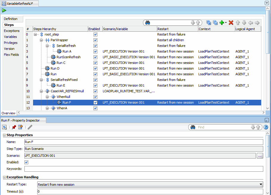

Defining exception handling for a Load Plan step consists of associating an Exception Step to this Load Plan step and defining the exception behavior. Exceptions steps can be set for each step except for When and Else steps.
To define exception handling for a Load Plan step:
In the Steps Hierarchy table, select the step for which you want to define an exception behavior. The Property Inspector displays the Step properties.
In the Exception Handling section of the Property Inspector, set the parameters as follows:
Timeout (s): Enter the maximum time (in seconds) that this step takes before it is aborted by the Load Plan. When a time-out is reached, the step is marked in error and the Exception step (if defined) is executed. In this case, the exception step never times out. If needed, a timeout can be set on a parent step to safe guard such a potential long running situation.
If the step fails before the timeout and an exception step is executed, then the execution time of the step plus the execution time of the exception step should not exceed the timeout, otherwise the exception step will fail when the timeout is reached.
Note that the default value of zero (0) indicates an infinite timeout.
Exception Step: From the list, select the Exception step to execute if this step fails. Note that only Exception steps that have been created and defined on the Exceptions tab of the Load Plan Editor appear in this list. See Section 14.2.4.1, "Defining Exceptions Flows" for more information on how to create an Exception step.
Exception Behavior: Defines how this step behaves in case an exception is encountered. Select one of the following:
Run Exception and Raise: Runs the Exception Step (if any) and raises the exception to the parent step.
Run Exception and Ignore: Runs the Exception Step (if any) and ignores the exception. The parent step is notified of a successful run. Note that if an exception is caused by the exception step itself, the parent step is notified of the failure.

The Restart Type option defines how a step in error restarts when the Load Plan is restarted. You can define the Restart Type parameter in the Exception Handling section of the Properties Inspector.
Depending on the step type, the Restart Type parameter can take the values listed in Table 14-5.
Table 14-5 Restart Type Values
| Step Type | Values and Description |
Serial |
Parallel |
Run Scenario |
The same limitation as those described in Section 20.4, "Restarting a Session" apply to the sessions restarted from a failed step or failed task. |
