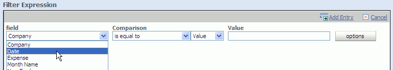

Click Add new entry.
A filter form opens.
Choose a field from the Field list.
Calculated fields created on external data objects are not supported in filters. If a calculated field is created on any field of an external data object, do not use those it in the filter expression.Choose an expression from the Comparison list.
See Appendix B, "Filter Comparison Expressions," for more information about each comparison expression.
Choose Value, Field, or Formula from the next list.

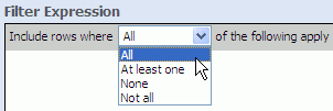

Add combinations of entries and header to create complex filters. Select a different operator for headers to change the entry meanings.
For the following options, data is returned when:
All: All of the included the entries are true.
At least one: At least one and maybe more of the included entries are true.
None: None of the included entries are true.
Not all: Some or none of the included entries are true, but not all of the included entries are true.
