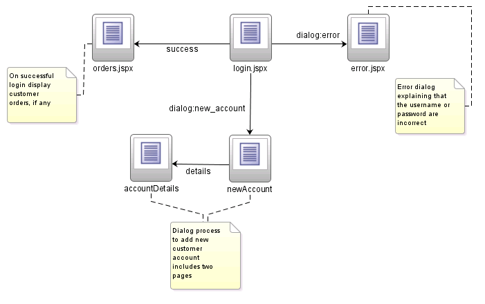

You can use the ADF Faces dialog framework to create modal and modeless dialogs in an application that does not use the ADF Controller and task flows. The dialog framework enables you to display a page or series of pages in a new browser window instead of displaying it in the same window (using the same view ID) as the current page. There may also be cases where you want to use a series of inline dialogs, that is, dialogs that are part of the parent page, but that have a flow of their own, but that do not use a separate view ID. This is important for applications that do not support popups such as, for example, applications that run on client devices or that use the Active Data Service described in Chapter 42, "Using the Active Data Service." Ordinarily, you would need to use JavaScript to open the dialog and manage the process. With the dialog framework, ADF Faces has made it easy to open a new browser window as well as manage dialogs and processes without using JavaScript.
If your application uses the Fusion technology stack with the ADF Controller, then you should use task flows to create dialogs launched in a separate window, or multiple dialog processes. For more information, see Section 19.2, "Running a Bounded Task Flow in a Modal Dialog".Consider a simple application that requires users to log in to see their orders. Figure 19-2 shows the page flow for the application, which consists of five pages - login.jspx, orders.jspx, new_account.jspx, account_details.jspx, and error.jspx.
When an existing user logs in successfully, the application displays the Orders page, which shows the user's orders, if any. When a user does not log in successfully, the Error page displays in a separate popup dialog window, as shown in Figure 19-3.
On the Error page there is a Cancel button. When the user clicks Cancel, the popup dialog closes and the application returns to the Login page and the original flow, as shown in Figure 19-4.
When a new user clicks the New User link on the Login page, the New Account page displays in a popup dialog in a new window, as shown in Figure 19-5.
After entering information such as first name and last name, the user then clicks the Details button to display the Account Details page in the same popup dialog, as shown in Figure 19-6. In the Account Details page, the user enters other information and confirms a password for the new login account. There are two buttons on the Account Details page - Cancel and Done.
If the new user decides not to proceed with creating a new login account and clicks Cancel, the popup dialog closes and the application returns to the Login page. If the new user clicks Done, the popup dialog closes and the application returns to the Login page where the Username field is now populated with the user's first name, as shown in Figure 19-7. The new user can then proceed to enter the new password and log in successfully.
The dialog framework should not be used to have more than one dialog open at a time, or to launch dialogs that have a life span outside of the life span of the base page.To make it easy to support dialog page flows in your applications, ADF Faces has built in the dialog functionality to action components (such as commandMenuItem and commandButton). For ADF Faces to know whether or not to open a page in a new flow from an action component, the following conditions must exist:
There must be a JSF navigation rule with an outcome that begins with dialog:.
The command component's action outcome must begin with dialog:.
The useWindow attribute on the command component must be true.
If theuseWindow attribute is false, or if you configure the popup to be a separate window (and not inline) and the client device does not support popups, ADF Faces automatically shows the page in the current window instead of using a popup window; code changes are not required to facilitate this action.The page that is displayed in a dialog is an ordinary JSF page, but for purposes of explaining how to implement external dialogs in this chapter, a page that is displayed in a popup dialog is called the dialog page, and a page from which the dialog is opened is called the originating page. A dialog process starts when the originating page opens a dialog (which can contain one dialog page or a series of dialog pages), and ends when the user dismisses the dialog and returns to the originating page.

<af:commandLink id="cmdLink" text="New User?"
action="dialog:newAccount"
useWindow="true" partialSubmit="true"
launchListener="#{backing_login.handleLaunch}"
returnListener="#{backing_login.handleReturn}"
windowHeight="200" windowWidth="500" />
On the resulting page, use the pageFlowScope object to retrieve the key and value via a special EL expression in the format #{pageFlowScope.someKey}, as shown in Example 19-5
