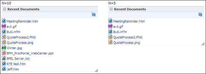

To avoid a slow and jerky response when scrolling large data sets in your task flow, you must limit the number of records to be fetched from the data source at a time. For example, if you have included an ADF faces Table component inside your task flow, limit the number of records to be displayed in the table. Use the fetchSize attribute on the Table to specify the number of records to be fetched from the data source in a single query. If you specify a fetch size of N, only N records are sent to the client from the data source.
The fetchSize and autoHeightRows attributes together control the number of rows displayed in the table. The relationship between these attributes is as follows:
If fetchSize equals autoHeightRows, all records are displayed in the table.
If fetchSize is less than autoHeightRows, the table is cropped at the fetchSize value.
If fetchSize is greater than autoHeightRows, you can decide whether to display only as many records as the autoHeightRows value or provide pagination controls to display the remaining records. For example, you might include a More link at the bottom of the task flow or include pagination using Previous and Next links. For more information, see Section D.3, "Example of a WebCenter Application Containing a Task Flow Created By Following the Guidelines."
Figure D-2 shows the difference between two task flows containing tables with equal autoHeightRows and fetchSize values of 10 and 5. The task flows wrap to the number of records displayed.
Instead of specifying a fixed value for fetchSize, you can provide an EL value so that the attribute is populated based on some logic you specify. You can enable customization and personalization on the task flow and provide an option for users to specify a value for this attribute. A value specified using the personalization option overrides a value specified using the customization option.
The following example shows the attributes of a sample ADF Faces Table component that is included inside a task flow called recent-pages-task-flow-definition. The fetchSize attribute is set to an EL expression that references a Java bean, recentPagesBean. This bean contains the logic to populate this attribute with a customization value provided by the end user.

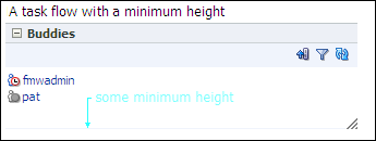

You can ensure that the task flow wraps to the height of the content by adhering to the first guideline, described in Section D.1.1, "Guideline 1: Create Task Flows that Flow."
To prevent the task flow from collapsing completely when there are no records, or seeming too short when there are only one or two records, specify a minimum height for the content.
For example, if your task flow contains a table with an autoHeightRows value specified, you can specify a min-height value using the table's inlineStyle attribute.
Figure D-3 shows a task flow displayed with a reasonable height even though it has only two rows.

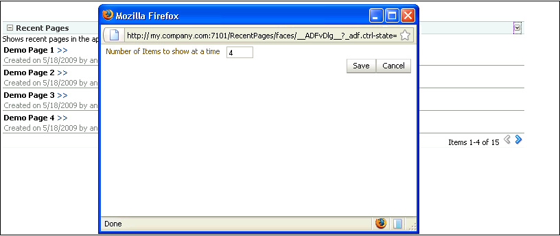

While creating a task flow, you can create parameters and provide options for users to customize and personalize the task flow. You can enable privileged users to customize the task flow for all users (customization) and edit the task flow's properties and parameters in Oracle Composer. You can enable all users viewing the page to customize their view of the page (personalization). This section provides guidelines for implementing task flow parameters and the customization and personalization options.
Table D-1 provides an overview of the various task flow editing options available to users.
Table D-1 Options Used to Define Task Flow Appearance and Behavior
| Option | Description | When to Use | Who can See It |
Parameters |
A small set of ideally scalar values, used to program a task flow or set its context.Each parameter must have a good display name and description (which must include possible values and examples). |
Use for a context like the city or pin code so that you can add multiple instances of the task flow, each showing different information or programmed to show information based on receiving a value from the page, programmatically or using the URL. In WebCenter Spaces, you can use a parameter for a context like group space name. Precedence: 3 This value overrides built-in values in the task flow. |
Power users (or users with Edit or Customize permission) can see parameters in Oracle Composer's Component Properties dialog while editing a page. In WebCenter Spaces, moderators can see and edit task flow parameters. When a WebCenter task flow is exposed as a portlet in Oracle Portal, page designers can see these parameters while setting up the portlet. |
Customization/Preferences |
These two are synonymous.Customizations are typically considered changes a business user makes to the task flow. These changes are available to all viewers of the page and are used to specify values for options defined in the task flow. For example, users can decide whether to display the author name or revision date for a document. Preferences are referred to as a definition of the content in the task. For example, a query definition in the Document Viewer task flow, or a query in OmniPortlet. |
Use these when the task flow must provide a user interface that assists the user in defining the task flow behavior. That is, when Lists of Values or specific UI components such as images or radio buttons guide the user better, or when the task flow setup is a multiple step wizard-style interface. Such assistance cannot be provided through parameters because they are strictly scalar values, with no assistance other than a description. Precedence: 2 If there is an identical parameter value (for example, group space name), customization overrides that value. |
Business users (or users with Edit or Customize permission) editing a page in Oracle Composer can see the customization or preferences options. Typically, customization or preferences options are available on the chrome surrounding the task flow in Edit mode. However, users with Edit or Customize permission can also see these options on the chrome in View mode of the page. When a WebCenter task flow is exposed as a portlet in Oracle Portal, the page designer sees these as Edit Defaults options while setting up the portlet. |
Personalization |
A subset of the customization and preferences options. You cannot have personalization options that are not also customization options. |
Use these to allow all viewers of the page to tweak and tune the visual aspects of the task flow or the amount of data shown to them. For example, to set the number of items to display. Precedence: 1 If there is an identical customization value (for example, number of items), personalization overrides that value. |
All end users with View permission can see these options. Personalization options are available on the chrome surrounding the task flow. When WebCenter task flows are exposed as portlets in Oracle Portal, the Personalization options allow end users to tweak the same visual aspects. |
Implicit Personalization |
Options that are persisted for end users from session to session. Implicit personalization options are not available on the chrome surrounding the task flow, but are actions that can be performed directly in the body of the task flow. For example, sorting and column resizing are implicit personalization options. |
Use these options sparingly and only for options that are frequently changing. Options like column resizing and sorting are available for free from Oracle ADF. |
All end users with View permission on the page can perform personalizations. |

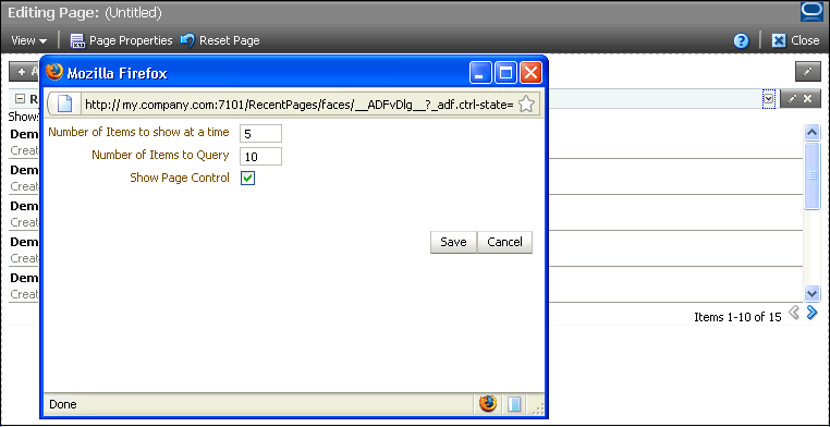

Users with Edit or Customize permission can access customization options from the chrome surrounding the task flow.
You must adhere to the following guidelines while implementing customization in your task flow:
Customization options must be a subset of the task flow's parameters.
Implement a view fragment within the task flow and expose an outcome to open this view in a separate dialog. For example, the control flow rule to invoke a view called advancedEditPopupView in a dialog is as follows:
<control-flow-case> <from-outcome>dialog:advancedEditPopup</from-outcome> <to-activity-id>advancedEditPopupView</to-activity-id> </control-flow-case>
Adhering to this guideline is mandatory for new task flows.
Implement a view fragment within the task flow and expose an outcome to transition inline to this view. For example, the control flow rule to invoke a view called advancedEditView within the same screen is as follows:
<control-flow-case> <from-outcome>advancedEdit</from-outcome> <to-activity-id>advancedEditView</to-activity-id> </control-flow-case>
Although you can implement a task flow in this way, it is recommended that you expose an outcome to open the view in a dialog.
Ensure that customizations are saved in the MDS level set up by the application. Unlike task flow parameters, which are stored in the task flow definition itself, customizations are saved in the Metadata Storage (MDS). If you do not explicitly specify the MDS layer to be used to save task flow customizations, customization metadata and the consuming application metadata may get stored in different layers.
To ensure that customizations are saved to the same layer as application metadata, you must clone the application's MDS session in the task flow's preference file and reference that while configuring customization. For an example of how this is implemented, see Section D.3, "Example of a WebCenter Application Containing a Task Flow Created By Following the Guidelines."

Figure D-6 displays an option to select the number of items to be displayed in the task flow. All users viewing the page can personalize the task flow using this option. The value specified by a user is applicable only for that user's view of the page.
The following table describes significant sections of code in the simpleEditPopupView.jspx page.
Table D-4 Code in the Personalization Page
| Code | Description |
<af:panelStretchLayout id="psl1">
<f:facet name="center">
<af:group id="group1">
<af:panelFormLayout id="pfl1">
<af:inputText label="Number of Items to show at a time"
id="it1"
value="#{pageFlowScope.recentPagesBean.number_of_items_to_show_at_a_time}"
columns="3"/>
</af:panelFormLayout>
<af:panelGroupLayout id="pgl2"
layout="horizontal"
halign="right"
inlineStyle="width:500px;">
<af:commandButton text="Save" id="cb1"
action="#{pageFlowScope.recentPagesBean.saveSettings}"/>
<af:commandButton text="Cancel" id="cb2"
action="cancel"
actionListener="#{pageFlowScope.recentPagesBean.cancel}"/>
</af:panelGroupLayout>
</af:group>
</f:facet>
</af:panelStretchLayout>
A single top-level The The |
This page displays customization options to users with Edit or Customize permission. At runtime, this page opens in a separate dialog and displays options to select the number of items to be displayed and number of items to be queried, and a check box to show or hide pagination controls.
The following table describes significant sections of code in the advancedPopupView.jspx page.
Table D-5 Code in the Customization Page
id="it1"
columns="3"/>
<af:inputText label="Number of Items to Query" id="it2"
value="#{pageFlowScope.recentPagesBean.number_of_items_to_query}"
columns="3"/>
<af:selectBooleanCheckbox label="Show Page Control"
id="sbc1"
value="#{pageFlowScope.recentPagesBean.showPageControl}"/>
layout="horizontal"
halign="right"
action="cancel"
</af:group>
</f:facet>

At runtime, the page appears as shown in Figure D-7.
You can add a task flow inside a Show Detail Frame component and display the task flow's outcomes as actions on the chrome of the parent Show Detail Frame component. This is possible by defining custom actions on the parent Show Detail Frame component. You can define custom actions at the instance level where Custom Action components are added as child components of the Show Detail Frame, or at the global level where Custom Action elements are defined in the application's adf-config.xml file. Global custom actions are enabled on all Show Detail Frame instances in the application, but are displayed only when a Show Detail Frame instance contains the task flow as its child.
In this application, custom actions corresponding to the task flow's outcomes, dialog:simpleEditPopupView and dialog:advancedEditPopupView, are defined globally in the adf-config.xml file as follows:
<customizableComponentsSecurity xmlns="http://xmlns.oracle.com/adf/faces/customizable/config">
<enableSecurity value="true"/>
<customActions>
<customAction action="refresh" text="Refresh"
shortDesc="Refresh"
location="menu" rendered="true"
icon="/adf/pe/images/refresh_ena.png"/>
<customAction action="dialog:simpleEditPoup"
text="Simple Edit"
shortDesc="Simple Edit"
location="menu"
rendered="#{!changeModeBean.inEditMode}"
icon="/adf/pe/images/editproperties_ena.png"/>
<customAction action="dialog:advancedEditPopup"
text="Advanced Edit"
shortDesc="Advanced Edit" location="menu"
rendered="#{changeModeBean.inEditMode}"
</customActions>
</customizableComponentsSecurity>
This configuration results in the following behavior at runtime:
All users see a Simple Edit action on the chrome surrounding the task flow while viewing the page.
Clicking this action displays the personalization option in a separate dialog.
Users with Edit or Customize permission see an Advanced Edit action on the chrome surrounding the task flow while editing the page.
Clicking this action displays customization options in a separate dialog.
