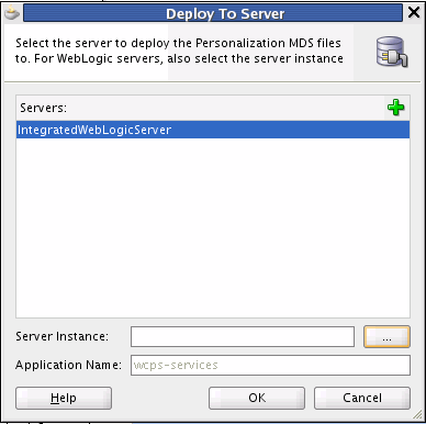

Section 9.12, "Building and Deploying WebCenter Personalization Service Files"

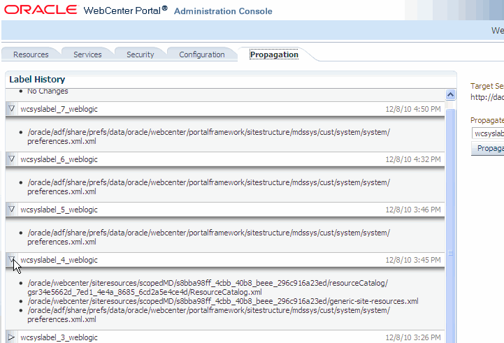

Section 9.13, "Using the Propagation Tool to Propagate From Staging to Production"

If you are using the WebCenter Personalization Server to provide personalization features for your portal, you must perform a manual update to the build.xml file. For details, see Section 9.12.1, "Building the WCPS MAR File."

WebCenter provides a Propagation tool that is built in to the WebCenter Portal Administration Console. The Propagation tool is for moving your application from the staging environment to the production environment. See Section 9.13, "Using the Propagation Tool to Propagate From Staging to Production."

The propagation tool, described in Section 9.13, "Using the Propagation Tool to Propagate From Staging to Production," is primarily used by site administrators to push approved site structure changes to production without incurring any downtime.Tip:
The build and deploy script isolates the information that is variable between environments, like the server names, ports, content management connections, database connections, and so on. Most aspects of the WebCenter Portal application do not need to change when you redeploy it to another server. For example, the name of the application doesn't change.The deploy and configure script described in this section is primarily used when the production application is mostly read only and live. In this scenario, content contributors make active changes to the staged application and receive content approval before that content is moved to production. Oracle recommends that you use automatic content replication so that content is moved from stage to production after appropriate workflow approvals. See Section 9.14, "Propagating UCM Content."
Security changes are not affected by the deploy and configure scripts. To push site structure changes to production, administrators can use the propagation tool, as described in Section 9.13, "Using the Propagation Tool to Propagate From Staging to Production." See also Section 9.15, "Managing Security Through the Life Cycle."

In JDeveloper, open your portal project. If you want to use WLST commands to perform this deployment, see Section 9.12.4, "Importing and Exporting MAR Files."
From the Application menu, select Deploy Personalization Files and then select To Server.
In the Deploy to Server dialog, select the server to which you want to deploy the service. See Figure 9-3.
Optionally, click the Add button to add a server to the list.Click the "..." button to select a specific server instance. For example, the running DefaultServer.
Click OK when you are finished.
Check, the Message - Log window for details on the deployment. The log will indicate if the deployment of the metadata files was completed successfully.

When properly configured, the Propagation tool shows up as a tab in the WebCenter Portal Administration Console, as shown in Figure 9-4.
The Label History part of the Propagation tab lists the labels that were created for each propagation, labels created outside of the Propagation tab, such as labels created during deployment and labels created using WLST. Each label includes a list of files that change since the last propagation was performed. To view the contents of a label, click the arrow button to the left of the label name, as shown in Figure 9-5.
Figure 9-5 The Propagation Tab with Labels Opened
