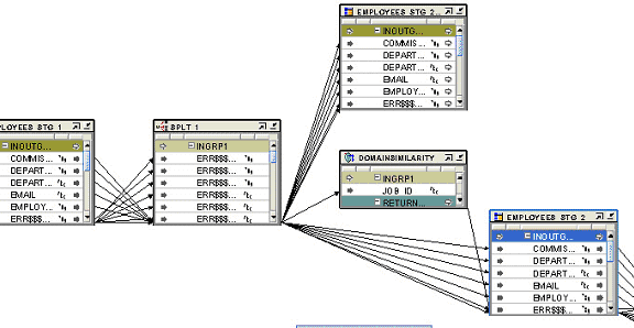

Figure 21-1 displays a correction map generated by the Create Correction Wizard.

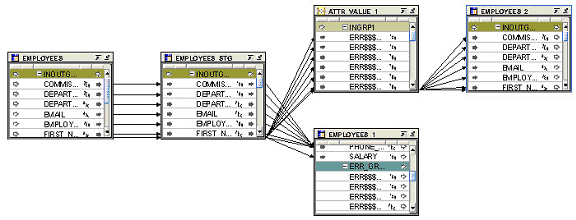

Select the submapping ATTR_VALUE_1 and click Visit Child Graph on the toolbar to view the submapping.
Figure 21-2 displays the submapping that is displayed.
The submapping is the element in the mapping that performs the actual correction cleansing that you specified in the Create Correction Wizard. In the middle of this submap is the DOMAINSIMILARITY transformation that was generated as a function by the Create Correction Wizard.
