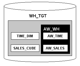

The examples used to explain these OLAP transformations are based on the scenario depicted in Figure 28-1.
Figure 28-1 Example of OLAP Transformations
Description of Figure 28-1 follows
Description of "Figure 28-1 Example of OLAP Transformations"
The relational dimension TIME_DIM and the relational cube SALES_CUBE are stored in the schema WH_TGT. The analytic workspace AW_WH, into which the dimension and cube are loaded, is also created in the WH_TGT schema.
