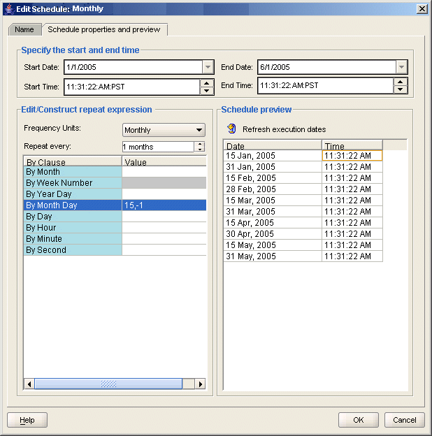

Use the Schedule Editor to edit schedules.
Figure 11-1 shows the Schedule Editor with the Start and End Dates and Times at the top of the editor.
The repeat expression appears in the lower-left panel of the editor. Use the repeat expression to specify the Frequency Unit, Repeat Every, and one or more By Clauses.
The schedule preview appears in the lower-right panel. The preview refreshes each time you press the Enter key or navigate to a new cell on the Schedule Editor. If you specify an invalid schedule, then the preview displays an error message.
For examples of schedules that you can define, see Example Schedules.

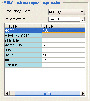

By Clauses
By Clauses enable you to define repeat expressions for complex schedules, such as a schedule to run the first Friday of any month that contains 5 weeks. For each clause, you can either enter values or click the Ellipsis button to view a selector dialog box. If your goal is to know how to quickly type in values, then first use the selector dialog box to learn what values are valid, and then see "Example Schedules".
Figure 11-2 displays the selector dialog box to pick months in a year.
Figure 11-2 Selector dialog box for Picking Months in a Year
This illustration is described in the surrounding text.
Description of "Figure 11-2 Selector dialog box for Picking Months in a Year"
When you use the selector dialog box and click OK, the results are displayed in the Schedule Editor. In this way, you can use the selector dialog box to learn what values are valid.
Figure 11-3 displays the Schedule Editor with the results.
Figure 11-3 Month Clause for January and June
Description of "Figure 11-3 Month Clause for January and June"

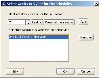

By Week Number
Only when you select Yearly for the Frequency Unit can you schedule by the week number in the year.
You can either type in values or click the Ellipsis button to view the selector dialog box. If you type in values, then valid values include positive and negative integers from 1 to 52 or 53, depending on the year. For example, to set a schedule to run on the second to last week of the year, you can either type -2 or fill in the selector dialog box.
Figure 11-4 displays the Selector dialog box with the schedule that runs on the second to last week of every year.
Figure 11-4 By Week Number Clause Set to Second To Last Week of the Year
Description of "Figure 11-4 By Week Number Clause Set to Second To Last Week of the Year"
The By Week Number clause follows the ISO-8601 standard, which defines the week as starting with Monday and ending with Sunday. Also, the first week of a year is defined as the week containing the first Thursday of the Gregorian year and containing January 4th.
Using this standard, a calendar year can have 52 or 53 weeks. Part of week 1 may be in the previous calendar year. Part of week 52 may be in the following calendar year. If a year has a week 53, then part of it must be in the following calendar year.
As an example, in the year 1998, week 1 began on Monday, December 29th, 1997. The last week, week 53, ended on Sunday, January 3rd, 1999. Therefore, December 29th, 1997, is in the first week of 1998 and January 1st, 1999, is in the 53rd week of 1998.
