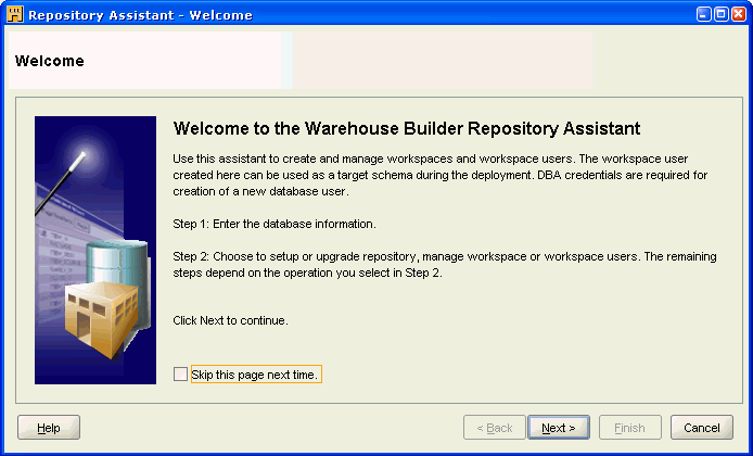

Start the repository assistant.
C:\> ./reposinst.sh

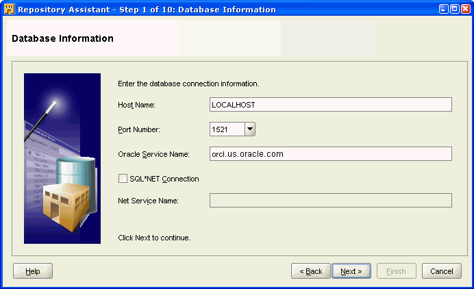

On the Welcome screen of the Repository assistant, click Next.
On the Database Information screen, enter the connection information (Host Name, Port Number, and Oracle Service Name) for the repository database, and click Next.

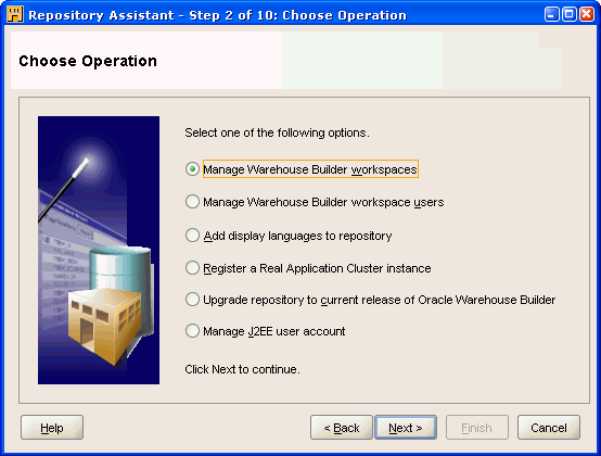

On the Choose Operation screen, select Manage Warehouse Builder workspaces. Click Next.

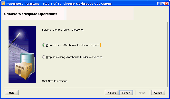

On the Choose Workspace Operations screen, select Create a New Warehouse Builder workspace. Click Next.

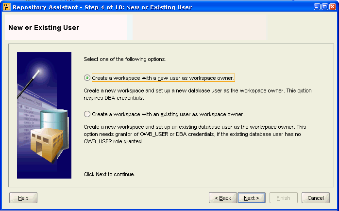

On the New or Existing User screen, select Create a workspace with a new workspace owner. Click Next.

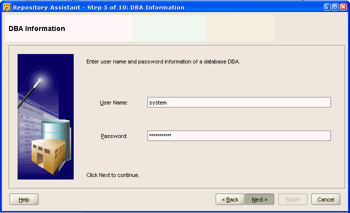

On the DBA Information screen, enter the User Name of a user with a CREATE USER privilege, and that user's Password.
Click Next.

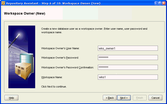

In the Workspace Owner (New) screen, enter the following information:
Workspace Owner's User Name (wks_owner1)
Workspace Owner's Password
Workspace Owner's Password Confirmation
Workspace Name (wks1) (Workspace names cannot contain spaces)
Click Next.

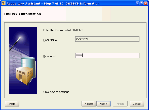

In the OWBSYS Information screen, enter the OWBSYS Password. Click Next.
You need these credentials to seed the OWBSYS schema.

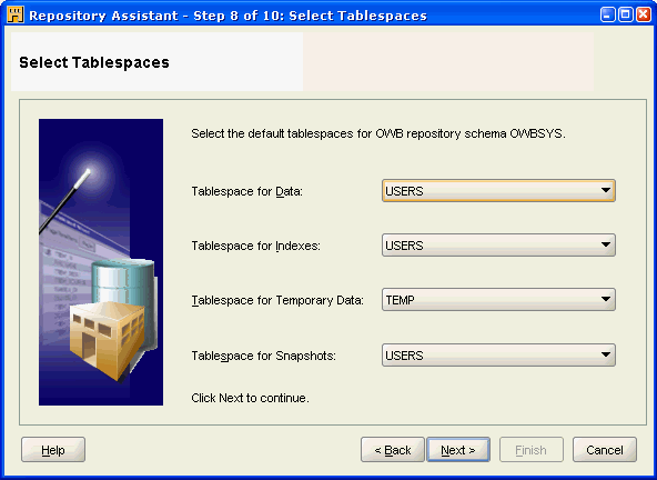

On the Select Tablespaces screen, enter the following information:
Tablespace for Data (USERS, or the name of the desired tablespace)
Tablespace for Indexes (USERS, or the name of the same tablespace)
Tablespace for Temporary Data (TEMP)
Tablespace for Snapshots (USERS, or the name of the same tablespace)
Click Next.
This step enables you to change the default tablespace details. Oracle Warehouse Builder repository is stored in the OWBSYS schema, but you must identify what tablespaces are used to store OWBSYS and certain other objects, like snapshots. You may choose tablespaces other than USERS, depending on your storage management strategy.

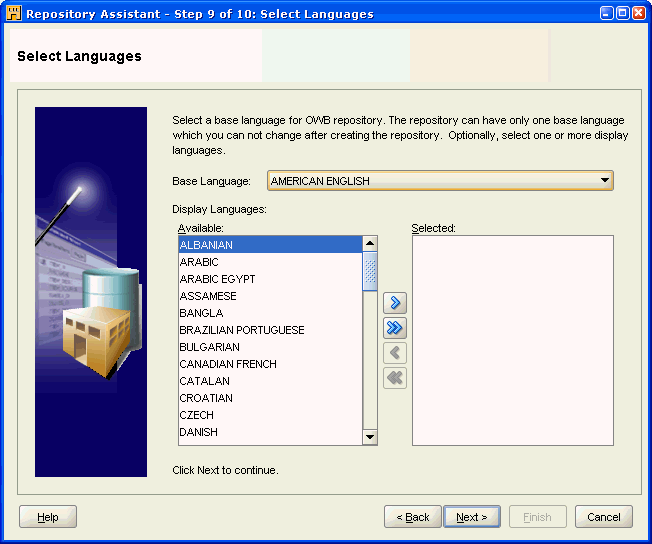

On the Select Languages screen, select the Base Language from the menu.
[Optional] You may also select additional Display Languages from the list of Available languages on the left side, and move them to the list of Selected languages on the right side.
Click Next.

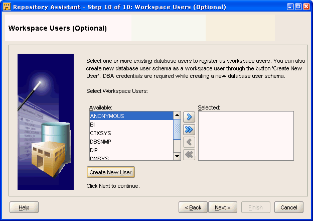

On the Workspace Users (Optional) screen, select the appropriate existing users from the Available list add them to the Selected list.
[Optional] Click Create New User to make new users who can access Oracle Warehouse Builder. This takes you to step 15.
Click Next. This takes you to step 17.

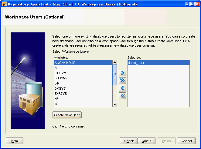

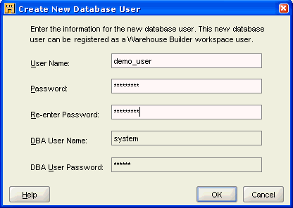

[Optional] In the Create New Database User screen, enter the following:
User Name (demo_user)
Password
Re-enter Password
Click OK.
DBA User Name (system) and DBA User Password are disabled fields and cannot be edited.
In the Workspace Users (Optional) screen, click Next.

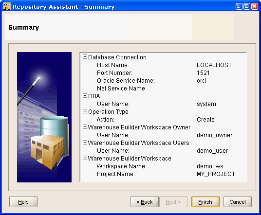

On the Summary screen, click Finish.
Once the Installation Result screen appears, click OK.
