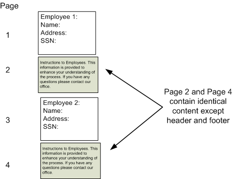

If the report contains static content and the placement of that content in the report is also fixed (for example, a set of instructions on the back of a Federal W-2 form), then you can use this feature of BI Publisher to reduce the size of the generated PDF file.
Using the W-2 form as an example, the report has the expected output shown in Figure A-1.
For each employee, specific content is rendered, but the back (or second) page of each contains an identical set of instructions.
This set of instructions can be defined as reusable static content. When content is identified as reusable static content, BI Publisher includes the static content in the generated PDF document only once and references it in other places when needed, thereby reducing the overall output file size.

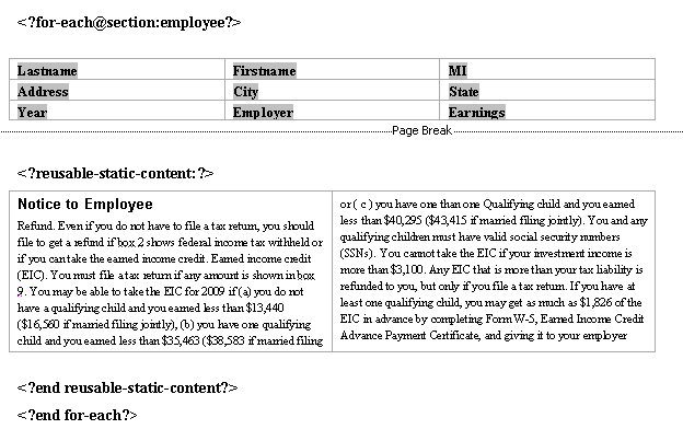

To define the static content to be reused, use the following tags around the content in the template as follows:
<?reusable-static-content:?>
…. static content here …
<?end reusable-static-content?>
Inserting these tags around the static content signals BI Publisher to include this content only once in the generated file and then reference it in the same position for each occurrence.
The following example illustrates an implementation of this feature. The sample report generates one occurrence per employee. The generated report has employee-specific information on the front page of each occurrence, and static instructions that print on the back of each occurrence. A section break occurs after each employee to reset page numbering.

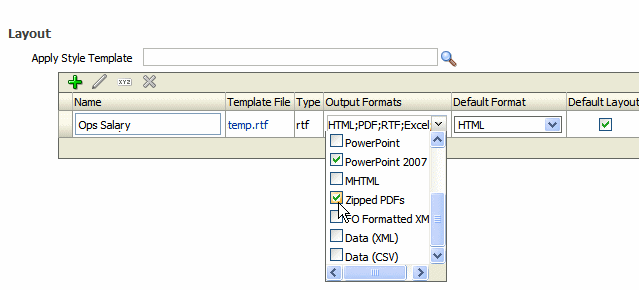

After uploading the template to the report definition, enable Zipped PDFs as an output type, as shown in Figure A-3.
Figure A-3 Enabling Zipped PDFs as an Output Type

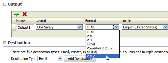

When scheduling the report, select PDFZ as the output type, as shown in Figure A-4.
Figure A-4 Selecting PDFZ as the Output Type
