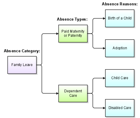

An absence category (such as family leave) contains a set of related absence types, such as paid maternity and dependent care. Additionally, an absence type (such as paid maternity or paternity) can contain reasons, such as the birth of a child and adoption.
The following graphic shows examples of absence types, categories, and reasons and how they are related:
You can extend the list of predefined categories using the ABSENCE_CATEGORY lookup type. Some absence categories may be predefined for your legislation.
