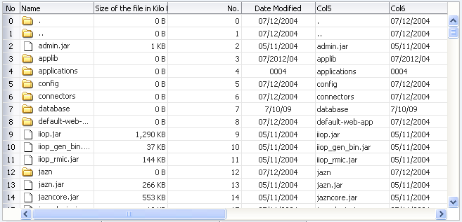

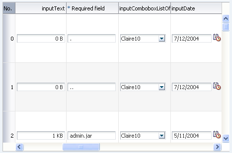

Table is used to display tabular data. It also supports row/column selection (both single and multiple), sorting, record navigation. Table is not meant for use as a layout component of disparate information. For more information about this, see the Accessibility Guidelines section.
The Table component uses a model to access the data in the underlying list. The specific model class is oracle.adf.view.rich.model.CollectionModel
. You may also use other model instances, e.g., java.util.List
, array, and javax.faces.model.DataModel
. The Table will automatically convert the instance into a CollectionModel.
The immediate children of a Table component must all be <af:column>
components. Each visibleColumn component creates a separate column in the Table. Because of this stamping behavior, some components may not work inside the column. Most components will work without problems, for example any input and output components. If you need to use multiple components inside a cell, you can wrap them inside a panelGroupLayout component. Components that themselves support stamping are not supported, such as tables within a table. For more information see the documentation for <column>
