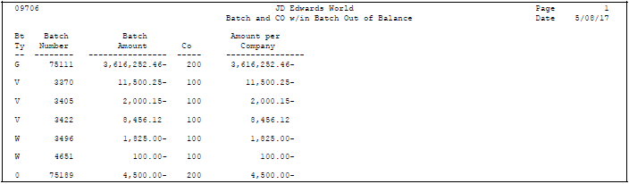

The Company by Batch Out of Balance report uses only posted information in the Account Ledger table (F0911). This is an exception report. If there are no discrepancies, the report is blank.
This is a DREAM Writer report.
For accuracy, run the Company by Batch Out-of-Balance report when users are not accessing the JD Edwards World system.
Figure 10-1 Batch and CO w/in Batch Out of Balance report
| Topic | Description |
| Abbreviated column heading | The report contains the following abbreviated column heading:
| Batch Amount column heading | This heading represents the amount by which the batch is out-of-balance. |
| Amount per Company column heading | This heading represents the amount by which each company in the batch is out-of-balance. |
