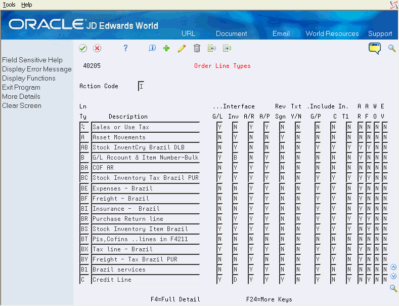

From Sales Order Management (G42), choose hidden selection 29
From Sales Order Management Setup (G4241), choose Order Line Types
You can specify how the system uses line types in the general ledger and with the Inventory Management system. For example, when you purchase or sell an inventory item, you might assign a line type for stock items. The system records the transaction according to the information that you specified for the line type. In this case, the system reflects the cost or price of the item in the general ledger. The transaction line also affects item availability in the Inventory Management system.
The line types that you define are applicable throughout distribution systems. For example, the system processes line types in the same way for the Sales Order Management system as it (the system) processes for the Purchase Management system.
Complete the following fields:
Line Type
Description
General Ledger Interface
Inventory Interface
Reverse Sign
Text
Include Sales/COGS for Gross Profit
Include in Cash Discount Calculation
Include in Tax 1
Apply Retainage
Apply Freight
Generate Work Order

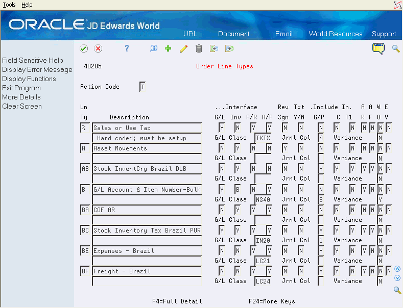

Access the detail area.
Figure 50-2 Order Line Types (Detail) screen
Complete one or more of the following fields:
General Ledger class
Journal Column
Variance

| G/L Class | A user defined code that identifies the G/L offset that you want the system to use when it searches for the account to which it will post the transaction. If you do not want to specify a class code, you can enter **** (four asterisks) in this field.
The table of Automatic Accounting Instructions (AAIs) allows you to predefine classes of automatic offset accounts for the Inventory, Purchasing, and Sales Order Management systems. The system can generate accounting entries based upon a single transaction. As an example, a single sale of a stock item can trigger the generation of accounting entries similar to these: Sales-Stock (Debit) xxxxx.xx A/R Stock Sales (Credit) xxxxx.xx Stock Inventory (Debit) xxxxx.xx Stock COGS (Credit) xxxxx.xx When using a stocking type with an Inventory Interface flag set to N, the system looks for the G/L class in the fold of the line type. |
| Jrnl Col | The Sales Journal report has four columns. The value in this field controls which of the four columns receives the sales value, if any, of this line. Allowed codes are 1, 2, 3, and 4. |
| Variance | Code that tells the system to which account it should book a variance. Valid codes are:
Y – Tells the system that a variance generated during voucher match should be booked to the variance account. N – Indicates to the system that it should book any variance back to the expense account for the order line. Note: This field is used in conjunction with an inventory interface of A or B in the Purchasing system only. |
