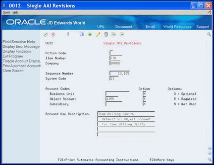

FTD AAI
The system uses the FTD AAI to determine what account to debit when you bill equipment time to a job. You enter the business unit (job) and subsidiary (cost code) on the Time Entry screen. If you choose to enter an object account on the Time Entry screen, it overrides the object account that you set up for this AAI.
When you set up FTD AAIs, you must apply the following rules:
  • Set up the FTD AAI for company 00000. In addition, you can set it up for specific companies.
  • Specify the object account number for the FTD AAI. The system does not use the business unit and subsidiary.

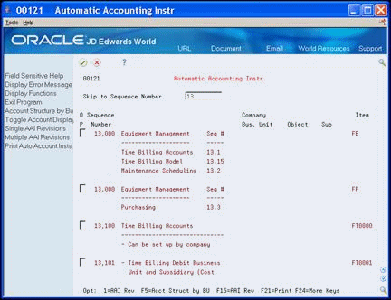

The Automatic Accounting Instructions screen shows an index, or list, of the AAIs in the JD Edwards World systems.
You can use the Page Up and Page Down icons to move through the screens and view all the AAIs, or you can skip to a specific AAI by entering its sequence number in the Skip to Sequence Number field.
Examples-Automatic Accounting Instructions Screens
The following graphics show examples of the various Automatic Accounting Instructions screens that you use when you set up or review AAIs:
Figure 33-1 Automatic Accounting Instructions
Description of Figure 33-1 follows
Description of "Figure 33-1 Automatic Accounting Instructions"
The sequence number does not serve a programming function. The system uses it determine where an AAI appears in the list. For example, 13.000, 13.100, 13.101. Programs are set up to search for a specific AAI item. The item is the hard-coded name of the AAI and you can not make changes to this. For example, FE, FF, FT0000, and FT0001.

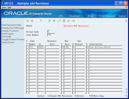

You access AAI entry screens to make either single or multiple AAI revisions. Use the Single AAI Revisions screen to revise any AAI for a particular company. Use the Multiple AAI Revisions screen to revise or add more than one AAI for a company or specific AAIs for multiple companies.
Figure 33-2 Single AAI Revisions screen

Figure 33-3 Muliple AAI Revisions screen
