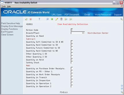

From Inventory Management (G41), enter 29 From Inventory System Setup (G4141), choose Branch/Plant Constants
The system uses the quantities defined for each branch in the Inventory Management system to calculate availability. Therefore, you indicate the quantities you want the system to add or subtract from the on-hand balance when the system calculates availability at that branch. If you leave any field blank, the system excludes that quantity from the calculation.
To define availability calculations for a branch/plant
On Branch/Plant Constants
Figure 14-1 Item Availability Defnition screen
On Item Availability Definition, review the following default information:
Branch/Plant
To subtract a quantity, complete the following optional fields:
Quantity Soft Committed to SO & WO
Quantity Hard Committed to SO
Quantity Future Committed to SO
Quantity Hard Committed to WO
Other Quantity 1 SO
Other Quantity 2 SO
Quantity on Hold
Safety Stock
To add a quantity, complete the following optional fields:
Quantity on Purchase Order Receipts
Quantity on PO - Other 1
Quantity on Work Order Receipts
Quantity in Transit
Quantity in Inspection
Quantity in Operation 1
Quantity in Operation 2

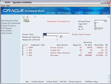

To review ingredient availability
From Shop Floor Management (G31), choose Daily Order Preparation under Process
From Daily Order Preparation - Process (G3113), choose Ingredient Availability
Figure 14-2 Ingredient Availability screen
Complete the following fields:
Branch/Plant
Process
Complete the following optional field:
Requested Quantity
| Field | Explanation |
| Requested Quantity | The number of parent items you want to process. The system calculates lower-level values in quantity per the number of parent items requested. For example, if 3 components are needed for a parent item, and the requested quantity is 10, the system plans for 30 components. |
| Required | The number of units to which the system applies the transaction.
Form-specific information For Shop Floor Control: The quantity of the component required. |

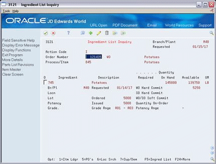

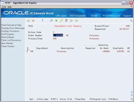

To review ingredients list availability
You can review the availability of ingredients required to complete the quantity of the product indicated on a work order.
If you created a soft commitment for the ingredient, the quantities displayed indicate the ingredient's availability at all locations. If you created a hard commitment for the ingredient, only quantities from the hard-committed locations display. You can also display the quantities of each ingredient that have hard and soft commitments to work orders and sales orders.
From Daily Order Preparation - Process (G3113), choose Ingredient List Inquiry
Figure 14-3 Ingredient List Inquiry screen
Figure 14-4 Ingredient List Inquiry screen
| Required | The total quantity requested. |
| WO Hard Commit | The number of units hard committed to work orders in the primary unit of measure. |
| SO Hard Commit | The number of units committed to a specific location and lot. |
| WO/SO Soft Commit | The number of units that are soft-committed to sales orders or work orders in the primary units of measure. |
| Quantity On-Order | The number of units specified on the purchase order, in primary units of measure. |

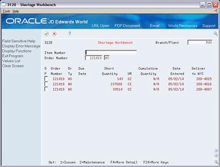

You can locate shortage information for an ingredient that is associated with one or more work orders using the shortage workbench. Use the workbench to determine the amount of a shortage and how the shortage will be filled. You can locate ingredient shortages by:
Branch/plant and ingredient
By branch/plant, ingredient, order number, and order type
By order number and order type
Order type
From Daily Order Preparation - Process (G3113), choose Shortage Workbench
Branch/Plant
Ingredient

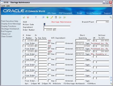

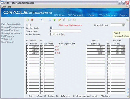

To change shortage information
From Daily Order Preparation - Process (G3113), choose Shortage Maintenance
You can change ingredient shortage information by ingredient, work order, branch/plant, and work order type, or any combination of these. You can also review information that indicates how shortages will be filled, as well as change this information.
There are several forms you can use to manage shortage information. You specify in the processing options which versions of the shortage programs that the system uses and the default order type that the system displays.
1. Complete the following fields:
Branch/Plant
Ingredient
Order Number
Complete the following default information:
Due Date
Short Quantity
Deliver to Work Center
Figure 14-7 Shortage Maintenance screen, Detail area
Review the following default information:
From Order
Due
| Date - Requested (Julian) | The requested date for a Purchase Order created through Direct Ship or Transfer Order entry. If you leave this field blank, the system uses today's date, which can be overridden at any time.
Form-specific information The date that the component is needed. If you leave this field blank, the system uses the date in the work order parts list. |

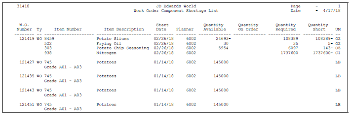

From the Periodic Functions - Process menu (G3122), choose Ingredient Shortages.
The Ingredient Shortages report lists the ingredients required to complete a work order and indicates their current availability. The report includes:
Quantities available
Quantities on order
Quantities required
Quantities short
Use the processing option to print only ingredients that are short. If a short ingredient is on more than one order, a shortage only prints when the on-hand quantity plus on-order quantity minus the required quantity is negative.
You can also generate this report as part of the shop paperwork when you run Order Processing.
Figure 14-8 Work Order Component Shortage List report

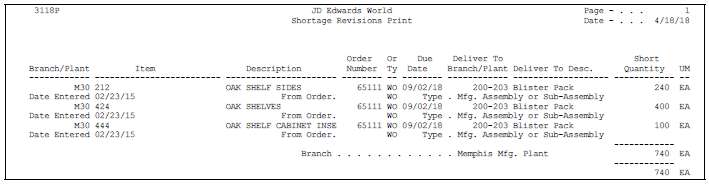

From Shop Floor Management (G31), choose Periodic Functions under Process
From Periodic Functions - Process (G3122), choose All Shortages
The All Shortages report lists shortage details for ingredients in the Shortage Maintenance Master table (F3118). Processing options control whether the report contains one or two lines of detail information about each short ingredient. You can set your reporting feature selections to sort and total the information.
Figure 14-9 Shortage Revisions Print report
