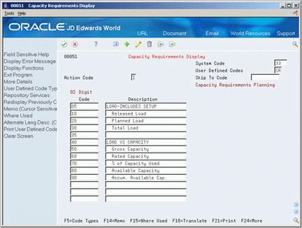

39.6 Setting Up the Capacity Requirements Display
Navigation
From Resource & Capacity Planning (G33), enter 29
From Resource/Capacity Planning Setup (G3341), choose Capacity Requirements Display
Use Capacity Requirements Display to specify row descriptions for CRP on all screens and reports. The digit code is hard-coded.
To set up the capacity requirements display
On Capacity Requirements Display
Figure 39-1 Capacity Requirements Display screen
Description of Figure 39-1 follows
Description of "Figure 39-1 Capacity Requirements Display screen"
Complete the following fields:
  • Code
  • Description
