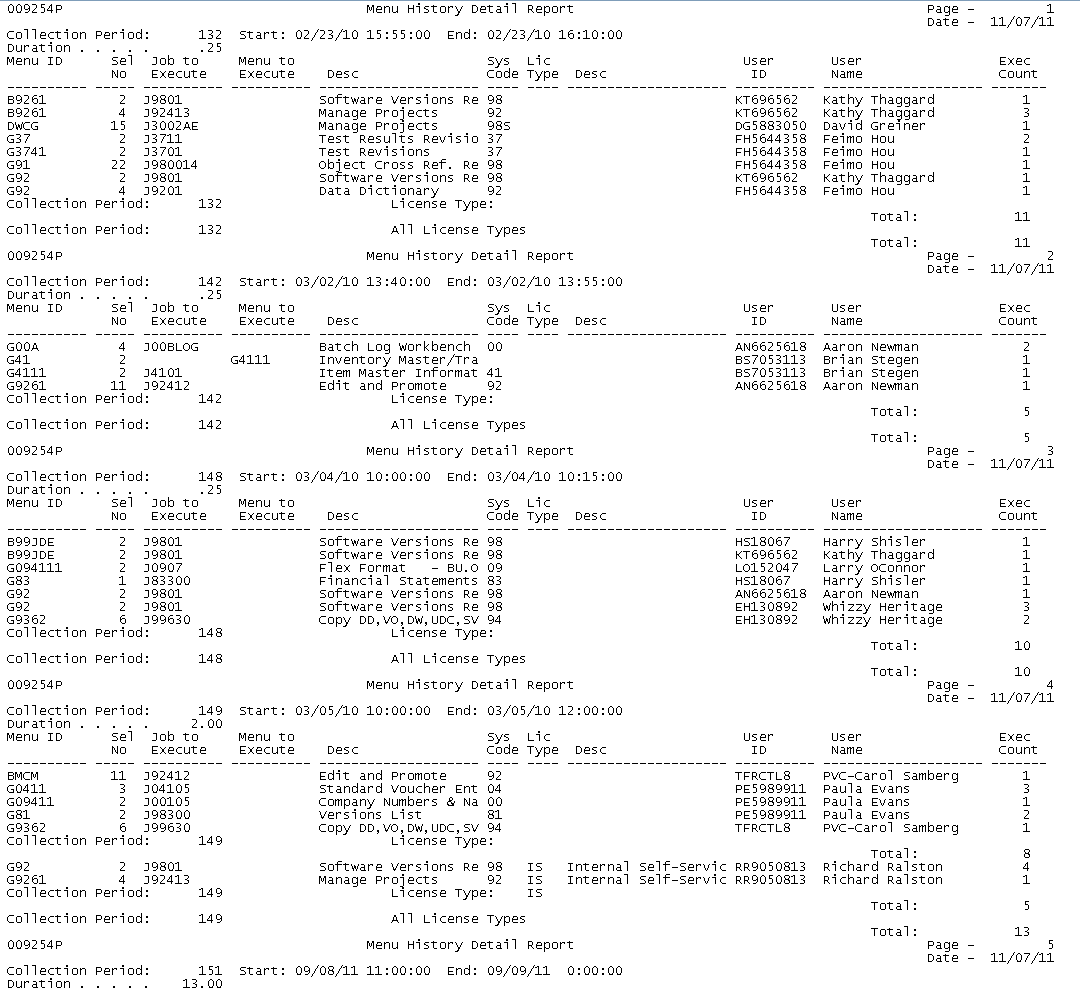

You can run the Menu History Summary Report (P009254P) in summary or detail mode. The report lists user menu selection executions from the data in the Menu History Summary for User Activity table (F009254). The detail mode lists for each execution the Menu ID, Menu Selection, Job or Menu to Execute, System Code, and User ID, User Name and License Type. The report calculates totals for the number of times users execute a menu selection by license type and collection period.
From Master Directory (G), choose Hidden Selection 27
From Advanced & Technical Operations (G9), choose Security & System Admin
From Security & System Administration (G94), choose User Activity Reporting
From User Activity Reporting (G00925), choose Menu History Summary Report
Collection Period: This is the unique identifier for a collection period defined in the Collection Period Parameters file (F009251).
Start: This is the date and time the collection period started.
End: This is the date and time the collection period ended.
Duration: This is the collection period time elapsed in hours. The fractional part of this number is in decimals, not minutes.
The report includes the following report columns:
Menu ID: This is the menu ID of a menu a user visited during the collection period.
Sel No: This is the menu selection number a user executed during the collection period.
Job to Execute: This is the program ID a menu selection executes.
Menu to Execute: This is the menu ID a menu selection executes.
Desc: This is the description from the menu of a menu selection.
Sys Code: This is the system code of a menu.
Lic Type: This is the user license type for the individual user as defined in the User License Types file (F00925).
Desc: This is the user license type description.
User ID: This is the IBM/JD Edwards User Profile ID for an individual user signed on during the snapshot.
User Name: This is the IBM User Name for the User Profile ID.
Exec Count: This is the count of the number of times a user executed a menu selection during a collection period.
The report calculates the following totals:
Collection Period: This is the highest total level for the report. This calculation is hard-coded.
License Type: This is the lowest total level for the report. This calculation is hard-coded.
Total: This is the sum of the menu selection executions during the collection period.
Peak Count: This is the maximum number of sessions and users seen in any snapshot.
Average Count: This is the average number of sessions and users seen for all snapshots.
The Menu History Summary Report uses DREAM Writer only for the purpose of setting processing options. There are no file options to modify or select. Use the following three processing options to control the scope of the report:
See Section 21.1.1.1, "DREAM Writer Considerations for the User Activity Summary Report"

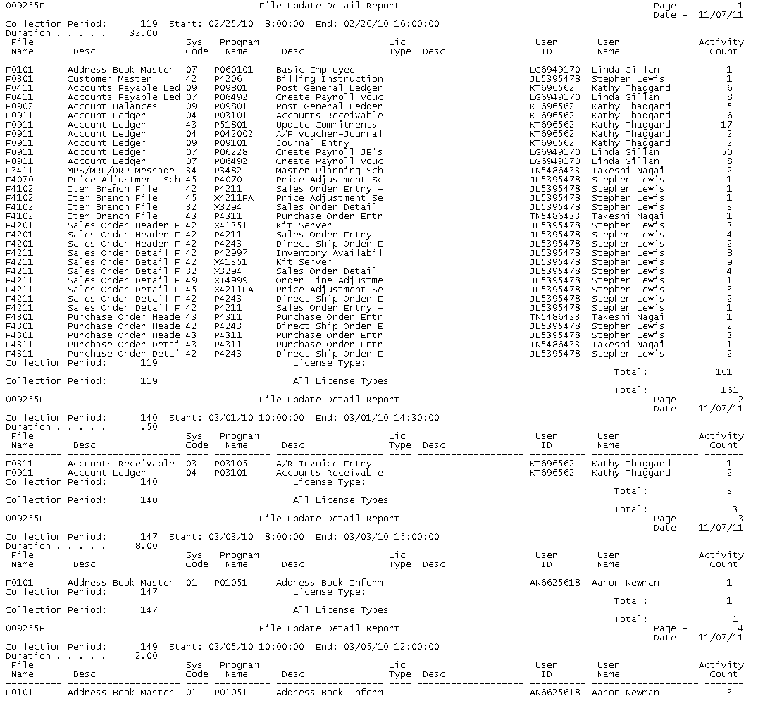

You can run the File Update Activity Summary report (P009255P) in summary or detail mode. The report lists counts of file records that are added or updated from the data in the File Activity Summary for User Activity table (F009255). The detail mode lists for each execution the Menu ID, Menu Selection, Job or Menu to Execute, System Code, and User ID, User Name and License Type. The report calculates totals for the number of file records added or updated by license type and collection period.
From User Activity Reporting (G00925), choose File Update Activity Summary
File Name: This is the short name of a file updated during the collection period.
Desc: This is the description of the file from Software Versions Repository.
Sys Code: This is the system code of a file.
Program Name: This is the short name of a program used to update a file during the collection period.
Desc: This is the description of the program from Software Versions Repository.
Activity Count: This is the count of the number of records added or updated in a file using a particular program during a collection period.
Most files contain only 'Last Updated" audit fields. Therefore, even if a user updates the same file record multiple times during a collection period, the system records only one update. Iff a user updates a file record, and then another user updates the same file record during the collection period, the system includes only the second user in the activity count.
See Section 21.1.1.1, "DREAM Writer Considerations for the User Activity Summary Report."
