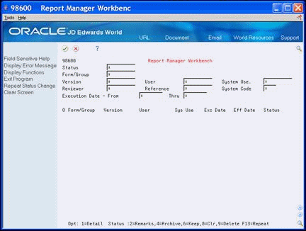

From Report Manager (G98RMGR), choose Report Manager Workbench
The Report Manager Workbench program (P98600) displays the information the Build Report/Version Workfile program gathers. You use the Report Manager Workbench to review and manage this information. You can use the workbench to locate reports by version name, user ID, use within the environment, and so forth. The Executed Date and Version Description fields contain the most recent execution date and description of each version. You can also enter various data on the Report Manager Workbench screen to view where you use versions in this environment. For example, you can view versions in Sleeper, on a Menu, and on the Version List screen.

On Report Manager Workbench, you can use the following functionality:
* (asterisk)
· Enter an * (asterisk) in the first position of any field to have the system disregard the data in that field when you perform a search.
· Display all records by entering an * (asterisk) in all fields. This is the default when the screen displays.
· Use F22 to enter an * (asterisk) in the first position of all fields. This clears data in all fields.
Choose data to view:
· Review recent use of versions by entering the appropriate dates in the Execution Date - From and Thru fields.
· Locate versions that have never been run by entering an * (asterisk) in the From field and a 0 (zero) in the Thru field.
· Determine which reports, either DREAM Writer or World Writer use a particular file, by entering the Based On File name in the Reference field. For World Writer, the system uses only the first file number on the Version Title & Files screen.
· Review remarks and the date of the review, by pressing F4.
· Enter any User ID to locate all reports that individual uses.
· Enter a Form or Group ID to display only those versions.
· Review reports at a particular status by entering that status in the Status field.
· Use the System Use field to locate where versions are in the environment. For example, a DREAM Writer that is on a menu.

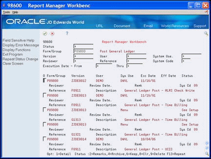

To work with the Report Manager Workbench
On Report Manager Workbench, perform one of the following:
To view all data in the workfile, click Enter.
To view select data in the workfile, complete any of the following fields and click Enter.

Figure 17-1 Report Manager Workbench screen
Figure 17-2 Report Manager Workbench (Select Data) screen

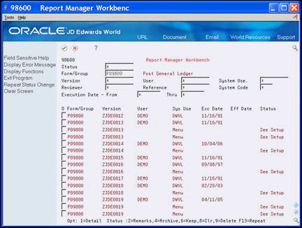

On Report Manager Workbench, press F4 to view details of a version.
Figure 17-3 Report Manager Workbench (Details) screen
