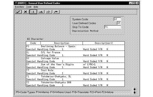

Adding a user defined code

On General User Defined Codes for Depreciation Method (12/DM), create code PS for Declining Balance depreciation.
Figure 5-1 General User Defined Codes screen (PS)
Complete the following fields with the values indicated below:
| Field | Value |
| Code | PS |
| Description | Declining Balance - Spain |
| Special Handling Code | 1 |
| Hard Coded | N |

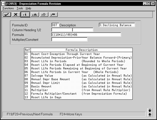

On Depreciation Formula Revision, define the following formulas:
First and subsequent years depreciation

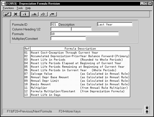

Last year
First and Subsequent Years Depreciation
Figure 5-2 Depreciation Formula Revisions screen (First and Subsequent Years)
| Field | Value |
| Formula ID | D07 |
| Description | % Declining Balance |
| Formula | ((10/11)/49)*06 |
Figure 5-3 Depreciation Formula Revision screen (Last Year)
| Field | Value |
| Formula ID | D21 |
| Description | Last Year |
| Formula | 10 |

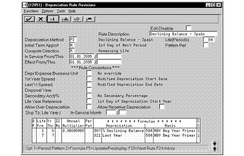

On Depreciation Rule Revisions, set up the depreciation method.
Setting up the depreciation method includes the following tasks:
Setting up reference information and conventions
Attaching the formulas to depreciation method PS
Figure 5-4 Depreciation Rule Revisions screen (Reference)
| Field | Value |
| Depreciation Method | PS |
| Rule Description | Declining Balance - Spain |
| Life (Periods) | 84 |
| Initial Term Apport | N |
| Compute Direction | R |
| In Service From/Thru | 01.01.2005 |
| Effective From/Thru | 01.01.2005 |

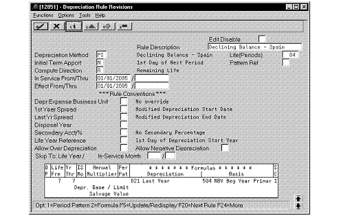

Attach the following formulas to the depreciation method:
First Record: Life Years 1 through 6
Second Record: Life Year 7
Figure 5-5 Depreciation Rule Revisions screen (Life Years 1 through 6)
| Field | Value |
| Life Yr Frm | 1 |
| Life Yr Thr | 6 |
| Annual Multiplier | 0.30000000 |
| Depreciation | D07 |
| Basis | 504 |
| SC (Secondary Percentage Continuation) | 1 |
Figure 5-6 Depreciation Rule Revisions screen (Life Year 7)
| Field | Value |
| Life Yr Frm | 7 |
| Life Yr Thr | 7 |
| Depreciation | D21 |
| Basis | 504 |
