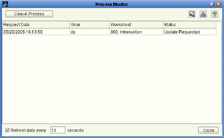

To see pending data changes
Click Data > Update to save your data changes.
Click Data > Process Monitor. Oracle Demantra displays a screen that shows all data saves that are waiting to be processed:
If you are working at a relatively high level, this takes longer to run.

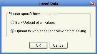

To import data
Within a worksheet, click File > Import, or click the Import Data button.
The Import Data dialog appears.
Select one of the following options:
Bulk Upload of all Values: Choose this option to commit the imported data to the database without reviewing it in the worksheet.
Upload to worksheet and view before saving: Choose this option to preview the imported data in a worksheet before saving to the Demantra database.
Click OK.
Select the tab-delimited, Unicode text file that you want to import, and then click Import.
Demantra loads all valid values from the import file to Demantra. If the import file format is incompatible with the worksheet (for example, it does not contain all the required levels, or includes more levels than are in the worksheet), then an error message appears. In this case, data is not loaded into the worksheet and the import file must be corrected before re-importing. If the import completes with errors, you can open the log file (.xls file) directly from the error dialog to view the errors.
If you chose Bulk Upload of all values' in step 3, the changes are saved to the database automatically. If you chose to upload the data to the worksheet and view before saving, you must manually save the data after reviewing it, if desired.
Note: An icon may appear in any cells that contain new or changed data. This is controlled by the ChangedDataIndicator parameter. For more information, see System Parameters in the Oracle Demantra Implementation Guide.

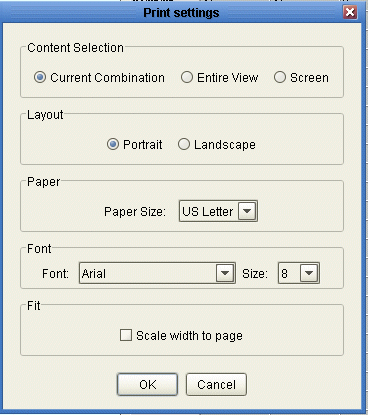

When you print a worksheet, the printed results match the screen display (what you see is what you get).
To print the displayed data
Click File > Print. Or click the Print button on the toolbar.
The Print Settings dialog box appears.
Select the required options.
| Content selection | Specify whether to print the currently selected item-location combination, all combinations in the worksheet, or the screen. |
| Layout | Choose portrait or landscape orientation. |
| Paper | Choose a paper size. |
| Font | Choose a font size. |
| Fit | Select Scale width to page to force the columns to print on one page left-to-right, without your having to resize the worksheet columns. The output uses the paper size and print orientation that you choose. It respects the font size that you choose as much as possible but may use a smaller font if necessary to accommodate the paper size and print orientation. |
If this worksheet includes a Gantt chart, optionally click the Gantt Settings tab. On this tab, specify which promotion attributes to include in the printout.
Click OK.
Oracle Demantra displays the normal system print dialog box, where you choose the printer to use, the number of copies to make, and so on.
Make selections as you would normally do.
Click OK.

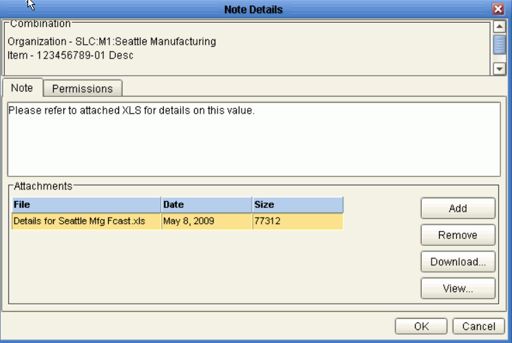

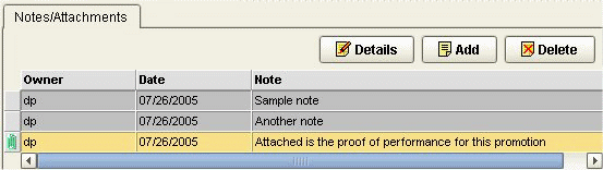

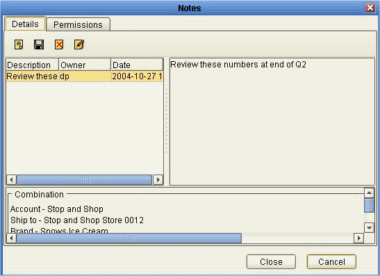

You can add notes to record comments and reminders. You attach the note to combination and date or dates. The worksheet table displays indicator symbols on those dates, generally in only some of the columns (depending on how your system is configured). The following shows an example of the indicator:
The graph displays an indicator as well:
You can see notes in two different areas:
In the Notes dialog box.
Notes/Attachments subtab, if this is included in your worksheet. This subtab also displays any associated attachments.
To open the Notes page
Do one of the following:
In the table, right-click a cell and select Notes...
In the table, double-click the left (non-scrolling) column. (Depending on how Oracle Demantra is configured, this action may not bring up the Notes page.)
In the graph, hold the mouse button over a point, right-click and then select Notes...
To display the Notes/Attachments subtab
See Specifying the Worksheet Elements in a View.
Editing Notes
Viewing and Managing Attachments to Notes

First display the Notes page or the Notes/Attachments subtab; see Viewing Notes. In the upper part of the worksheet, click the element to which you want to attach this note.
To add a note
If the Note box is gray (uneditable), click the Add button.
Type a note in the Note box.
If you are working in the Notes/Attachments subtab, you can optionally upload an attachment (see Viewing and Managing Attachments).
Click the Save button.
To edit a note
Select a note and click the Edit button.
If you are working in the Notes/Attachments subtab, you can optionally upload an attachment (see Viewing and Managing Attachments to Notes).
To delete a note
Select a note and click the Delete button.
The Confirm Delete message box appears.
Select one of the following:
Partial Deletion (deletes the note only from the current member and date)
Total Deletion (deletes the note from all members and dates)
Click OK.
Click Save.
See also:
Viewing Notes
Specifying Note Permissions
You can attach files to the notes, and Oracle Demantra uploads those files into the database (in compressed form). To view and manage attachments, you work in the Notes/Attachments subtab of your worksheet.
To add an attachment to a note
Click the note.
Click Details.
Oracle Demantra displays the Note Details screen:
Click Add.
Find the file that you want to attach and then click Open.
Oracle Demantra uploads a compressed version of the file into the database.
Click OK.
To remove an attachment from a note
Click the note.
Click Details.
Click the row that lists the attachment and then click Remove.
Click OK.
To view and download an attachment
Click the note.
Click Details.
Click the row that lists the attachment and then click:
View if you want to see the attachment immediately. Oracle Demantra recognizes the attachment file type and opens the application for viewing it.
Download... if you want to save it.

In general, notes (and their optional attachments) can be viewed by other users. You can specify permissions for the notes, to determine who can read the note and what type of access they are permitted. You can specify permissions for groups or for specific users.
To specify permissions for a note and its attachments
On the Details tab, select the note.
Click the Permissions tab.
Select the User Permissions or Group Permissions tab.
For each user or group that should have non-default settings for this note, move that user or group from the left list to the right list (Selected Users or Selected Groups). Use any of the techniques in Working with Lists.
Note: Read-only is the default setting for non-selected users or groups.
Remove any unwanted users or groups from the right list.
Then for each user or group in the right list, do the following:
Click the user or group.
Select a setting from the Permission dropdown list at the bottom of the page. The following options are available:
| Read and Write | Enables the user or group to read the notes list, edit notes, and add notes. |
| Read Only | Enables the user or group to read the notes list. |
| Not Visible | Makes the note list not visible to this user or group. |
| Full Control | Enables the user or group to read the notes list, edit notes, add notes, and delete notes. |
Click Save.
Click Close.
Group and user permission priorities
User permissions take precedence over permissions of any groups the user belongs to.
If a user belongs to more than one group, the highest level of permissions from the associated groups will be granted.
See also Viewing Notes.

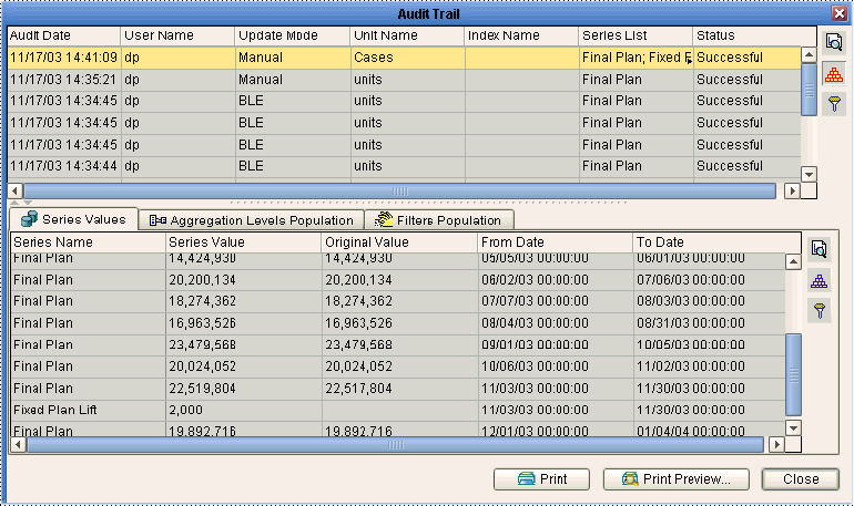

Oracle Demantra automatically records changes in an audit trail. The audit trail includes all changes due to user edits within worksheets, updates created by the Business Logic Engine, copy/paste actions, and changes caused by import.
Note: You can see only changes that were made by you or other users who are in the same collaboration groups as you.
Oracle Demantra provides two ways to view the audit trail:
You can view the changes that have occurred to the item-location combination that is currently displayed in the worksheet.
You can create and then execute a profile that specifies a wider set of data: multiple combinations, a wider span of time, and so on.
In either case, the audit trail looks like this:
The top part of the page lists the changes. When you select a row in this table, the bottom part of the page lists details corresponding to that row.
The Series Values tab displays details on the series that were changed.
The Aggregate Level Population tab displays the specific aggregation levels to which this change applies. The change could have occurred at a different aggregation level.
The Filtered Population tab displays the filtering that was used at the time of this change.
To view the audit trail for a combination
In a given worksheet, select a combination.
Click Data > Audit Trail.
If any changes have occurred to this combination, the Audit Trail screen appears, displaying a table with one row for each recorded change. The following information is displayed:
| Audit Date | Date when change was made. |
| User Name | User who made the change. |
| Update Mode | Indicates the type of change: Manual, BLE (Business Logic Engine) or Integration. |
| Unit Name | Unit of measure that was used at the time of the change. |
| Index Name | Index that was used at the time of the change. |
| Series List | Series affected by the change. |
| Status | In Progress, Fail, or Success. |
To see specific details on this change, click a change in this table and then click the Series Values tab.
This tab displays the following information:
| Series Name | Name of the series that was changed. |
| Series Value | New value used in this series. |
| Original Value | Original value in this series. |
| From Date | First date in the series when the change occurs. |
| To Date | Last date in the series when the change occurs. |
To see the specific aggregation levels to which this change applies, click the Aggregate Level Population tab. The change could have occurred at a different aggregation level.
To see the filtering that was used at the time of this change, click the Filtered Population tab.
