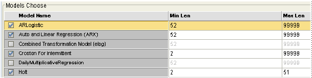

To select the forecasting models to use
The Models Choose area lists all the mathematical models that the engine uses.
use dropdown lists to specify which item-location combination you want to look at and click OK. You can see any of the combinations that are in the worksheet. Do either of the following:
- Select a specific combination from the Combination list.
- Select specific items and locations from the other dropdown lists.
The rest of the view updates with information for the selected combination.
The check boxes indicate the models that the Analytical Engine used for this combination during the last engine run.
To enable the Analytical Engine to use this model for this combination, make sure the Active check box is checked. For details on these models, see the Oracle Demantra Analytical Engine Guide.
The other two settings control the minimum and maximum number of nonzero observations that a combination must have in order for the Analytical Engine to consider using this model. To specify these values, type integers into the Min Len and Max Len fields.
Note: Min Len must be equal to or greater than the number of causal factors in the forecast, except for the HOLT and FCROST models, which do not use causal factors.

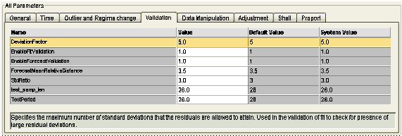

To specify the analytical configuration
The All Parameters area lists parameters that apply to all engine models. These parameters are grouped onto different tabs according to their general purpose.
Each tab includes the following information for each parameter:
| Value | Current Value |
| Default Value | Default value as specified by Oracle Demantra installer |
| System Value | Default as specified by your implementors |
Also note the parameter description in the bottom part of the screen.
Optionally edit these parameters. For information, see the Oracle Demantra Analytical Engine Guide.
To reset the parameters to their default values, click icon Reset Manual Changes.
When you are done, click icon Save Data and close the Analytics view.

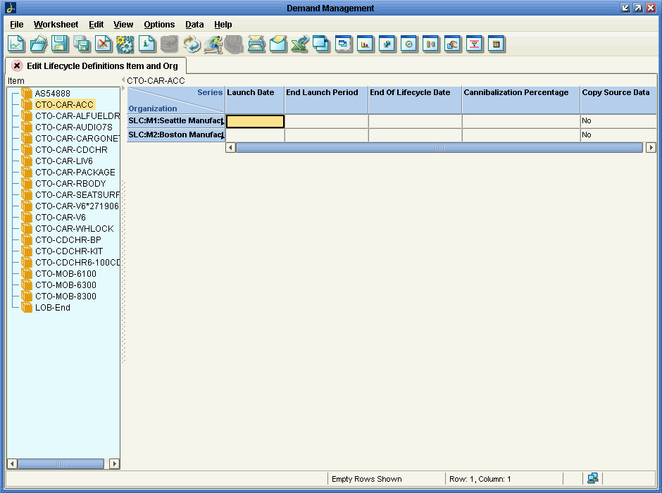

Updating Product Lifecycle Definitions
Once a similar product has been defined, you can later edit the product details for some (or all) locations from the Edit Lifecycle Definitions Item and Org worksheet.
To update a product lifecycle definition:
From the the Demantra Local Application, open any worksheet.
The Worksheet Designer appears.
From the File menu, choose Open.
From the Open Worksheet dialog box, choose Edit Combination Definition Item & Org.
Edit Combination Definition Item & Org worksheet appears.
Double-click a worksheet cell to edit the current value.
From the Data menu, choose Save Data.
Initiate the Update Lifecycle Definitions method to propagate changes in lifecycle definition and affect all relevant areas.

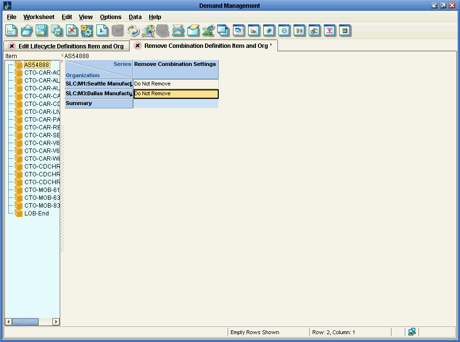

A change in the business environment or plan may result in large amount of undesired combinations and data rows existing in the system. This may result from a variety of causes including product assortment changes, erroneous data collection or use of create similar product.
Use the Remove Lifecycle Definitions Item and Org worksheet to remove items and locations links. All data for deleted combinations is also deleted.
To remove lifecycle definitions:
From the Demantra Local Application, open any worksheet.
From the Open Worksheet dialog box, choose Remove Combination Definition Item & Org.
The Remove Combination Definition Item & Org worksheet appears.
From the Remove Combination Setting drop-down list box, indicate whether or not you want to delete a combination.
From the File menu, choose Save Worksheet.
Execute the Remove Combinations method.
The Remove Combinations dialog box appears.
To confirm the deletion, choose Yes from the Remove Combinations drop-down list box, and then click the Remove button.
Note: Removing a combination that is set to cannibalize another item will update the cannibalization percentage for the remaining items.
Note: If all combinations for an item are removed the item itself will be deleted.
