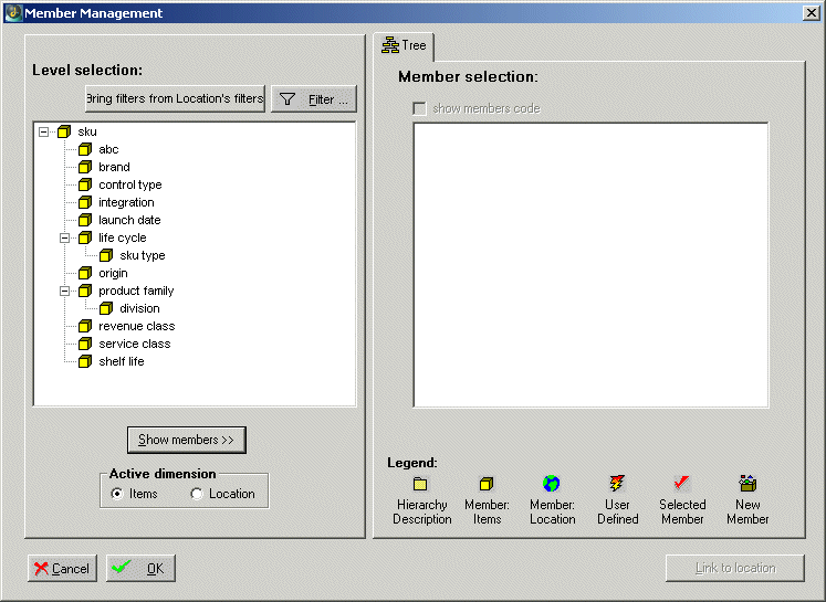

To display the members of a level
In Active Dimension, click either Items or Locations.
The left window of Member Management displays all the levels of that dimension.
In the left window, click the level.
Optionally filter the display for performance; see Filtering the Members.
Click Show Members.
The Member Selection pane displays the members of that level and all submembers.
In the Member Selection pane, expand the hierarchy as needed.
For performance reasons, the maximum number of members displayed is preconfigured for your system. To display more members, click the More Members symbol.
By default, Member Management displays the descriptions of the members. To see the codes instead, select the Show Members Code check box.
Note: If you switch from the item dimension to the location dimension and then switch back (or vice versa), Member Management does not remember your selections. It does, however, remember any filters you applied in either window.

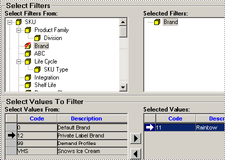

To filter the displayed members, method 1
Click Filter.
The Filter dialog box appears.
In the Select Filters From pane, select a level to be filtered.
The list of members for that level is displayed in the Select Values From pane.
Click the members to be included in the Select Values From pane and click the arrow to move them to the Selected Values pane, for example:
Click OK to return to Member Management.

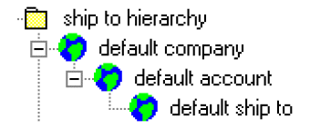

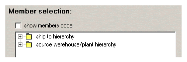

Select the member that you are using as the starting point. For this example, click the Rainbow member to select it.
If there are other hierarchies within this dimension, select a member within each of them. For example, suppose that the Member selection list includes two hierarchies of locations, as follows (shown collapsed to save space).
In this case, you need to select a member within the ship to hierarchy and a member within the source warehouse/plant hierarchy.
You do this so that the new combination can be found within both these hierarchies.

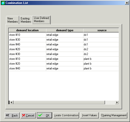

To manage the lowest-level combinations
Start Member Management, as described in Starting Member Management.
Click the Combination List button at the bottom of the screen.
This button is activated only when both the item and location members to be linked have been selected.
In the Combination List, all possible hierarchy links are displayed in three tab windows: New Members; Existing Members, and User Defined Members:
Do one or more of the following:
To create combinations, select one or more combinations and click Create Combinations.
To add the combinations to the database and create zero histories for them, select one or more combinations and click Insert Values.
Tip: To select more than one member combination, press Shift+Click or Ctrl+Click.
To go directly to Chaining Management, click Chaining Management.
To save changes and close Member Management, click OK.
To close Member Management without saving changes, click Cancel.

To delete a member
Display members of the level of interest. See Displaying Level Members.
In the Member Selection pane, right-click the member of interest and then select Delete. This option is available only for user-defined members.
A confirmation dialog box appears.
Click Yes.
Click OK to save the change and close Member Management. Or click Cancel to discard the change and exit Member Management.
