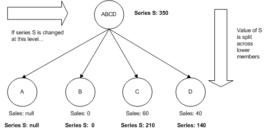

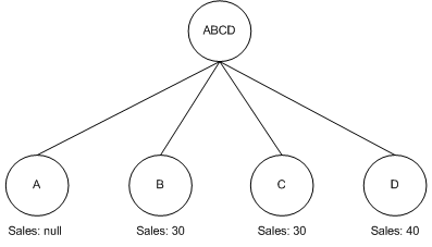

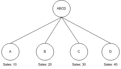

The following figure shows an upper-level member, ABCD, and its four child members. It also shows a reference series (Sales), and it shows the value of that series for each child member, all within the same time bucket.
Now suppose that series S is a proportional series that uses Sales as its reference series, and suppose that the value of S is changed to 350 for the parent member. In this case, the series S is split across the child members as follows:
Now consider a case where the reference series has a null value for one of the child member. The proport mechanism ignores that member, as follows:
Now let us consider two cases where child members have zero values. In the first case, the reference series is zero for one of the child members, but has non-zero numbers for other child members. Any member with 0 sales receives 0% of the split, as follows:
Notice that member A that has a null value for the reference series; for this member, the value of series S is null, rather than 0.

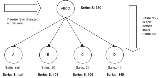

In the second case, none of the child members has a non zero value. In a case like this, the parent value is split equally among all members that have zero values for the reference series.
As always, if a child member has null for the reference series, the proport mechanism ignores that member entirely.
