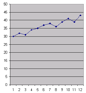

Starting with the average daily demands for each item-location combination for each month of the year, Demantra considers the change in level over the past year and adjusts the level of the proportions accordingly.
For a simple example, consider the following historical daily demand, over the last year:
| Jan | Feb | Mar | Apr | May | Jun | Jul | Aug | Sep | Oct | Nov | Dec |
| 30 | 32 | 31 | 34 | 35 | 37 | 38 | 36 | 39 | 41 | 39 | 43 |
A slight upwards trend is fairly obvious, especially when this demand is graphed.
To keep matters simple, suppose that we have only one year's worth of data. If we just used demand from last January (that is, 30) for the next January, we would underestimate the demand, because the overall level of demand has increased over the last year. Therefore, Demantra calculates the level-adjusted daily demand for January as follows:
P1 = (smoothed P1) * (rolling average) * 12 / (sum of all average demand)
Here smoothed P1 is the average demand per day for January as calculated previously and then smoothed as described in “Smoothing Out Variations”. These level-adjusted, “normalized” proportions are stored in mdp_matrix, overwriting the old P1, P2, ... fields:
