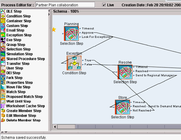

This screen has three panes:
The left pane lists all the available steps that you can include in the workflow.
The right pane shows the definition of the workflow itself.
The message pane at the bottom of the window contains information, such as a warning of a failed validation or confirmation of a successful save.

Add the required steps to the workflow. To add a step to the workflow:
In the left pane, double-click the icon corresponding to the step.
The Workflow Editor displays a popup window that prompts you for information about the step.
Specify the step properties. The properties depend on the kind of step you are adding. For details, see “Workflow Steps”.
Click OK.
The step is added to the right pane.
Within the right pane, optionally reposition the step icon to improve readability.

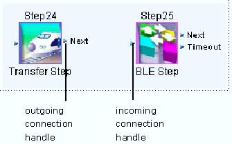

Connect the steps in the required order. To link two steps, click the outgoing connection handle of the first step and drag to the incoming connection handle of the next steps.
Note the following rules:
An outgoing connection handle can be linked to only one following step. The Container Step is the exception.
A step that is contained within a Container Step cannot have any of its outgoing connection handles connected to other steps.
The Selection Step has multiple outgoing steps. To define the outgoing connection handles and to add the links, you use the properties dialog box. See “Defining and Linking to Selections”.

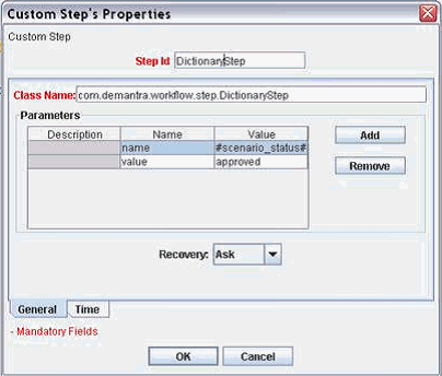

The dictionary allows you to get and set capabilities on member attributes. A custom step called the 'DictionaryStep' (com.demantra.workflow.step.DictionaryStep) allows users to specify an attribute name, and a value to assign to that attribute.
To accomplish this, two parameters must be specified:
Name – Attribute name. This is the name of the parameter on the dictionary that will be modified. When a level method is executed, it places all the level attributes as parameters on the dictionary. The attribute names are the internal column name in uppercase letters. The reference is case insensitive. To support passing parameters between steps, the dictionary also adds the parameter to the dictionary, if the attribute does not already exist on the member.
Value – Attribute value. This is the value that the attribute receives. The dictionary step modifies the value only if the attribute type matches the value. In other words, if the name is of type “character,” it can be updated with any numeric and alphanumeric character. If the name is of type “number,” it will only allow numeric updates. Values can also reference a different attribute, in this case you enclose the reference attribute internal name with parenthesis {}.

Login to Workflow Manager.
Create a New Schema by selecting New Schema.
On the left hand side, select Custom Step from the list of available steps.
Give the step a unique identifying name. Specify the class name as com.demantra.workflow.step.DictionaryStep. Also specify the name of the attribute the step will set and the value; rows are added to the parameters table by selecting Add on the right hand side.
In the example below, the DictionaryStep will look up the attribute/parameter “scenario_status” on the dictionary, and then set it to “approved”.
Important: In order for methods to be able to save values to the database there should always be an “EditMemberStep” preceding the DictionaryStep.
