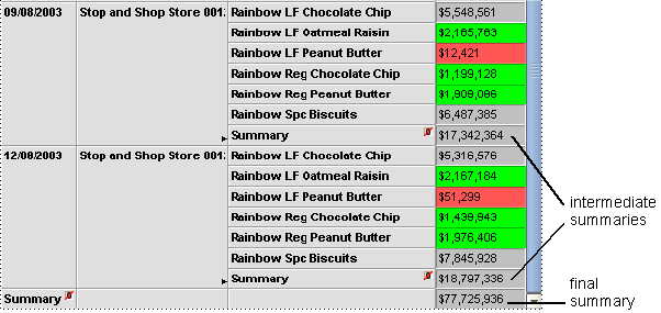

Returns an integer that indicates the relative level of the summary row where this function is used.
Note: This function is available only for use within the summary row of a series.
Syntax
GetWorksheetLevelNumber ( )

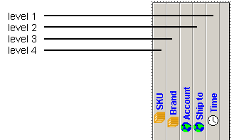

You use this function to achieve different kinds of summaries for a series in different contexts in a given worksheet. Specifically, when a worksheet uses one or more levels on the x-axis, the worksheet table includes intermediate summary rows, for example:
By default, the final summary row and all the intermediate summary rows are calculated in exactly the same way. The GetWorksheetLevelNumber function provides a way to distinguish each summary row, so that you can create a different summary functions as needed, at each of those levels.
To determine the relative aggregation level of the summary rows, the function considers the layout of the worksheet. The following figure relates the summary levels to the x-axis layout:
For level 1 in the worksheet, GetWorksheetLevelNumber returns 1, and so on. If there are n levels on the x-axis of the worksheet, the function returns n+1 for the final summary.
Example
Suppose that you want to display only the intermediate summary but not the final summary, as follows:
To achieve this, you could use a summary row expression of the following form:
If ( GetWorksheetLevelNumber() =1, SummaryMax ( Sample Max ) , Null Value )
Note: If you configure a series with a context-sensitive summary row like this, be careful to use that series only within worksheets that have the appropriate layout. You may want to add a usage note to the series hint message to guide users.

Returns the average value of the displayed rows of the specified series.
Note: This function is available only for the summary row of a series.
Syntax
SummaryAvg( argument )
Here argument is the name of a series that has a numeric value.
Any null value is treated as zero.
Returns the total count of the displayedrows of the specified series.
Syntax
SummaryCount( argument)
Returns the maximum value of the displayed rows of the specified series.
Syntax
SummaryMax( argument )
Returns the minimum value of the displayed rows of the specified series.
Syntax
SummaryMin( argument )
Returns the sum of the displayed rows of the specified series.
Syntax
SummarySum( argument )
