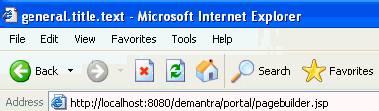

The following parameters control titles throughout the Demantra solution:
