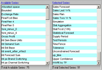

The Business Modeler displays the Available Series and Selected Series lists.
Select the series that should be available in the component.
Move all series that you want into the Selected Series list, using any of the techniques in “Working with Lists”.
Remove any unwanted series from the Selected Series list.
When you are done specifying series, click Next.

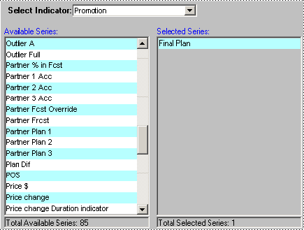

The Business Modeler displays the Select Component Indicators for Series window. Here you specify which series should have indicators to indicate associated promotions or notes.
Within a worksheet, a user can attach a promotion (in the case of Promotion Effectiveness) or a note to a given item-location combination, at a given date. If a series has been configured as using an indicator for that particular promotion or note, the series will be displayed with an indicator in all worksheet cells that correspond to that item-location combination and date.
You can associate an indicator for any general level at the lowest level (that is, any general level that do not have child levels).
The default associations are different for different kinds of series. Sales series have notes indicators by default. Promotion series have both notes and promotion indicators by default.
This configuration affects all users of this component. No further fine tuning is possible.
To associate indicators with different series, do the following for each general level:
In Select Indicator, select the general level, either Note or Promotion.
Move all series that should use the associated indicator into the Selected Series list, using any of the techniques in “Working with Lists”.
Click Next.

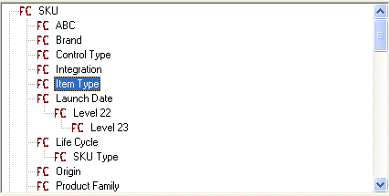

The system displays all the levels and indicates the current permission settings in this component.
The following icons indicate the permissions:
| FC | Full control (including permission to delete members) |
| W | Read/write access |
| R | Read access |
| X | No access |
For each level that you want to change, right-click the level and select the appropriate permission:
No Access (the user does not have access to this member; this option is equivalent to not including this member in the filter)
Read Only (the user can view this member but cannot make any changes)
Write (the user can view or edit this member)
Full Control (user can view, edit, create, and delete within this member)
System Default (use the default permission controlled by the DefaultLevelSecurityAccess parameter.
Note: By default, this configuration affects all users of this component. To fine tune permissions for a given user, see “Creating or Modifying a User”.
Click Next.

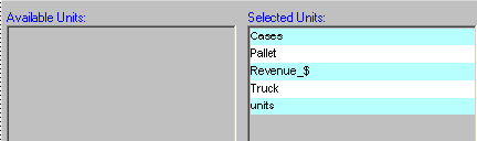

The system displays the Available Units and Selected Units lists.
Select the units of measure that should be available in the component.
Move all units that you want into the Selected Units list, using any of the techniques in “Working with Lists”.
Remove any unwanted units from the Selected Units list.
Note: This configuration affects all users of this component. No further fine tuning is possible.

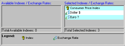

Select the indexes and exchange rates that should be available in the component.
Move all indexes and exchange rates that you want into the Selected Indexes and Exchange Rates list, using any of the techniques in “Working with Lists”.
Remove any unwanted indexes and exchange rates from the Selected Indexes and Exchange Rates list.
Click Next.

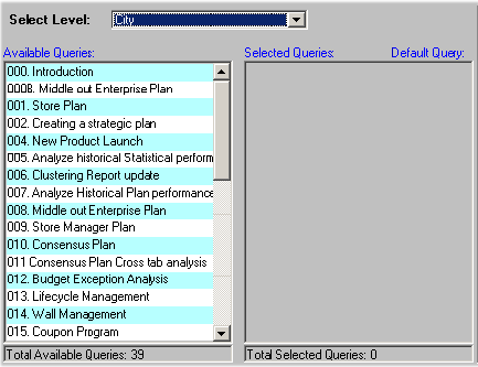

The next dialog box allows you to associate public worksheets with levels.
This association is used in two ways:
Within the Members Browser, a user can use the right-click menu to open any of these associated worksheets directly from a member of the level (via the Open With menu option). In this case, Demantra opens the associated worksheet. The worksheet is filtered to show only data relevant to the member.
A worksheet can include an embedded worksheet that shows details for the member that is currently selected in the worksheet. Specifically, within the worksheet designer, users can add a subtab to a worksheet. The subtab consists of any of the worksheets that are associated with a level included in the main worksheet. The embedded worksheet is filtered to show only data relevant to the member.
At this point, do one of the following:
To continue without associating any worksheets and levels, click Next.
To associate a worksheet with a level, do the following:
Click the level in the Select Level dropdown menu.
Double-click the worksheet in Available Queries list, which moves it to the Selected Queries list.
Move other worksheets from the Available Queries list to the Selected Queries list, as needed.
Decide which worksheet in the Selected Queries list should be the default worksheet for this level. For that worksheet, click the Default check box. When the user right-clicks and selects Open, this is the worksheet that will be used.
When you are done on this screen, click Next.

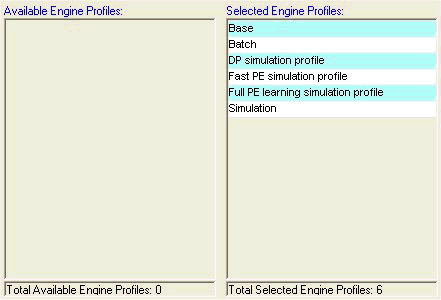

If you are using the PE Analytical Engine, the system displays engine profiles that could potentially be used within this component. The Business Modeler displays the Available Engine Profiles and Selected Engine Profiles lists.
Select the engine profiles that should be available in the component. Profiles can be used only with the Promotion Effectiveness engine.
Move all profiles that you want into the Selected Engine Profiles list, using any of the techniques in “Working with Lists”.
Remove any unwanted profiles from the Selected Engine Profiles list.
When you are done specifying profiles, click Next.

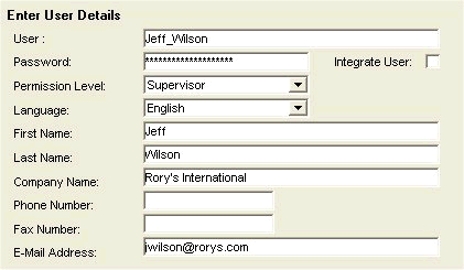

Specify basic user details as follows:
Under Enter User Details, type the following information in the appropriate boxes (or select from the drop down lists):
The user name, password, permission level, and the language in which the system will be operated. Each user name must be unique within your Demantra implementation.
The first and last name of the user, the company name, phone and fax number, and the email address. If you set up automated email within workflows, it is important to make sure the email address is correct here.
Note: The Integration User check box is not currently supported.
For Permission Level, see “Permission Levels”.

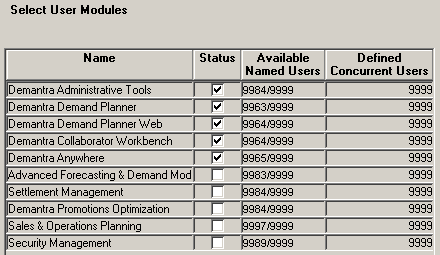

The User Modules dialog box appears. Here you specify which Demantra user interfaces this user can access.
Click the check box next to each module that the user needs. Then click Next.
If you are logged in as the component owner and the user's permission level is 'System Manager', then the following two options will be enabled for selection (otherwise, they will be disabled):
Demantra Administrative Tools – Select this option if you want the user to be able to access the Engine Administrator, Chaining Management, and Member Management applications as well as all functions in the Business Modeler except the Security function.
Security Management - Select this option if you want the user to be able to access the Security function within the Business Modeler. The Security function is used to create new, or modify existing, users and user groups.
Note that only component owners can grant access to the Security Management and Administrative Tools modules and that these modules can only be granted to Users with a Permission Level of System Manager

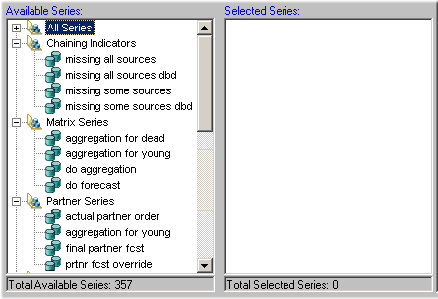

The New User - Select User Series dialog box appears. This dialog box allows you to determine what data series will be active for the new user, from the entire set of series in this component. Each list is a collapsible list of series groups and the series in them.
If a User does not have access to either the Demantra Administrative Tools module or the Security Management module, then they can login to Business Modeler, but can only change their password.
If a series is not active for a user, it is not available when the user creates worksheets and is not viewable in existing worksheets to which the user has access.
Specify the series that a user can see, as follows:
Move all series that you want into the Selected Series list. To do so, either double-click each series or drag and drop it.
Note: You can also move an entire series group from one list to the other in the same way.

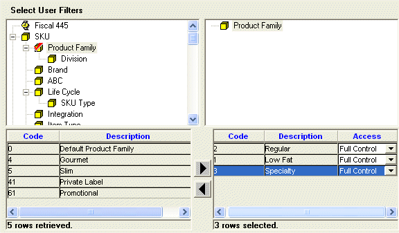

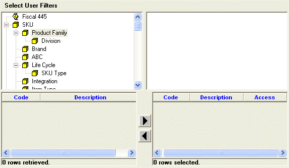

The New User - Select User Filters dialog box appears. This dialog box lets you filter the data that the user can see; specifically, you control which levels and which members of those levels the user can see.
Filter the data that the user can see, as follows:
Click a level in the left side of the dialog box and drag it to the box on the right. Or double-click a level in the left side.
Now specify which members of this level the user can see. To do so, click a member in the list, and then click the right arrow button. Or double-click the member you want to filter out.
The system moves the selected members to the box on the lower right side, as in this example:
Now the user can see only the selected members of this level. In the preceding example, the user can see only data that is associated with the Rainbow brand.
Note: The Selected Members list cannot include more than 200 members.
In the lower right, refine the security settings that control the access that the user has to each member. To do so, in the Access column, click one of the following:
Read & Write (the user can view or edit this member)
Read only (the user can view this member but cannot make any changes)
No access (the user does not have access to this member; this option is equivalent to not including this member in the filter)
System Default (use the default permission controlled by the DefaultContentSecurityAccess parameter)
Repeat the preceding steps for each filter you want to add. Each filter automatically limits the choices available in subsequent filters.
When you have appropriately filtered data for the user, click Next.

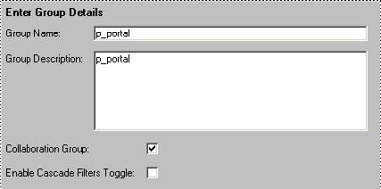

To create or modify a group
Log on to the Business Modeler as described in “Logging onto the Business Modeler.”
Click Security > Create/Modify Group. Or click the Create/Modify User Group button.
The Create/Modify Group dialog box appears.
Next:
To create a new group, double-click the New Group button.
To modify a group, click the button of that group then click OK. Or double-click the icon of the group whose details you want to modify.
The system prompts you for information about the group.
Specify group details as follows:
Under Enter Group Details, type a name and optional description in the appropriate boxes. Each group name must be unique within your Demantra implementation.
If users of this group should be able to see either other in the Who's Online pane in the Demantra Local Application, make sure the Collaboration Group check box is checked. To access the Workflow Manager, a User Group must be assigned to the workflow.group parameter (in the Business Modeler). For details, refer to Providing Access to the Workflow Editor.
The users will also be able to send tasks to each other.
If you clear this check box, users of the group will not see one another.
Check or clear the Enable Cascade Filters Toggle check box.
Click this option to enable users in the group to toggle between cascade and non-cascade filter modes. If not selected, the user will have cascade filtering only.
In cascade mode, users see only members that have combinations with the previously selected members. Members that do not have combinations will not be available in the list. It is generally easier to work with filters in cascade mode.
In non-cascade mode, users see all the members of the selected level regardless of the previously selected members from other levels.
Note: If Cascade Filters are enabled, you can define whether they should initially be toggled on or toggled off. To do this you need to set the value for the column CASCADE_FILTERS_DEF_VAL in the table GROUP_ATTRIBUTES_POPULATION. A value of 1 means that Cascade Filters are initially toggled on. A value of 0 or null means they are initially toggled off. The default is 1. You set this value using a database utility such as Oracle SQL Developer. If Cascade Filters are not enabled then this setting has no effect.

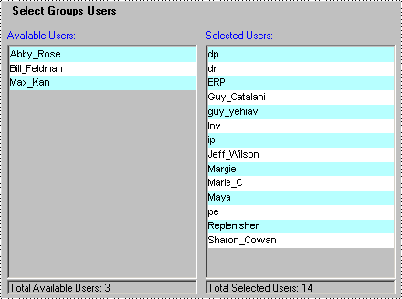

The New Group - Select Group Users dialog box appears. This dialog box allows you to select existing users who will belong to the new group.
Specify the users in a group, as follows:
Move all users that should be in this group into the Selected Users list. To do so, either double-click each user name or drag and drop it.
Note: You can also select and move multiple users with the standard Ctrl+click or Shift+click actions.
Remove any unwanted users from the Selected Users list.
Click Next.

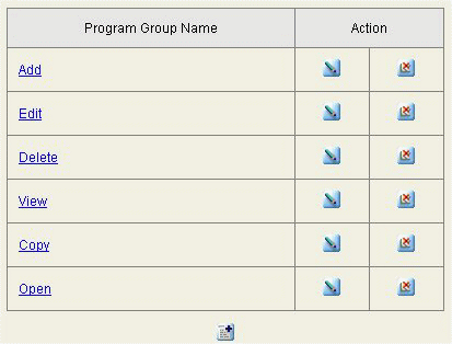

A program group is a collection of menu items, typically related to each other in some way. You create program groups so that you can easily control access to all the menu items in the group; see “Specifying Permissions for Menu Items”.
Demantra provides several predefined program groups, for convenience. These program groups contain only menu items from the right-click menus.
| Program group | Menu items in this group, by default |
| Add | New member right-click menu option for every level in the system. |
| Edit | Edit member Unmapped Conditional Text: HelpOnly right-click menu option for every level in the system. |
| Delete | Delete member right-click menu option for every level in the system. |
| View | View member right-click menu option for every level in the system. |
| Copy | Copy, Paste, and Paste from Clipboard right-click menu options for every applicable level in the system. (Note that this option is available only for promotional-type levels.) |
| Open | Open and Open With right-click menu options for every level in the system. |
Log into the Demantra Local Application Administrator. See “Logging onto the Demantra Local Application Administrator”.
The Administration page appears.
Click Define Program Groups.
The system displays a page that lists the existing program groups.

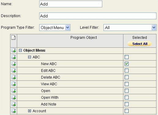

Click the Add Program Group button.
Demantra displays a page where you can define a new program group:
For Name and Description, specify a name and optional description for this program group.
Optionally select an item from the Program Type Filter selection list, to reduce the number of menus and menus items shown on this screen.
To display only options on the right-click menus, click Object Menu.
To display only options on the menu bars, click Menu.
Optionally select a level from the Level Filter selection list, to reduce the number of menus and menus items shown on this screen. (This filtering is available only if you are viewing right-click menus.)
In the table, expand the menus as needed.
In the Selected column, select the check box for each menu item to include within this program group.
Click OK.

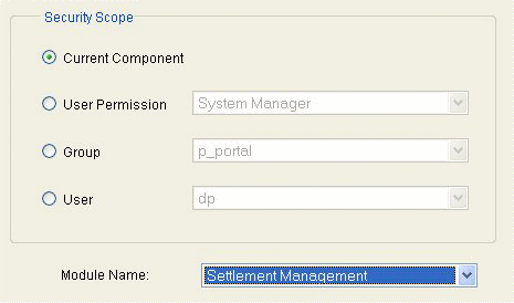

To specify permissions for menu items
Click Define Program Permissions.
The system displays a page where you specify the category upon which to apply the menu availability.
To define the scope, check one of the following radio buttons and select an item from the associated drop down list:
Click Next.

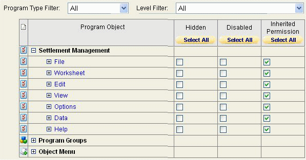

Demantra displays an expandable hierarchy that shows all the menu items you chose, like the following example:
Initially, the Inherited Permission check boxes are all checked, which means that the permissions that will be used are inherited from higher in the security hierarchies. Likewise, the Hidden and Disabled check boxes display the current inherited settings.
For each item in this table, specify permissions as follows:
| Desired outcome | Hidden | Disabled | Inherited Permission |
| Menu option is explicitly hidden | Checked | Irrelevant | Unchecked |
| Menu option is explicitly displayed but disabled | Unchecked | Checked | Unchecked |
| Menu option is explicitly displayed and enabled | Unchecked | Unchecked | Unchecked |
| Use implicit permissions for this menu item | Unchecked | Unchecked | Checked |
| Note: To understand how multiple permissions are combined, see “How Demantra Combines Multiple Permissions”. |
Click Finish. The settings are saved.

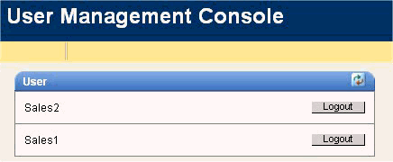

Demantra provides a tool that you can use to log out users whose sessions have hung due to network or other problems. This applies only to the users of the Web-based products.
Note: You must have a permission level of "System Manager" to use this tool.
To log a user out of Demantra
Browse to the following case-sensitive URL:
http://server name/virtual directory/portal/userManagement.jsp
For example:
http://frodo/demantra/portal/userManagement.jsp
A login page appears.
Type your username and password and then click Log on.
Demantra displays the following screen:
Click Logout in the row corresponding to the user you want to log out.
