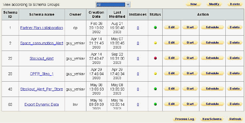

You can view all the status of all public workflow schemas and all private workflow schemas that you created. This means that you can see how many instances of those schemas are running, as well as the status of each instance.
To view overall status of the workflows
The Workflow Manager displays the overall status information for the workflows, for the currently selected schema group (All in this case).
Each row corresponds to a workflow schema. The Instances column indicates how many instances of this workflow schema are currently running, if any. The Status column uses the following color codes:
| Green | The workflow schema is live and you may execute it, creating a workflow instance. |
| Red | The workflow schema is archived and cannot be executed. |
| Yellow | There is a data error or other fault within this schema. |
To specify which workflow schemas to display
To see all workflow schemas, select All in the Schema Groups drop-down list. Then click View.
To see a subset of the schemas, select a group in the Schema Groups drop-down list. Then click View.
To refresh the display
Click Refresh.

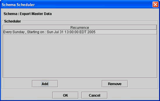

If you are the owner of a workflow, you can schedule an instance to start at a specific time or times. If you are not the owner, you cannot schedule it, although you can start it manually, as described in “Starting Workflow Instances”.
To schedule a workflow instance
If the workflow schema is not visible, use the drop-down menu and select the name of a schema group to which it belongs. Or select All.
Click Schedule in the row corresponding to that workflow.
The system displays the Schema Scheduler page, which lists all the times when Workflow Engine will start an instance of this schema.
Click Add.

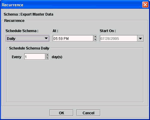

The system displays the following page.
In the Schedule Schema drop-down list, select the option that specifies how often to start an instance of this workflow:
Daily
Weekly
Monthly
Once
At Startup (This option launches the workflow whenever the Web server is started.)
Periodic (in this option, you can start a workflow at periodic intervals (measured in seconds, minutes, hours, days, weeks, months, or years. Note that you cannot choose the starting time.)
Depending on the choice you make here, the system displays additional scheduling options in the bottom part of the page.
In the rest of the page, finish specifying the schedule.
Click OK.
To unschedule a workflow instance
On the Workflow Management page, click Schedule in the row corresponding to that workflow.
The system displays the Schema Scheduler page. This page displays one row for each scheduling entry for this workflow.
Click the row corresponding to the scheduling entry you want to remove.
Click Remove.

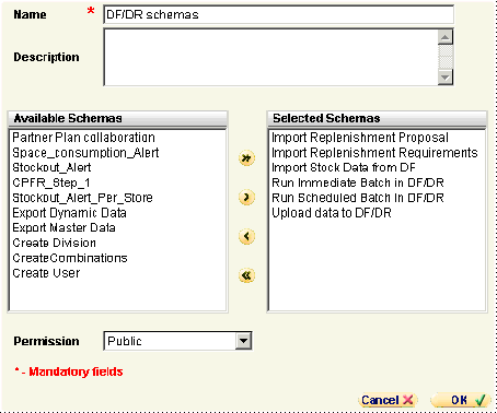

Schema groups affect only the display within the Workflow Manager. A schema can belong to multiple groups. Also, a schema group can be public (viewable by all users who log into Workflow Manager) or private (viewable only by you).
You can edit any schema group that you created; this has no effect on the workflow schemas themselves. You cannot edit schema groups created by other users.
To create or edit a schema group
On the Workflow Management page, do one of the following:
To create a new schema group, click New at the top of this page.
To edit a schema group, select the group from the drop-down list at the top of this page. Then click Modify.
The Workflow Manager displays the following page:
For Name, type a unique name for this schema group.
For Description, type an optional description.
Specify the workflow schemas to include in this group. To do so, move schemas from the left list to the right list.
For Permission, click Public or Private, depending on whether you want other users to be able to see this schema group.
Click .

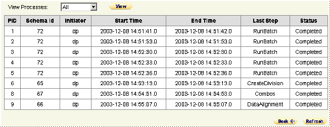

The workflow process log displays information on all the workflow instances that have run or that are running.
To view the process log
On the bottom of the Workflow Management page, click Process Log.
The Process Log page appears.
To filter process log entries
Select the required filter from the View Processes drop-down menu.
Click View.
The filtered processes are shown.

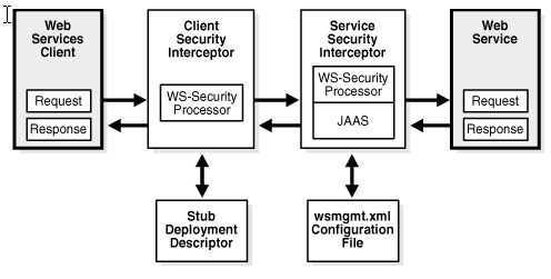

The following diagram illustrates the overall architecture of WS-Security architecture for the Oracle Web service stack.
To implement authentication of the webservices provided by Demantra via message-level security on a WebLogic server, a new Authentication Provider must be configured. This authenticator will authenticate any user invoking a web service exposed by Demantra application using the Demantra login methodology.

WebLogic 11g Web Services provides an implementation of Java Authentication and Authorization Service (JAAS) for J2EE applications that is fully integrated with J2EE declarative security. This allows Demantra to take advantage of the JAAS constructs such as principal-based security and pluggable login modules.
The JAAS Provider ensures secure access to and execution of Java applications, and integration of Java-based applications with WebLogic 11g.
Demantra has implemented a custom login module that is deployed in the OracleAS. The following procedure configures the application server to use this login module:
Connect to Oracle Enterprise Manager.
Deploy Demantra
Define Security Provider as follows:
Select – 'Administration' -> 'Security Providers' (by Go to Task) -> 'demantra' application -> edit (demantra) -> 'Change Security Provider'.
In the Drop Down of 'Security Provider Type', select 'Custom Security Provider'.
In the 'JAAS Login Module Class' field, set 'com.demantra.common.authentication.DemantraLoginModule'.
Click OK.
Note: This step can be done only through a deployment of the Demantra application
Return to the Home Page and select 'Web Service'.
If no web services are found, open the link of the WF Web Service: http://(ROOT)/demantra/MSC_WS_DEMANTRA_WORKFLOWSoapHttpPort
Then refresh the Enterprise Manager page.
Click on the link: MSC_WS_DEMANTRA_WORKFLOWSoapHttpPort.
Select 'Administration' -> 'Enable/Disable Features'
Move 'Security' to the 'Enabled Features' box and then click OK.
Make sure that the 'Security' Feature is marked as Enabled.
On the same page, select the 'Edit Configuration' icon of the 'Security' Feature, Press the 'Inbound Policies' button, and in the 'Authentication' tab, mark the checkbox 'Use Username/Password Authentication' and select 'Password Type' = 'Plain Text'. Click OK.
Test the Workflow Web Service by providing User Name & Password in the WS-Security section.
