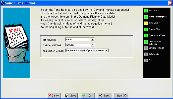

Demantra uses a base time resolution. All other time displayed in the system is an aggregation of this base time resolution. The default time of the Demand Management application is weekly beginning on Monday. There may be several business reasons to change this:
Starting your week on a different day.
Aggregating the week based on the ending day not the beginning day.
Daily or monthly base time.
To change the base time
Access the Business Modeler.
From the Data Model menu, choose Open Data Model.
Select the data model you want to modify and click next until the Time Bucket screen appears.
Complete the following fields:
Time Bucket
First Day of the Week
Aggregation Method
Note: The day and month time unit do not designate the first day of the period. Months are assumed to begin on the first and end on the last day of the Gregorian month.

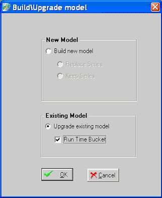

After your changes have been saved, the data model should be upgraded, not rebuilt using the Run Time Bucket option selected.
Note: If the time bucket is re-configured, the time aggregation set for all worksheets is modified to match the new time aggregation. A review of all used and embedded worksheets is strongly recommended.

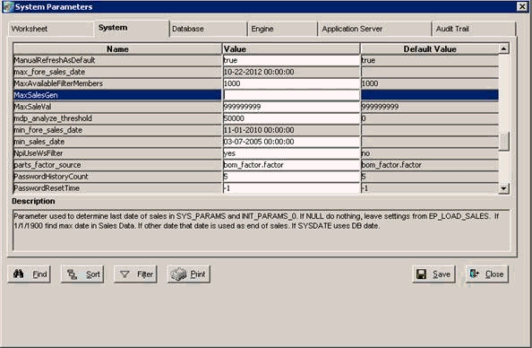

When loading future dates in the EP_LOAD process, it is important to populate a control parameter to determine how you would like the end of history populated. The control parameter can be found in the Business Modeler and is called MaxSalesGen.
Note: In order for MaxSalesGen to take effect you must run the EBS Full Download workflow.
Populating the MaxSalesGen parameter
From the Parameters menu choose System Parameter.
Click the System tab and scroll down until you find the MaxSalesGen parameter.
For the MaxSalesGen parameter, enter the value you want. Some considerations:
Null. Leaving the parameter blank causes the system to continue to behave as it does today. The last date loaded into the system is compared to the current last system date, and the latest of the two set is the last date of history. It is recommended in cases where only historical dates are being loaded.
Sysdate. Entering Sysdate as the parameter causes the last date of history to be based on the period containing today's date (date in the DB server). In a weekly system with weeks beginning Monday, if run on February 16, 2007, the last date of history is set to the previous Monday February 12, 2007. For a monthly system run on the same date, the end of history is set to February 1, 2007. This option is good for a production environment where the system date should match the current date while allowing future information to be loaded.
01-01-1900 00:00:00. Setting the parameter to this value sets the end of history to the last date in the sales_data table where the actual_quantity column>0. For very large systems, this could add time to loading availability. It is critical that the data used to drive the engine be stored in the actual_quantity column.
Any date other than 01-01-1900 00:00:00. Any other date will cause the last date of history to be based on the entered date. In a weekly system with weeks beginning Monday, if the date entered is January 16, 2007, the last date of history would be set to the previous Monday January 15, 2007. For a monthly system run with the same parameter setting, the end of history would be set to January 1, 2007. This option is ideal for testing systems where the desired end of history date does not match the executed date. This allows users full control on dates assigned as end of history and beginning of forecast.
Note: All dates must be entered in the MM-DD-YYY 00:00:00 format.
