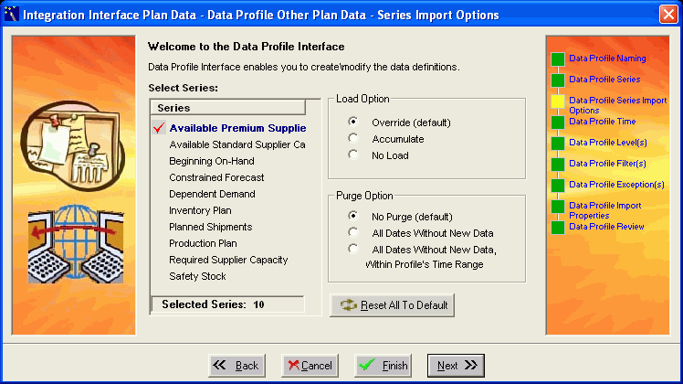

To load series and promotions, you use the Integration Interface Wizard, which provides a flexible way to import data into Demantra. (It also can be used to export data; see “Exporting Data”.)
Within the Integration Interface Wizard, you create integration interfaces. An integration interface consists of at least one of the following:
A data profile, which specifies how to import Demantra series, at the aggregation levels that you choose. You can import sales series, promotion series and other level series, but not matrix series.
A level profile, which specifies how to import promotions and their attributes.
Note: When you import promotions, any existing promotions are not changed.

When integrating data from a source instance into Demantra, there may be a need to modify an existing integration interface. For example: a pre-seeded integration profile is defined to import ten price lists by item. It is desired to use this pre-seeded integration profile, but to only import three of price lists. To accomplish this, the price list import workflow is triggered by collecting three price lists in APS Collections, modifying the integration interface such that the remaining seven price list series are set to 'No load' and 'No purge,' and then running the transfer step.
The API provides control over the following data profiles:
Load options:
Override
Accumulate, or
No load
Purge options:
No purge
All dates
All dates within a time range
Time definitions
Time Filter:
Relative
Fixed
Date Range:
From
Until
Notify the Application Server that you've modified Integration Profiles so it refreshes its cache.
API_NOTIFY_APS_INTEGRATION(ii_profile_id INT)
The following procedural APIs can be leveraged within the workflow to modify a pre-defined integration interface:
This is the API to modify an Integration Profile's Series Attributes:
API_MODIFY_INTEG_SERIES_ATTR (ii_profile_id INT, ii_series_id INT, ii_load_option INT, ii_purge_option INT)
Where,
ii_profile_id is transfer_query.id
ii_series_id is transfer_query_series.series_id (and also computed_fields.forecast_type_id)
ii_load_option is:
“0” Override
“1” Accumulate
“2” No Load
ii_purge_option is:
“0” No Purge
“1” Purge All
“2” Purge Within

The Integration Interface provides the ability to set purge and load options for each series. This controls whether the import integration profile overrides, accumulates, or purges (nulls out) the data for the specified integration profile date range.
The location of the Purge Data Before Import profile option within the integration profile wizard is shown:
Selected Series: This list box displays the selected series in the profile that were checked on the Data Profile Series page.
Load Option: The selected radio button indicates the load option for the series that is adjacent to the red check mark. The available load options are Override, Accumulate, or No Load. The default selection is Override.
Purge Option: The selected radio button indicates the purge option for the series that is adjacent to the red check mark. The default selection is No Purge.
Reset All: This button resets all series that appear in Selected Series list box to the default settings.
Note: To maintain backwards compatibility with old profiles, when upgrading:
Set the Load Option to Override, and
Set the Purge Option to No Purge.
| Setting | Description |
| Override | Override values on existing dates |
| Accumulate | Add values from the profile data to the values on existing dates |
| No load | Don't load data |
| No purge | Do not purge |
| Purge (null out ) all data on existing dates | Purge (null out ) all data on existing dates |
| Settings | Option Explanation | Results |
| Override, No Purge | Override values on existing dates. Do not purge. | Loads data for series in the date range of the profile. Overrides values on existing dates. Inserts the dates and values that are in the profile data, but not in the system. |
| Accumulate, No Purge | Add values from the profile data to the values on existing dates. Do not purge. | Loads data for series in the date range of the profile. Adds the values from the profile data to the values on existing dates. Inserts the dates and values that are not in the system. |
| No Load, No Purge | Don't load data. Do not purge. | Does nothing to this series. |
| Override, All Dates Without New Data, Within Profile's Time Range | Override values on existing dates. Purge (null out) data within profile dates. | Loads data for series in the date range of the profile. Overrides values on existing dates. Purges (null out) values for dates in the range of the profile that are not in the loading data. |
| Accumulate, All Dates Without New Data, Within Profile's Time Range | Add values from the profile data to the values on existing dates. Purge (null out) data within profile dates. | Loads data for series in the date range of the profile. Adds the values from the profile data to the values on existing dates. Purges (null out) values for dates in the range of the profile that are not in the loading data. |
| No Load, All Dates Without New Data, Within Profile's Time Range | Don't load data. Purge (null out) data within profile dates. | Purges (null out) all values in the system within the time range of the profile. |
| Override, All Dates Without New Data | Override values on existing dates. Purge (null out) data within profile dates. | Loads data for series in the date range of the profile. Overrides values on existing dates. Inserts the dates and values that are in the profile data, but not in the system. Purges (null out) values for all dates that are not in the loading data. |
| Accumulate, All Dates Without New Data | Add values from the profile data to the values on existing dates. Purge (null out) data within profile dates. | Loads data for series in the date range of the profile. Adds the values from the profile data to the values on existing dates. Inserts the dates and values that are not in the system. Purges (null out) values for all dates that are not in the loading data. |
| No Load, All Dates Without New Data | Don't load data. Purge (null out) data within profile dates. | Purges (null out) all values for all dates in the system. |
