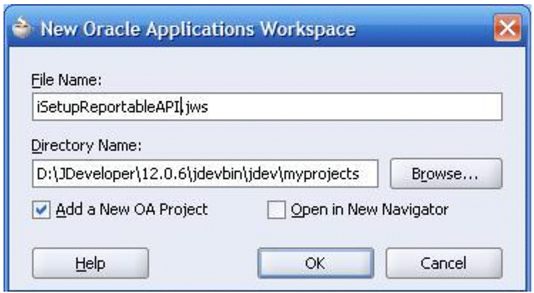

  6. Click on Applications Navigator tab > Right-click on Applications > New OA Workspace > Enter the workspace file name and directory name. Ensure that the "Add a new OA Project" box is checked.
    the picture is described in the document text
    Click OK.

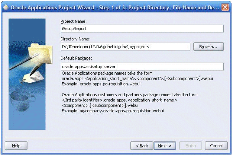

    • Step 1 of 3: Click on Next. Enter Project Name, Directory Name, and Default Package Name (for example, 'oracle.apps.az.isetup.server').

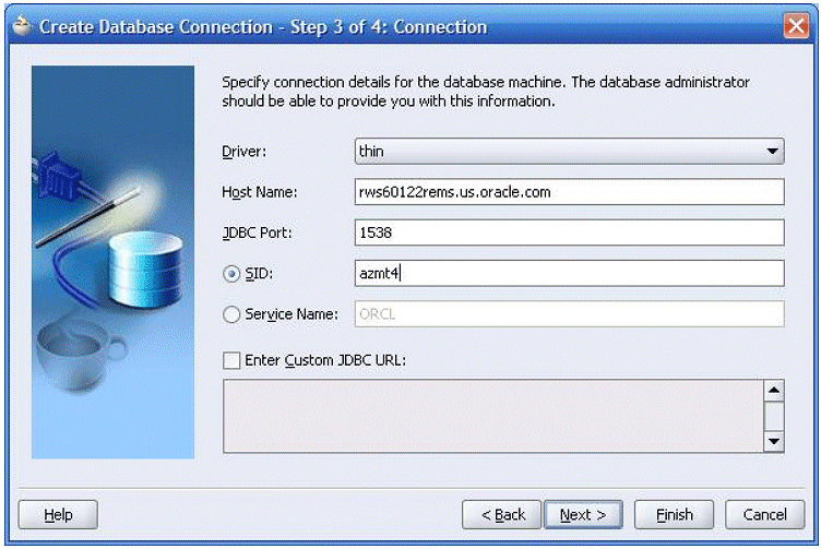

    • Step 3 of 4: Specify connection details of the database machine. Click Next.

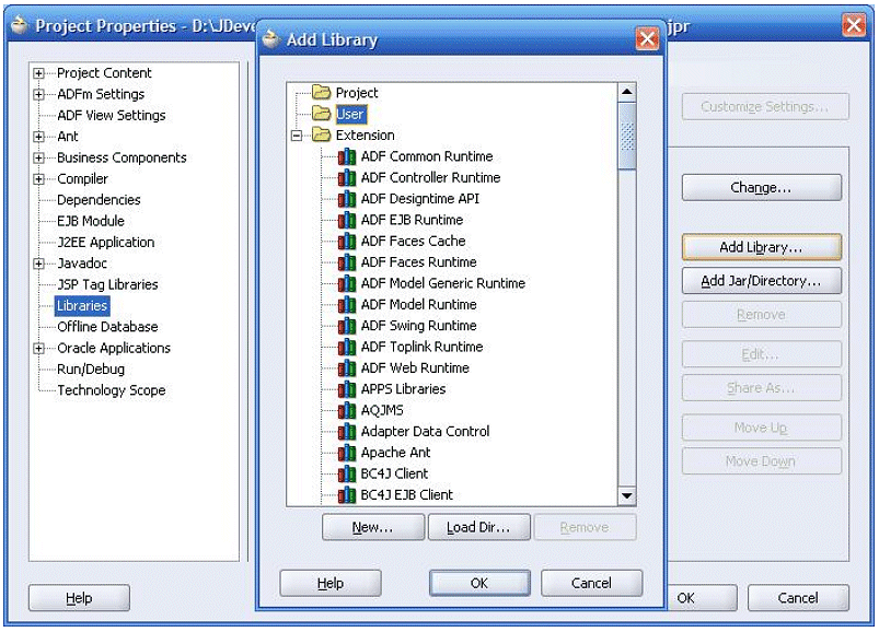

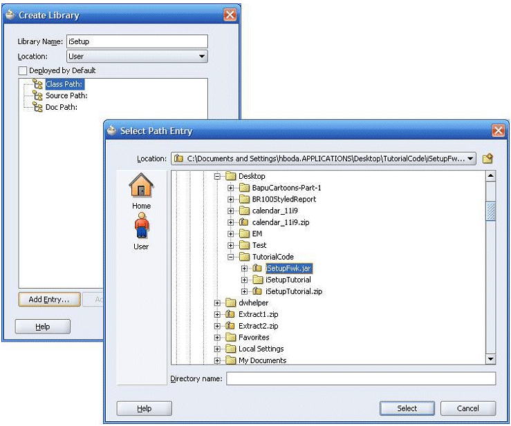

  11. Add a new library:
    • Click on New.
    • Enter Library Name using the navigation path iSetup > Select Class Path and click on Add Entry.
    • Browse to the directory where the iSetup Tutorial files have been unzipped (Refer to Step 3). Select iSetFwk.jar. Click OK in Create Library Dialog Pane.
  12. Click OK in Add Library Dialog Pane.
  13. Click OK in Project Properties Dialog Pane.

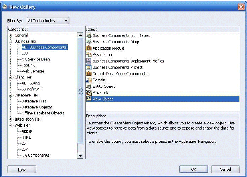

  1. Create View Object: Right-click on the Project and click on New > Select ADF Business Components: View Object.
  2. Click on OK. The "Create View Object Wizard" window opens.
  3. Click Next.

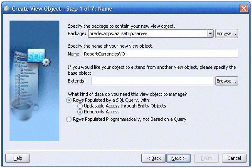

    • Step 1 of 7: Specify the package and name of the View Object.
      Select rows populated with SQL Query: with Read-only access radio button.
      Click Next.
      This tutorial is explained using Oracle iSetup, with the application short name 'az' ('AZ'). You can create under your custom PRODUCT_TOP. You can replace 'az' with your own product short code (application short name).
      For example, the Package Name can be given as oracle.apps.az.isetup.server and the View Object name as ReportCurrenciesVO.

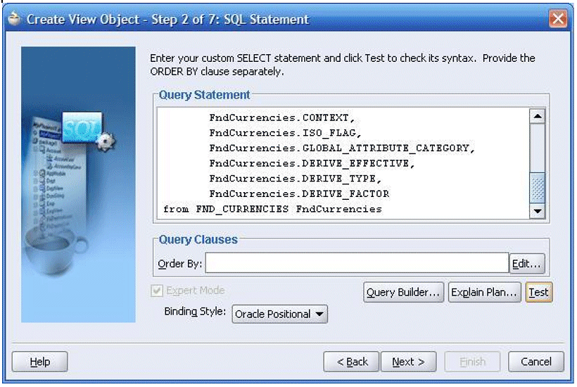

    • Step 2 of 7: Enter the SQL query (The query for the desired records that needs to come in the report. In this example, we used the FND_CURRENCIES table) in the Query Statement text box and select the binding style as Oracle Positional. Click Next.
      Note: An example query is

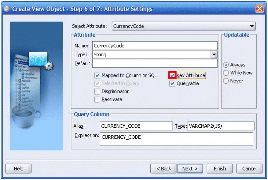

    • Click on Next, accepting the defaults, until you reach step 6 of 7: Attribute Settings.
    • Step 6 of 7: Now mark the unique key attributes (Unique keys are the developer keys of your API. Unique Keys should not contain any sequence IDs. Based on unique key columns, you can uniquely identify a record. In this example, the CurrencyCode view object attribute uniquely identifies a record.

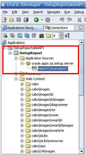

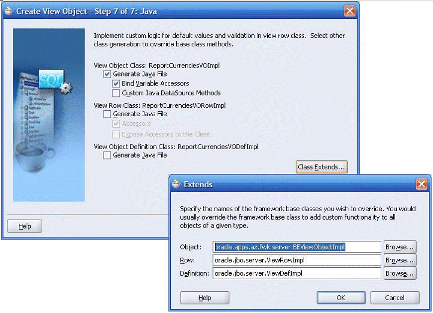

    • Step 7 of 7: Select Generate Java File for View Object Class: ReportCurrenciesVOImpl.
      Click on the Class Extends button. In the Against Object box, you need to override the base class as 'oracle.apps.az.fwk.server.BEViewObjectImpl'.
      Click OK on the Extends dialog pane and click Finish in Create View Object wizard.
    Note that the View Object is created with following two files:
    • ReportCurrenciesVO.xml
    • ReportCurrenciesVOImpl.java

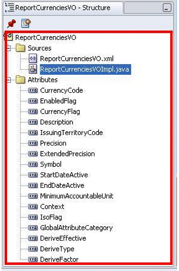

  5. Filtering attributes need to be marked if the iSetup Reportable API has to support filtering records. APIs are responsible for determining which filtering parameters are allowed and to which view object attributes that these filtering parameters map. In order to achieve these goals, the APIs need to register the filtering parameters by marking view object attributes as filtering parameters as shown below:

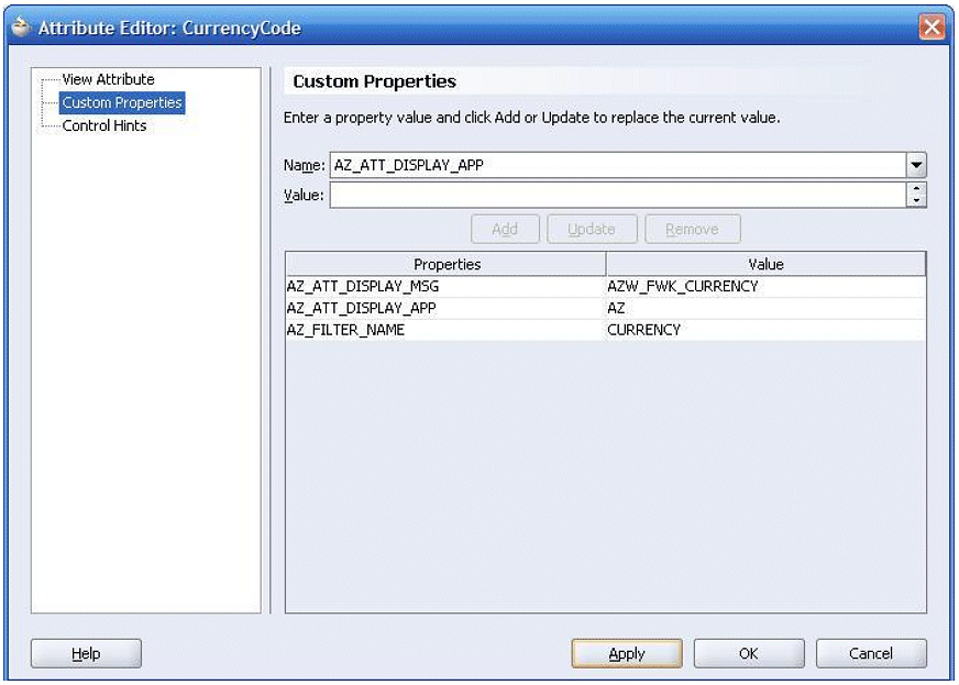

    For the attributes that need to be filtered on, the APIs need to add the following three properties
    • AZ_FILTER_NAME: a unique value within the view object. Make sure it's all-uppercase and has no spaces. This is a mandatory parameter if you wish to set filter on an attribute.
    • AZ_ATT_DISPLAY_MSG: The Oracle Application Object Library (FND) message name.
    • AZ_ATT_DISPLAY_APP: The application short name that corresponds to the FND message name.
    Optional properties are as follows:
    Properties AZ_ATT_DISPLAY_MSG and AZ_ATT_DISPLAY_APP are used to show the label of the filtering parameter in the iSetup Migration UI pages. These properties are optional. If you do not set the values for these properties, then the VO attribute name would be used as the display name.
    To set the above properties you need to follow following steps.
    In this example, attribute CurrencyCode of ReportCurrenciesVO is the filtering parameter.
    1. Select ReportCurrenciesVO in Applications Navigator of JDeveloper. In the Structure Pane, select and right-click on the CurrencyCode view object attribute and select 'Edit CurrencyCode'. Then select 'Custom Properties' in Attribute Editor wizard. For Name enter: AZ_FILTER_NAME and for Value enter: CURRENCY. Click on Add and Apply.
    2. Repeat the above procedure for the properties (Optional): AZ_ATT_DISPLAY_MSG and AZ_ATT_DISPLAY_APP. In this example the values are given as follows:
      • AZ_FILTER_NAME: CURRENCY
      • AZ_ATT_DISPLAY_MSG: AZW_FWK_CURRENCY
      • AZ_ATT_DISPLAY_APP: AZ
    3. After entering all the properties for filtering parameters, click OK.

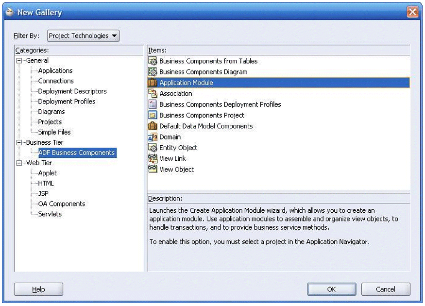

  1. Right-click on the project and click on New. Select ADF Business Components: Application Module.
  2. Click OK. The "Create Application Module" wizard opens. Click Next.

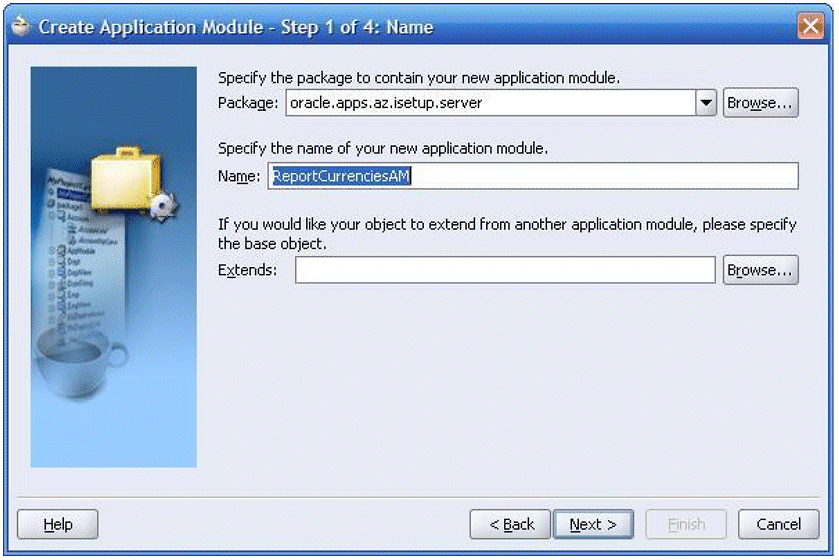

    • Step 1 of 4: Specify the package and name of the Application Module. Here the package name is given as 'oracle.apps.az.isetup.server' and the View Object name is given as 'ReportCurrenciesAM'.

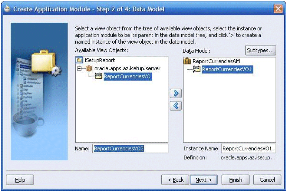

    • Step 2 of 4: Select ReportCurrenciesVO in the Available View Objects and add it to the data model. Click on Next.

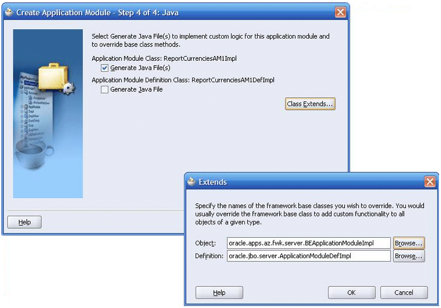

    • Select Application Module Class: ReportCurrenciesAMImpl > Generate Java File(s). Click on the Class Extends button. In the Against Object box you need to override the base class as 'oracle.apps.az.fwk.server.BEApplicationModuleImpl'. Click OK on the Extends dialog pane and click Finish in the Create Application Module wizard.

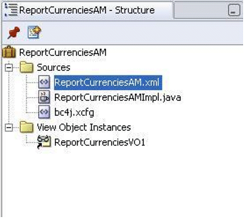

    • Note that the Application Module is created with following two files:
      • ReportCurrenciesAM.xml
      • ReportCurrenciesAMImpl.java

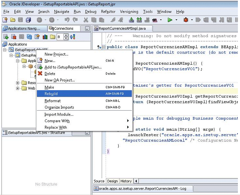

    • Now right-click on the workspace and select Rebuild. Ensure that there are no compilation errors.
    • Now your API supports the default export functionality, which is exporting all the records found for the defined view objects so that a report can be generated with the exported records.

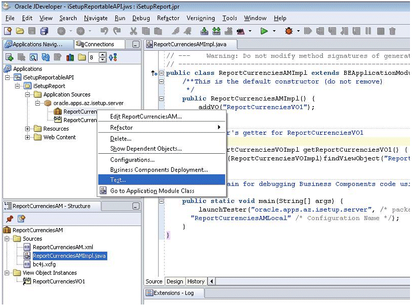

To Test the Interface in JDeveloper
  1. Right-click on ReportCurrenciesAM application module and select Test.

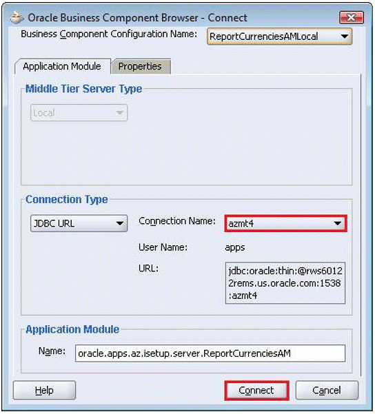

  2. The Oracle Business Component Browser opens. Select Connection Name to the instance on to which you need to test and click on Connect.
  3. A Java frame window ‘Oracle Business Component Browser’ opens up. Click on the View Object you need to test. In this example, we added ReportCurrenciesVO1 to the application module, so we would click on ReportCurrenciesVO1. All the records that need to be fetched with the SQL query will be returned.
  4. Click on File > Exit to close the Testing mode.
