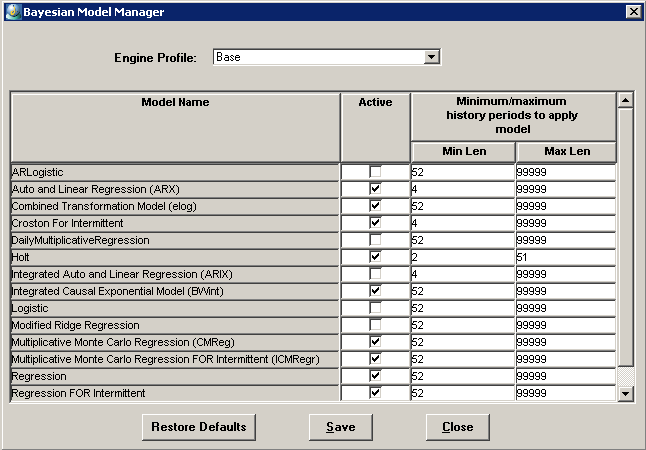

  1. Log onto the Business Modeler.
  2. Click Parameters > System Parameters. The System Parameters dialog box appears.
  3. Click the Engine tab.
    the picture is described in the document text
  4. From the Engine Profile drop-down, select the engine profile whose parameter settings you want to adjust.
  5. Find the parameter of interest. The dialog box provides find, sort, and filter capabilities to help you with this. See "Engine Parameters".
  6. To change the value of the parameter, click the Value field for that parameter. Type the new value or select a value from the drop-down menu.
  7. Click Save to save your changes to this profile.
  8. Click Close.

Enabling Engine Models Globally
Demantra provides a set of theoretical engine models that the Analytical Engine uses when it creates a forecast. Usually you do not make changes, but you can specify which models to use, as well as set basic parameters for each model.
Caution: Only advanced users should make these changes.
When the Analytical Engine runs, it may use a subset of these models on any particular combination. The engine tests each model for applicability; see "The Forecasting Process".
Note: Optimization can only use linear generalized coefficients
To enable models for the Analytical Engine to use
  2. Click Engine > Model Library.
    The following dialog box appears.
  3. Select the batch engine profile to be associated with the model library configurations.
  4. For each model, do the following:
    • To enable the Analytical Engine to use this model, make sure the Active check box is checked. For details on these models, see "Theoretical Engine Models". Note that not all models are supported with any given Analytical Engine.
    • The other two settings control the minimum and maximum number of non zero observations that a combination must have in order for the Analytical Engine to consider using this model for this combination. To specify these values, type integers into the Min Len and Max Len fields.
      Note: Min Len must be equal to or greater than the number of causal factors in the forecast, except for the HOLT and FCROST models, which do not use causal factors.
  5. Click Save and then click Close.
