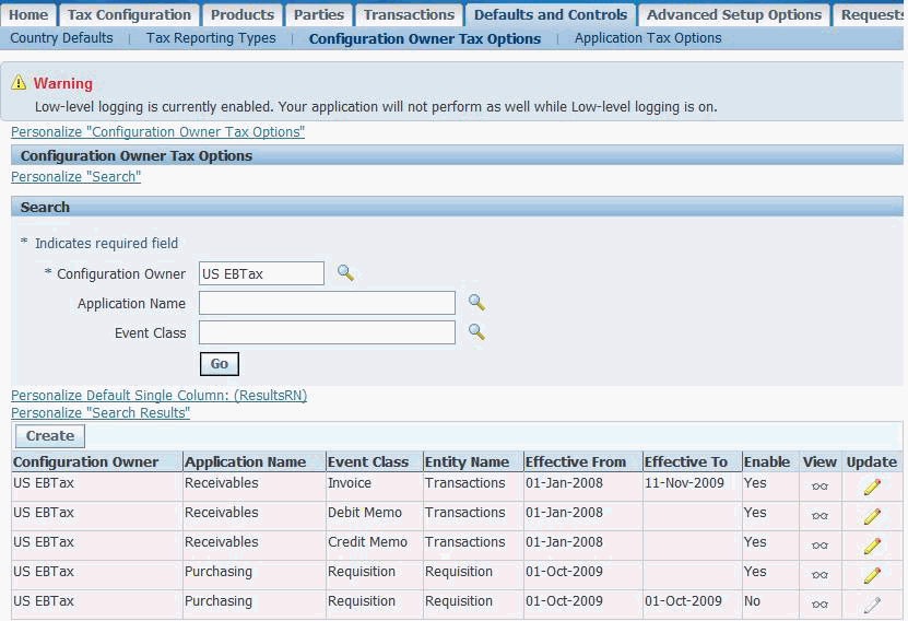

Configuration Owner Tax Options
Configuration Owner Tax Options are set in the Tax Managers responsibility under the defaults and controls tab. Query the operating unit (or legal entity) where you have associated your tax regime. If this is defined (optional setup), then verify the Allow tax Applicability check box is checked. Also ensure that you have the proper tax determination method selected.
Note: STCC is only for upgraded tax calculation logic.

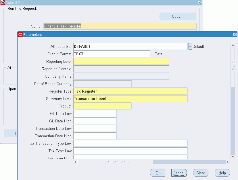

The following parameters have been organized into groups for this section. These groups are not necessarily reflective of the order that they appear when submitting the report.
Important: Run this report from the forms UI to avoid receiving the AR_SRS_LEDGER_FLEXFIELD has an incorrect validation type (P) error, which occurs if it is run from the Web UI.
Responsibility: Tax Managers
(N) Requests > Other > Requests > Run
Attribute Set
The Financial Tax Register is an RXi report that contains two predefined attribute sets. You can create additional custom attribute sets as needed by copying and editing them. The seeded attribute sets are:
Default: The Default attribute set contains all of the available attributes from the extract view. You can use this attribute set to create new attribute sets. There is no predefined layout. Running the report at this level with an output format of CSV is not recommended because the standard Excel workbook does not have enough columns. Choose HTML to see all fields.
TaxReg: The TAXREG attribute set can be used for Oracle Payables, Oracle Receivables, and Oracle General Ledger, or all products. The report contains the attributes most commonly included in Tax Registers. It does not include discount amounts for Oracle Receivables and Oracle General Ledger.
Note: The reporting level selected changes the attributes that appear. This means that distribution level attributes will not be displayed if the report is submitted at the transaction level. Similarly, some transaction level details are shown as null (blank) if the report is submitted at the distribution level.

Remove the columns that you desire (limit the columns to match the number available in your version of your spreadsheet solution if choosing CSV output).
Select Tools > Security and add the responsibilities permitted to access the attribute set.
Save.
Note: The attribute sets may only be visible from the forms based request submission.
Formatting Currency and Number Cells
To display tax amount like (XXX) instead of -XXX, you must define a format:
From Report eXchange Designer responsibility.
Double-click on Setup RXi. You can see the Attribute Set.
In the Report Name field enter RX-only: Financial Tax Register Report.
Navigate to Attribute Set field.
Go to the attribute set, which is used by the report.
In the right bottom region, click on Column Details.
Notice the Menu Bar Folder menu is disabled. If you place the cursor on any of field, the folder is enabled.
Select Folder > Show Field.
Select Currency Column. One more column is added that is Currency Column.
Navigate to any amount related field. For example, Taxable_amt in the Currency Column select.

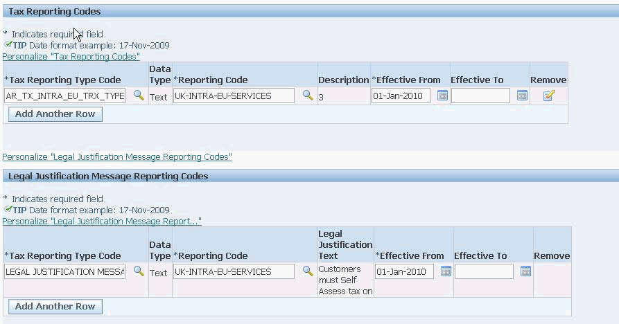

Associate Intra EU Transaction Type and Legal Justification Reporting Codes to Tax Rate Code
(N) > Tax Configuration > Tax Rates.
Enter the appropriate regime, configuration owner, tax and status information.
Specify tax rate code and percentage rate as zero (existing/upgraded tax rate code can also be updated).
(N) Rate Details > Tax Reporting Codes > Specify the Tax Reporting Type Code and Reporting Codes created for Intra EU Transaction Type in the preceding example (UK-INTRA-EU-SERVICES).
(N) Rate Details > Legal Justification Message Reporting Codes > Specify the Legal Justification Reporting Type Code and Reporting Codes created in preceding example ((UK-INTRA-EU-SERVICES).
Only one effective legal justification reporting type can be associated to a tax rate.
