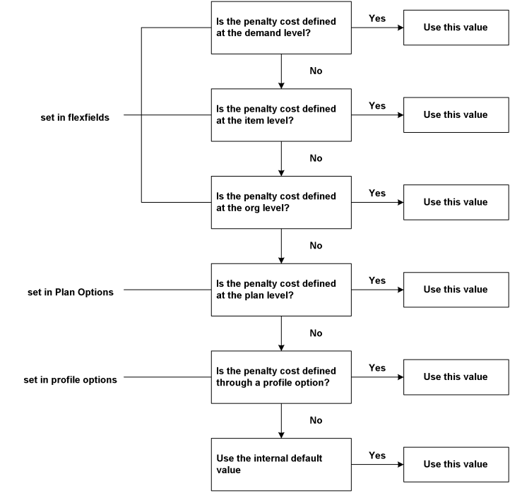

The following figure shows the hierarchy for Setting Penalty Factor for Late Demand.
Hierarchy for Setting Penalty Factor for Late Demand
If the data is not available at a given level, Oracle ASCP will check for available data at the next level in the hierarchy and so on.
From the Navigator, choose Supply Chain Planning > Forecast > Entries.
The Item Forecast Entries window appears.
Select a forecast.
Select the flexfield.
The MRP Forecast Dates window appears.
Enter the Late Forecasts Penalty factor.
For more information on these steps, please refer to the Oracle Inventory User's Guide.
From the Navigator, choose Inventory > Items > Master Items.
The Master Item window appears.
Click the Item field.
Select View menu > Find.
The Find Master Items window appears.
Enter a search string for the item in the Item field and click the Find button.
The Items window appears.
Enter the Late Demands Penalty factor.
From the Navigator, choose Inventory > Setup > Organizations > Parameters.
The Organization Parameters window appears.
A second Organization parameters window appears.
Select the Advanced Supply Chain Planner responsibility.
From the Navigator, choose Supply Chain Plan > Options.
Select a plan.
The Plan Options window appears.
Select the Optimization tab.
Enter the penalty factor in the Demand Lateness field.
Log in as the System Administrator.
From the Navigator, choose Profile > System.
The Find System Profile Values window appears.
Enter the profile name MSO: Penalty Cost Factor for Late Demands in the Profile field and click Find.
The System Profile Values window appears.
Enter the penalty factor in the Site column.

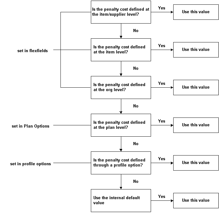

The following figure shows the hierarchy for Setting Penalty Factor for Exceeding Material Capacity.
Hierarchy for Setting Penalty Factor for Exceeding Material Capacity
If the data is not available at a given level, Oracle ASCP will check for available data at the next level in the hierarchy.
For more information on these steps, please refer to the Oracle Purchasing User Guide.
From the Navigator, choose Purchasing > Supply Base > Approved Supplier List.
Click Attributes.
The Supplier-Item Attributes window appears.
The Attributes window appears.
Enter the Material Over-Capacity Penalty factor.
Enter a search string for the item in the Item field and click Find.
A second Organization Parameters window appears.
Select a plan.
Enter the penalty factor in the Exceeding material capacity field.
Enter the profile name MSO: Penalty Cost Factor for Exceeding Material Capacity in the Profile field and click Find.

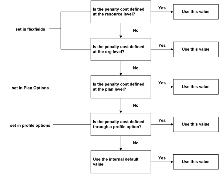

The following figure shows the hierarchy for Setting Penalty Factor for Exceeding Resource Capacity.
Hierarchy for Setting Penalty Factor for Exceeding Resource Capacity
From the Navigator, choose Bills of Material > Routings > Departments.
The Departments window appears.
Find a department.
Click Resources.
The Resources window appears.
The Department Resource Information window appears.
Enter the Resource Over-Capacity Penalty factor.
Select a plan.
Enter the penalty factor in the Exceeding resource capacity field.
Enter the profile name MSO: Penalty Cost Factor for Exceeding Resource Capacity in the Profile field and click Find.
