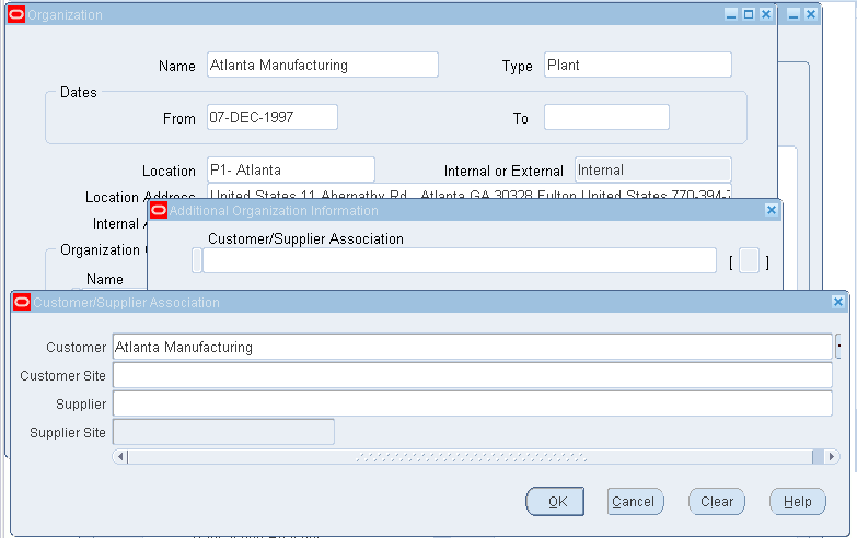

Create an external inventory organization to represent each customer's inventory stocking location. You must create inventory organization for each of the customer's stores or warehouses that you will use to manage inventory. Associate the inventory organization to the customer site to be replenished. You must ensure the association of the customer site to the inventory organization. Once the organization has been defined, you will create the VMI item in this organization.
The Customer/Supplier Association Window
For more information on setting up inventory organizations and associating them to customer sites, see "Setup Checklist" in Oracle Purchasing User's Guide.

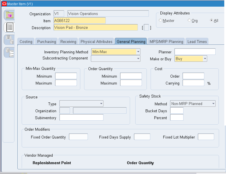

Define the item in the inventory organization created for the customer site. Provide order modifiers. For more information on defining VMI items see Defining Items in Oracle Inventory User's Guide.
VMI enable the item: Specify if the item will be VMI enabled in that organization using the general planning tab in the item master.
The Master Item Window
Release Authorization Required flag: Specify if manual intervention is required to create a sales order.
Value = None: Directs the system to create a sales order release to implement the suggested replenishment quantity without any user intervention.
Value = Supplier: Direct the system to create a replenishment quantity after the item planner approves the creation of a sales order release. The system notifies the item planner that his approval is required.
Value = Customer: Direct the system to create a sales order for the suggested replenishment quantity based on the approval of the customer, for which a notification is sent to the contact user at the customer site. Note that you must select the Consigned check box to enable customer consigned VMI. This is the default value that Collaborative Planning uses.
Replenishment point: Specify the replenishment point type:
Min-max based on quantity
Min-max based on days of supply
Reorder quantity selection: Specify how the reorder quantity should be calculated:
Maximum quantity in UOM
Maximum days of supply
Fixed order quantity
Auto-expire ASN: Specify whether the ASN should expire on the schedule arrival date.
Value = Yes: The system does not consider the ASN for the supply calculation.
Value = No: The system considers the ASN for supply calculation until a receipt is posted pegged to the ASN.
Select Forecast Type for Average Daily Demand Calculation: Select one of the following forecast type:
Order Forecast: Use an order forecast posted by the customer to calculate the average daily usage.
Sales Forecast: Use a sales forecast posted by the planner to calculate the average daily usage.
Historical Sales: Use historical sales data posted by the customer to calculate the average daily usage.
Window Days: Define this horizon in days in the Item screen. The system calculates the average daily demand across all the forecasts, if they exist, for a given customer site. The system assumes that if the customer provides different forecasts to individual supplier sites for the same customer site, the forecasts are global forecasts. The demand is aggregated across the different supplier sites and used in the average daily usage calculation.
Calendar setups: You define a calendar in Oracle Bills of Materials. A calendar is used to:
Calculate the release time fence (RTF).
Calculate the number of working days using the forecast horizon.
Note: The system uses the receiving calendar at the customer site on a prioritized basis. The manufacturing calendar for the customer organization is used only if the receiving calendar at the customer site is not available. Otherwise, Collaborative Planning uses the default system calendar.
For more information on General Planning tab in the Master Item window, see General Planning Attribute Group in Oracle Inventory User's Guide.

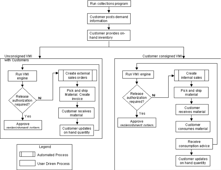

The customer facing VMI process consists of the following flavors:
Unconsigned VMI with Customers
Consigned VMI with Customers
The difference between these flavors is essentially based upon the ownership of the materials supplied to the customer site. The following table discusses the basic differences between these flavors.
| Unconsigned VMI with Customers | Consigned VMI with Customers |
| In this flavor, the customer owns the inventory as soon as it is received at the customer site. | In this flavor, the e-Business Suite owner (the company that owns and runs Oracle Collaborative Planning) owns the inventory, even after it has been received at the customer site. Ownership transfers from the e-Business Suite owner to customer only upon consumption of the inventory by the customer at the customer site. |
| In this flavor, material is shipped from the e-Business Suite owner to customer site using an external sales order. This allows invoicing of the customer by the e-Business Suite owner at that point. This is called "pay-on-receipt". | In this flavor, material is shipped from the e-Business Suite owner to the customer site using an internal sales order. After consuming the material, the customer posts a consumption advice transaction to Collaborative Planning. Collaborative Planning generates a "bill only with inventory consumption" external sales order that transfers the inventory ownership to the customer and permits the e-Business Suite owner to invoice the customer for the consumed inventory. Important: The supplier user must use the Supply Chain Collaboration Administrator Responsibility while uploading consumption advice. |
The following order types are used in customer-facing VMI (unconsigned and consigned):
| Order Type | Used by Unconsigned VMI with Customers | Used by Consigned VMI with Customers | Nature and Source |
| On-hand | Yes | Yes | Collected from the external customer organization |
| Sales orders | Yes | Yes |
| ASN | Yes | Yes | Derived from Shipping |
| Consumption advice | No | Yes | Posted by customer. Used to create regular sales orders. |
The initial steps for the process for VMI with customer are the same for unconsigned and customer-consigned VMI. For this reason, this section discusses the common steps first, followed by the steps specific for unconsigned VMI with customers and customer-consigned VMI.
Run collections program
Customer posts demand information
Collect past sales history from customer
Receive historical sales into Demand Planning
Publish sales forecast or order forecast to Collaborative Planning
Customer provides on-hand inventory
The process for Unconsigned VMI with Customers consists of the following steps:
Run VMI Engine
Retrieving ASN to calculate replenishment quantity
VMI Engine suggests unconsigned replenishment quantity
Send replenishment notifications
Create sales orders release
Send purchase order release notification
Ship materials to customer
Customer receives the shipment
Customer Updates On-hand
Run VMI Engine
Create replenishment orders
Ship material to customer site
Customer receives material
Customer posts consumption advice
Create sales orders

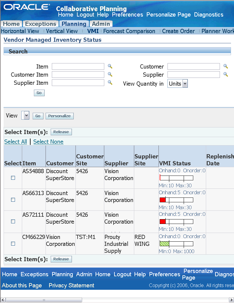

Customer provides on-hand inventory at each customer site on a daily or weekly basis directly into Collaborative Planning using XML or into the source using the user interface. If the customer posts the on-hand inventory through the user interface, you should collect the information into Collaborative Planning. Customers can post their on-hand inventory amount using either the unallocated on-hand or allocated on-hand order type. The VMI engine considers the total of all on-hand quantities (allocated and unallocated) for a given customer organization, if both are posted. For more information about uploading and collecting on-hand inventory, see Forecasting: On hand Inventory Visibility and Collaborative Inventory Visibility: Upload Unallocated On hand Inventory.

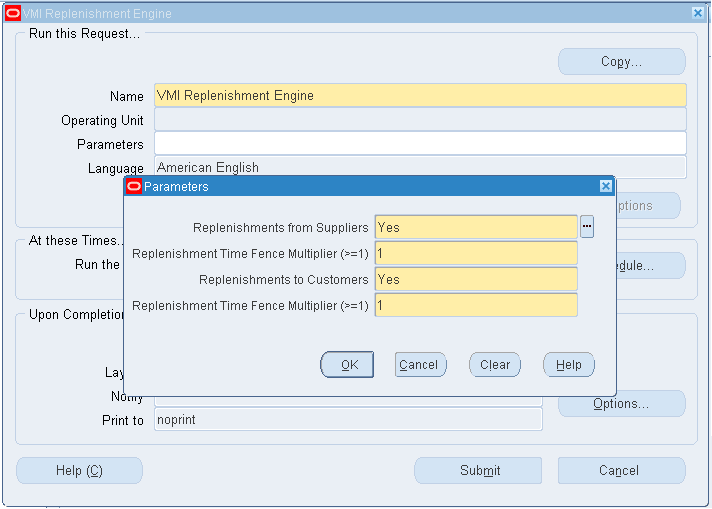

Submit a concurrent request to VMI Replenishment Engine.
The VMI Replenishment Engine generates the replenishment orders if the added value of the on-hand quantity, open orders, and goods in transit is less than the minimum replenishment quantity or the minimum replenishment days.
To launch the VMI Replenishment Engine,
Navigate to Advanced Planning Administrator Navigator window using seeded Advanced Planning Administrator responsibility.
Select the VMI Replenishment Engine option from the Other menu. The Parameters window for the VMI Replenishment Engine opens.
The Parameters Window for VMI Replenishment Engine
Select Yes in the Replenishments to Customers field.
To schedule the Vendor Managed Inventory Replenishment Engine, enter an RTF multiplier. A time fence multiplier of 1 (default) denotes that the VMI engine will calculate available inventory over one times the processing lead time of the vendor managed inventory item.
Click OK to submit a request to run the concurrent process.

Complete the following steps to access the Inventory Status window in Oracle Collaborative Planning:
From the Oracle Collaborative Planning home page , select the Planning tab.
Under the Planning tab, select VMI. The Vendor Managed Inventory Status window opens.
The following image depicts the Vendor Managed Inventory Status window:
The Vendor Managed Inventory Status Window
In the Vendor Managed Inventory Status window you can view the replenishment information. The following table describes pertinent columns you can view in the Vendor Managed Inventory Status window:
A row can represent either the supplier-facing VMI or customer-facing VMI type, as the system does not order the output rows based on the type of VMI. Therefore you must verify the customer and supplier before releasing a quantity.
Each row in the VMI screen is uniquely identified by item name, customer, customer site and supplier.
The columns that are not applicable for a certain VMI type remain empty for that VMI type. For example, the Requisition Quantity column for VMI with customers remains empty when the VMI engine runs for suppliers. Similarly, the Sales order Quantity column for VMI with suppliers remains empty when the VMI engine runs for customers.
For VMI with customers, the system assumes the supplier to be the OEM organization. To link an item to a customer, you should enable it in an organization while setting up the item in the source. This organization is considered to be the modeled organization mapped to a customer site. Since the item is owned by this organization, and it corresponds to a customer site, there is no supplier site for this item.
The VMI screen shows the "Source Organization" of the item as the supplier site for all rows when the VMI type is selected as customer facing VMI. This organization is defined in the item master form when the item is set up in the source.
The Release button enables you to release a replenishment order from the VMI screen.
| Column Name | Description |
| Supplier Site | Displays the name of the default shipping organization (Source Organization) for an item. |
| Replenishment Date | Date when replenishment is necessary. This value is calculated by adding item processing lead-time to the VMI Engine run date. The VMI Engine calculates this date based on the order's due date, depending upon the trading partner responsible for the delivery of materials. The arrival date on the sales order issued by the OEM organization represents the replenishment date. |
| Suggested Replenishment Quantity | Quantity Oracle Collaborative Planning recommends for replenishment. Note that, the quantity displayed in the Replenishment Quantity field is editable. |
| Replenishment Quantity | Quantity you wish to release. This number must be less than or equal to the suggested replenishment quantity, |
| In-process quantity | Quantity released for replenishment. This number is set to zero after each replenishment engine run. |
| Onhand Quantity | This is the sum of allocated and unallocated on-hand inventory quantity posted by the customer/customer site for the displayed item. |
| View Projected Available Balance | Displays an icon to display the VMI stock-out graph. The graph displays the

Submit a concurrent request to the VMI Replenishment Engine. The VMI Replenishment Engine generates the replenishment orders if the added value of the on-hand quantity, open orders, and goods in transit is less than the minimum replenishment quantity or the minimum replenishment days.
The VMI Engine automatically creates the sales orders based on the supplies (on-hand + open requisitions + open internal sales orders + goods in transit) falling within the horizon of system date and the pick to ship lead time for the item. While creating the sales orders, the Collaborative Planning system considers the arrival date as the key date for the sales order. Note that the VMI Engine assumes that the Request Date Type attribute is set to Arrival Date in Order Management if the OEM organization is responsible for managing inventory at customer sites. After the sales orders are created, the normal pick release and ship confirm programs run to fulfill the order.

Note that the internal requisition considers the external inventory organization associated to the customer's organization as the receiving organization. The default shipping organization is treated as the shipping organization. On the other hand the internal sales order considers the external inventory organization associated to the customer's organization as the receiving organization, while the source organization on the internal requisition is treated as the shipping organization.
