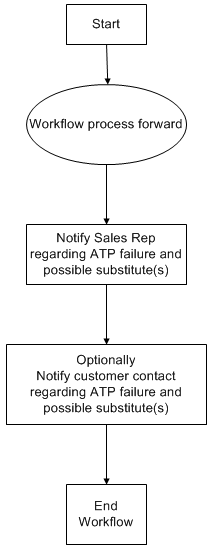

You must set profile MSC: Enable ATP Workflow to Yes if you want a notification to be sent to the appropriate people when an item substitution occurs during sales order scheduling.

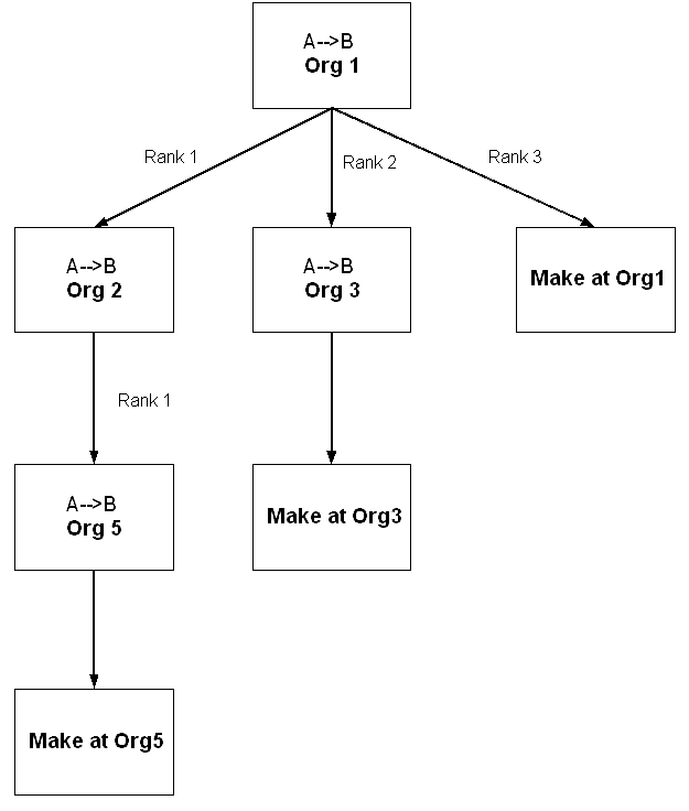

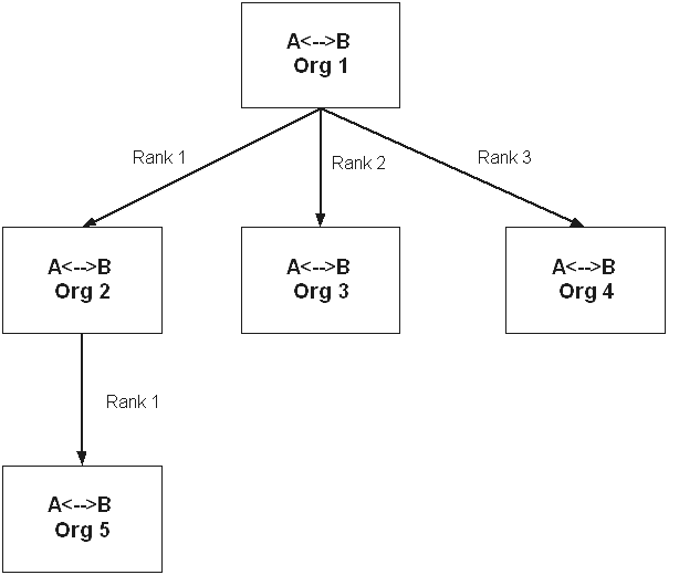

Oracle Global Order Promising uses a plan-level option selection to determine if breadth-first logic needs to be applied. The plan level option is the End Item Substitution check box on the Plan Options window. If you select this check box, you get the breadth-first logic for items that have end item substitutions defined.
The following diagram illustrates the breadth-first search concept. Items A and B are two substitute items and they are enabled in different organizations. The search for existing supply of a substitute proceeds breadth first, that is, Oracle Global Order Promising searches for Items A and B in Org 1, Org 2, Org 3, Org 4, and Org 5. If you have setup your substitution, ATP searches for each item individually. If Org 3 is set to Rank 1 and Org 2 to Rank 2, and then ATP follows this path: Org 1, Org 3, Org 2, Org 4, and Org 5 while evaluating existing on-hand and scheduled receipts for both native and substitute supplies across the supply chain.
Breadth-First Search Concept
The system assumes that both Items A and B have the same sourcing rule. If substitution needs to happen in all organizations and all organizations can swap materials freely, you can expect that substitute items are enabled in all relevant organizations and that sourcing rules exist for all substitute items to ship materials to all relevant organizations. If you do not establish sourcing rules, the substitution logic does not make any assumptions about sourcing rules.
Note: When end item substitution is not enabled, Oracle Global Order Promising performs a depth-first search. In the previous example, the order of this search would be:
Org 2 -> Org 5 -> Org 3 -> Org 4

Oracle Global Order Promising evaluates the supplies for Items A and B individually by using up all the on-hand and scheduled receipts prior to the request date. Later, it tries to produce the deficit by the request date.
If Oracle Global Order Promising is not successful in satisfying the request, it tries to project the availability date for the requested item as well as its substitutes by choosing the better date of:
Using scheduled receipts
Creating fresh supplies
Oracle Global Order Promising returns the item that gives the best available date.
Evaluating Item A Supply
On-hand + scheduled receipts available on request date:
| Total | Org 1 | Org 2 | Org 3 | Org 5 |
| 35 | 5 | 10 | 5 | 15 |
Note: The order of the organization columns in the previous table shows the order in which Oracle Global Order Promising looks for supplies.
Creating new supplies on request date:
Additional Information: Assume no capacity to create new supplies on the request date.
| Total | Org 5 | Org 3 | Org 1 |
| 0 | 0 | 0 | 0 |
Note: The order of the organization columns in the previous table shows the order in which Oracle Global Order Promising is trying to create new supplies.
Item A has a shortage of 65 on the request date. Oracle Global Order Promising looks forward to project a date when the shortage is available. The earliest date on which 65 units are available is Day 15. In the forward scenario, remember that : if multiple sources are available for the supply, then Oracle Global Order Promising uses the source that gives the best available date.
Oracle Global Order Promising computes the availability date as follows.
Org 1: Scheduled receipts (Day 26 = infinite time fence)
Org 1: Transfer from Org 2 (Day 21 = the better date of the two sources in Org 2)
Org 2: Scheduled receipts (Day 26 = infinite time fence)
Org 2: Transfer from Org 5 (Day 21 = the better date of the two sources in Org 5)
Org 5: Scheduled receipts (Day 25)
Org 5: Make (Day 21 = assume capacity to make 65 on Day 21)
Org 1: Transfer from Org 3 (Day 15 = the better date of the two sources in Org 3)
Org 3: Scheduled receipts (Day 26 = infinite time fence)
Org 3: Make (Day 15 = assume a capacity to make 65 on Day 15)
Org 1: Make (Day 16 = assume a capacity to make 65 on Day 16)
Of the four sources in Org 1, the transfer from Org 3 gives the best available date. Thus for Item A, Day 15 is the date that the requested quantity is available.
Evaluating Item B Supply
| 57 | 2 | 0 | 0 | 55 |
Assume there is no capacity to create new supplies on request date.
| 0 | 0 | 0 | 0 |
Note: The order of the organization columns in the previous table shows the order in which Oracle Global Order Promising creates new supplies.
Item B has a shortage of 43 on the request date. Oracle Global Order Promising looks forward to project a date when the shortage is available. The earliest date on which 43 units are available is Day 17. In the forward scenario, remember that if multiple sources are available for the supply, then Oracle Global Order Promising uses the source that gives the best available date.
Oracle Global Order Promising computes the availability date as follows:
Org 5: Scheduled receipts (Day 26 = infinite time fence)
Org 5: Make (Day 21 = assume a capacity to make 43 on Day 21)
Org 1: Transfer from Org 3 (Day 17 = the better date of the two sources in Org 3)
Org 3: Make (Day 17 = assume a capacity to make 43 on Day 17)
Org 1: Make (Day 17 = assume a capacity to make 43 on Day 17)
Of four sources in Org 1, the transfer from Org 3 gives the best available date. Thus for Item B, Day 17 is the date the requested quantity is available.
Based on the previous calculations, you can meet the requirement either by using Item A on Day 15, or item B on Day 17. Oracle Global Order Promising suggests Item A on Day 15 with the following details:
35 units of scheduled receipts of item A by the request date.
65 units of production of Item A in Org 3
Allocated ATP with Substitution

Allocated ATP In a Supply Chain
Consider a five organization supply chain setup:
Five-Organization Supply Chain
The substitution window is 2 days for Items A and B. In the following table, you get a request for 50 units of item A in tier T1 at Day 3 in the supply and demand picture of each organization. The infinite time fence date is set to Day 26. Assume no intransit lead time. The profile MSC: Choice of Item for Which to Create Supplies in Substitute Relationship is set to Follow Item Attributes, and the assumption is that supplies can be created for both items. The profile MSC: Allocation Method is set to Demand Priority.

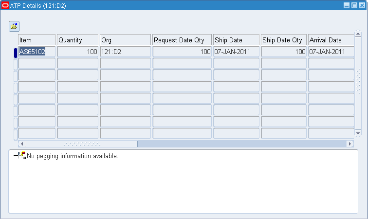

You can access the ATP Details window either by selecting Availability within the Oracle Order Management Sales Order Pad or by selecting ATP Details within the Oracle Global Order Promising ATP Criteria window.
When substitution happens, the ATP Details window shows the following information:
ATP Details Window
When you request 100 units of item A, you see the following details in the ATP Details window provided that Item B is substituted for Item A.
| Item | Org | UOM | Qty | Ship Date | Available Qty by Request Date | Original Item | Available Qty by ATP Date | Original Item Request Date Qty | Original Item ATP Date | Original Item ATP Date Qty |
| B | M1 | Ea. | 100 | Day 10 | 20 | A | 100 | 50 | Day 20 | 75 |
Table field descriptions:
All of the fields except Original Item, Original Item Request Date Qty, Original Item ATP Date, and Original Item ATP Date Qty will be for item B.
The Original Item column is the requested item.
The Original Item Request Date Quantity refers to the quantity of the original item available by request date.
The Original Item ATP Date provides you the date by which the entire requested quantity can be provided using original item.
The Original Item ATP Date Quantity provides you the quantity that is found on the Original Item ATP Date. The available quantity can be more than the requested quantity.

When the profile MSC: Enable ATP Workflow is set to Yes, a workflow notification is sent once the substitution occurs at the time of sales order scheduling. The following is a diagram depicting this workflow. The title for the workflow that is generated is Demand Satisfied Using End Item Substitution. This workflow is initiated upon scheduling of sales orders in Oracle Order Management.
Demand Satisfied Using End Item Substitution Workflow
The following details are shown in the workflow:
From Item: the item for which you received the demand; the exception is for this item.
Order Number: sales order number.
Line Number: sales order line number.
Original Quantity: requested quantity.
Substitute Item: the item to which the demand was transferred.
Organization: shipping organization.
Substituted Quantity: demand transferred quantity.

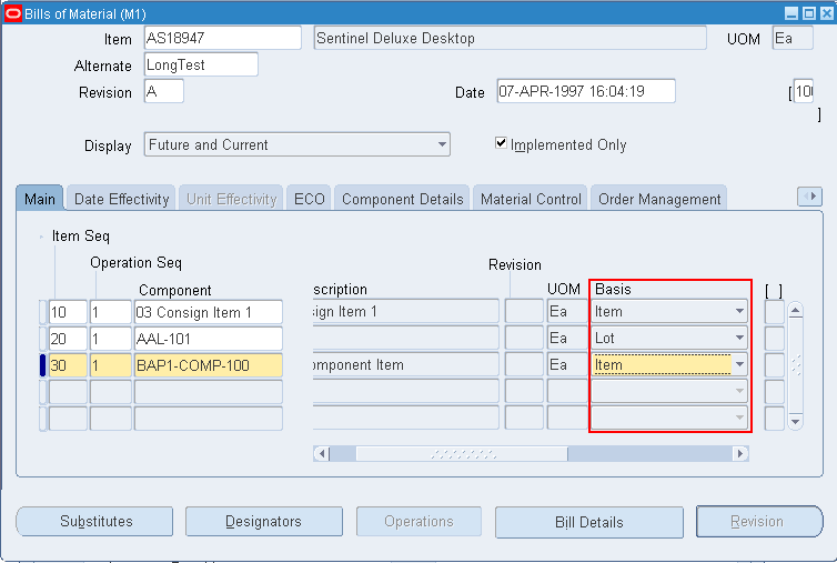

Material requirements typically scale proportionally in many manufacturing environments. For example, the number of hard disks required to build computers would scale proportionally to the requirements quantity. However, in certain scenarios you may want to include a certain component in fixed amount irrespective of the job quantity or yield. The support for lot-based material usage allows you to calculate material requirements based on materials used for a specific "lot" of end items or products.
Support for lot-based components allows the planner to calculate material requirements based on materials used per lot of the assembly. In a business environment, this is also referred to as requirement calculated on the basis of lot or batch. The following scenarios explain the concept in detail.
Assembly component is lot-based
In this scenario, you can include a fixed amount of material that will be used for the entire lot of the assembled products, irrespective of the size of the lot or batch. For example, you manufacture door panel assemblies, each of which consists of an injection molded panel and a lock. As part of the job start process, you will produce a fixed number of plastic door panels to cycle in the process so that you get the parameters set correctly. In such a scenario, you may want to include a certain weight of plastic resin that will be used in the job in the Bill of Materia,l irrespective of the job quantity.
Non-assembly component is lot-based
In this scenario you can include a fixed amount of material that will not be part of the yield, but will be used to initialize or activate the entire lot of end products, irrespective of the size of the lot or batch. For example, during the manufacture of DVDs, a test kit is issued to each job. The test kit contains a CD and instructions for initializing the process. A single test kit is used for the whole job.
All components in the assembly are lot-based
In this scenario, you can include a fixed amount or number of materials that can be used to test the effectiveness of the assembled lot or batch, irrespective of the size of the lot or batch. For example, during the manufacture of gas cylinders, your quality assurance procedures may require you to perform a destructive test on the first cylinder produced, regardless of the job quantity.
For a discrete manufacturing environment, the enhancement allows the planner to calculate the requirements for fixed amount of material used for a lot or batch of assembled products. For a process manufacturing environment, this enhancement allows the planner to calculate material requirements in a fixed amount or an amount expressed, expressed as an integer, for a lot or batch of assembled products. The following examples discuss lot-based material usage in discrete and process manufacturing environments.
Example: Discrete manufacturing Environment Scenario
Window locks are assembled using housing, screws, and cleaning solutions. The requirements of housing and screws will be directly proportionate to the requirement of window locks; therefore, they will be calculated onitem basis (that is, material requirement is measured in proportion to each unit of measure (UOM) of end item). The requirement of cleaning solution is, however, independent of the requirement for window locks and, thus, will be fixed, irrespective of the size of the lot of end items assembled.
The material requirement picture for this scenario is as follows:
| Component | UOM | Basis | Quantity per Assembly | Required for 500 Units of Assembly |
| Main Carriage | Each | Item | 1 | 500 |
| Screw | Each | Item | 2 | 1000 |
| Cleaning Solution | Gallon | Lot | 1 | 1 |

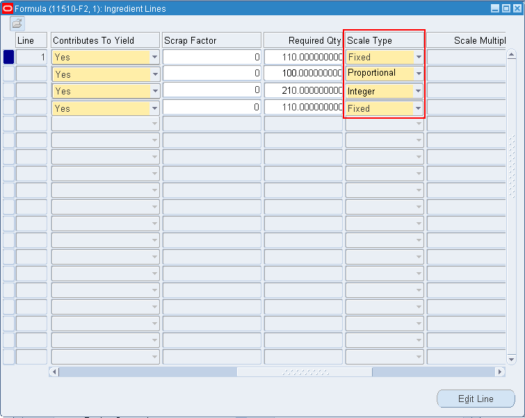

Example: Process Manufacturing Environment Scenario
Food supplements are produced using base dough, mixed berries, and lemon juice. The material requirements for mixed berry and base dough scale proportionally to the finished good requirement, whereas the lemon juice directly contributes to the yield of the finished product. Thus, the material requirement for lemon juice remains constant at 100 ounces, irrespective of the quantity of food supplement to be produced.

In the Bills of Material window, define:
Basis for calculating material requirement:In the Main tab of the Bills of Material,
Select Item for item-based calculation.
Select Lot for lot-based calculation.
Bills of Material Window
Scaling type: In the Formula window for the Ingredient Lines, select the scaling type in the Scaling Type drop-down list.
Formula for Ingredient Lines Window

The results of the lot-based material usage functionality can be reviewed in the ATP details screen.

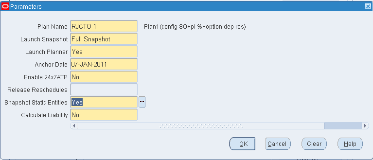

The Parameters window appears.
Parameters Window
Set Enable Continual ATP to Yes.
Click OK.
In the Launch SCP Plan window, click Submit.

| CTP Material | Component usage-Item, lot, Integer (OPM) | Only Item based component usage will be supported |

| CTP Material | OPM-Formula and Recipe | Not supported since Rapid Planning does not support OPM |
