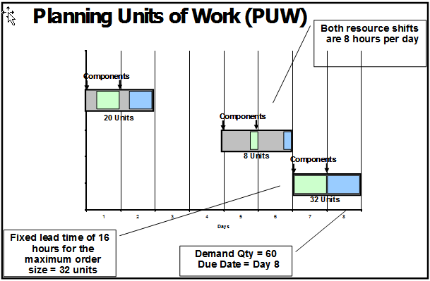

Plans around material, resource, and supplier resource constraints using planning unit of work.
It does not use compression days.

Default Order Sizing and Planning Unit of Work

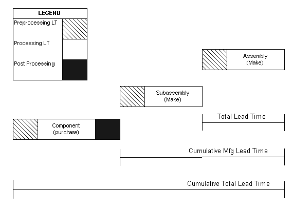

Cumulative Manufacturing: For make items, the time required to make the item if you have all of the buy items in inventory and have to make all subassemblies and the item itself.
Cumulative Total: For make items, the time required to make the item if you have to purchase all of the buy items, make all subassemblies, and make the item itself.

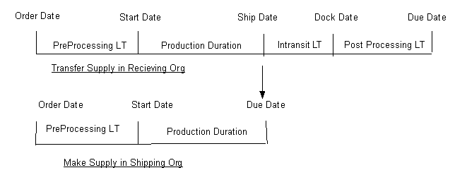

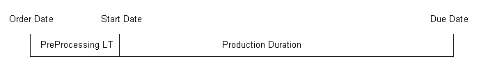

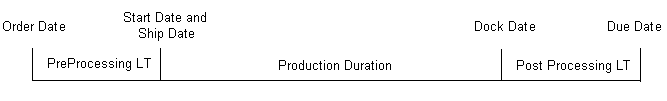

The lead-times define dates that are associated with planned orders and scheduled receipts for these items:
Order date: The beginning of Preprocessing the date you should begin the processing to release the order.
Start date: The end of Preprocessing and beginning of Processing; the date you, your supplier, or your ship from facility should begin work on the order.
Dock date: The end of Processing and the beginning of Postprocessing. For buy and transfer orders, the date that the material should be on your receiving dock. For make orders, the date that you should finish the operations. The supply of a by-product and a coproduct is ready for downstream consumption on the dock date.
Due date: The end of Postprocessing and the date that the material should be in your inventory. For make orders, put the on-hand on hold to account for the post processing lead time.

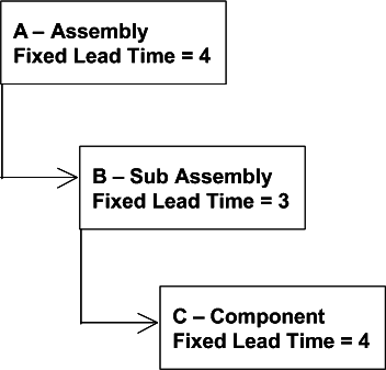

Fixed: Oracle Bills of Material concurrent process Calculate Manufacturing Lead Time calculates this time and update your manual entry for make items. It sums the values in field Usage for lot-based, scheduled resources.
Variable: Oracle Bills of Material concurrent process Calculate Manufacturing Lead Times calculates this time and update your manual entry for make items. It sums the values in field Usage for item-based, scheduled resources.
Processing: The Oracle Bills of Material lead-time concurrent process Calculate Manufacturing Lead Time calculates this time and replaces your manual entry for make items. It uses calculation Fixed + (Variable * Lead Time Lot Size); if Lead Time Lot Size does not have a value, it uses 1.
Cumulative Manufacturing: The Oracle Bills of Material lead-time concurrent processes Calculate Cumulative Lead Time and Rollup Cumulative Lead Time calculates this time and replace your manual entry. For an assembly, they take each component's cumulative lead-time and subtract its operation lead-time offset in the assembly's routing. Then, they take the manufacturing lead-time of the assembly and add the largest adjusted cumulative manufacturing lead-time of its components.
Cumulative Total: The Oracle Bills of Material lead-time concurrent processes Calculate Cumulative Lead Time and Rollup Cumulative Lead Time calculate this time and replace your manual entry. For an assembly, they take each component's cumulative lead-time and subtract its operation lead-time offset in the assembly's routing. Then, they take the manufacturing lead-time of the assembly, add the largest adjusted cumulative manufacturing lead-time of its components, and add the longest buy part lead-time of its components.
Decimal lead-time quantities denote times less then one day and are the result of the lead-time divided by 24 hours.
For more information, see Oracle Bills of Material User's Guide.

The planning engine does not use Cumulative Manufacturing and Cumulative Total values. You may see them in lists of values when you are entering lead-times, for example, item attribute Planning Time Fence.
Total lead-time is not an item attribute. The planning process calculates it in unconstrained plans to determine an order's Order Date. It:
Begins with the order's Due Date
Calculates total lead-time for the order as item Fixed + (Variable * Order quantity)
Adds Preprocessing to calculate the order's Order Date
The Calculate Manufacturing Lead-time concurrent process uses the same general calculation for Processing as the planning process uses for Total Lead-time. The Calculate Manufacturing Lead-time concurrent process uses item attribute Lead-time Lot Size to calculate item attribute Processing. The planning process uses actual order quantity to calculate the processing time for a specific planned order or scheduled receipt.
This diagram shows the relative use of Total Lead-time, Cumulative Manufacturing, and Cumulative Total.
Calculations of Cumulative Lead-time Attributes

The planning process takes into account the actual requirement date and the lead-times for calculating the planned order demand due dates. This provides more accurate lead-time offsets in aggregate planning time buckets.
It allows you to plan at aggregate time bucket levels like periods and weeks. It provides you easy identification of aggregate supply/demand mismatches and helps you make strategic decisions related to equipment and labor acquisition, sourcing etc. without generating needless details.
The planning process calculates the planned order demand due dates for dependent demands based on the actual requirement date with respect to lead-time. It saves the calculated requirement date based on the lead-time value for subsequent calculation.
Then, it aligns all dates to the ends of time buckets. You can get more accurate dates by first performing dependent demand explosion followed by alignment.

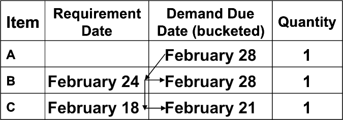

Example
Consider an organization with an assembly A, which has components B and C.
Assembly
The quantity per assembly for components B and C is 1.
The lead-time for assembly A = 4
The lead-time for sub-assembly B = 3
The lead-time for component C = 4
The organization follows a weekly planning bucket and working days are Monday through Friday.
An order quantity of 1 is placed for item A on Friday February 28.
The planning process generates the following planned order demands:
Planned Order Demand Due Date Calculation
Explanation:
Calculated requirement date for B
= Demand Due Date for A - LT
= February 28 - 4 days
= February 24 (Monday)
Demand Due Date for B
= Calculated requirement date for B after bucketing into planning bucket
= February 28 (weekly demands are bucketed into Friday)
Calculated requirement date for C
= Calculated requirement for B - LT
= February 24 - 4 days
= February 18 (Monday)
Demand Due Date for C
= Calculated requirement date for C after bucketing into planning bucket
= February 21 (weekly demands are bucketed into Friday)

This diagram shows dates calculated for manufacturing supplies.
Dates Calculated for Manufacturing Supplies
The planning process calculates the component due dates of a manufacturing supply order according to your setting of the plan option Material Scheduling Method.
For value Order Start Date, the component due date is the supply Start Date.
For value Operation Start Date:
Unconstrained plans: The planning process determines the operation that uses the component. It begins with the supply Start Date and increases it by lead-time % of that operation.
Constrained plans: Operation Start Date for the operation which uses it
If the item of the purchased supply has an Approved Supplier List, the planning process uses:
You can view Approved Supplier List planning attributes among the items information.
The planning process uses work days from the receiving organization calendar to calculate dates for purchased supplies, unless otherwise indicated.
Need by Date: Date that the material is required to satisfy demand.
Unconstrained plans: Need by Date
Constrained plans: The available date of the supply by forward scheduling
Unconstrained plans: Due Date - Postprocessing
Constrained plans: The latest delivery day for which the capacity is available and the material is needed
If the purchased supply item has an Approved Supplier List delivery calendar: The planning process verifies that the Suggested Dock Date is a work day on the delivery calendar. If it is not, the planning solver changes Suggested Due Date to the next earliest working day of the delivery calendar.
Suggested Ship Date: Dock Date - Production duration
If the purchased supply item has an Approved Supplier List Supplier Processing lead-time: Approved Supplier List Supplier Processing lead-time
If the purchased supply item does not have an Approved Supplier List Supplier Processing lead-time: Item attribute Processing
Suggested Start Date: Ship Date
Suggested Order Date: Start Date - Preprocessing. For a scheduled receipt, this field displays the date the date that it was created. For collected information, purchase order create date. The planning process calculates this date using the organization manufacturing calendar.
This diagram shows the calculations for purchased supplies.
Calculated Dates for Purchased Supplies
The planning process uses work days from the receiving organization calendar and shipping organization calendar to calculate dates for transfer supplies.
Need By Date (receiving organization calendar): Date material is required to satisfy demand.
Demand Due Date (receiving organization calendar):
Unconstrained plans: Need By Date
Constrained plans: Forward scheduling from the constraint.
Suggested Dock Date (receiving organization calendar): Due Date - Postprocessing
Suggested Ship Date (shipping organization calendar):
Unconstrained plans: Dock Date - Intransit Time
Constrained plans: Dock Date - Intransit Time, considering constrained transportation duration. The planning process considers transportation constraint maximum transfer quantity per day
Intransit Time is calendar days.
Suggested Start Date (shipping organization calendar):
Unconstrained plans: Ship Date - Processing
Constrained plans: Ship Date. The planning process does not consider a build time because the supply may be on-hand.
Suggested Order Date (receiving organization calendar):
Unconstrained plans: Planned order Start Date - Preprocessing
Constrained plans: Ship date in the receiving organization, if the shipping organization is a planned organization. The constrained plan uses material and resource constraints in the shipping organization.
This diagram shows calculated dates for transfer supplies in an unconstrained plan. The planning process calculates production duration differently for the source organization and the destination organizations; therefore, the dates in your plan may not line up as accurately as they appear in this diagram. If material is scheduled inside of these lead-times, planners can determine what action to take on the compression messages.
Calculated Dates for Transfer Supplies, Unconstrained Plan
This diagram shows that, in constrained plans, Need By Date and Demand Due Date in the shipping organization should be the same as planned order Ship Date in the shipping organization.
Calculated Dates for Transfer Supplies, Constrained Plan

This example shows how the planning solver consumes resources with daily buckets.
Resource availability:
Resource A: 8 hours per day
Resource B: 8 hours per day
Routing:
Operation 1: Uses resource A; resource requirement = 0.25 hour
Operation 2: Uses resource B; resource requirement = 0.25 hour
Lead time = 0.5 hour [0.25 + 0.25]
Planning unit of work = 16 hours
Planning unit of work order size = 32 [16 / 0.5], you can produce 32 units in 16 hours
For any planned order quantity from 1 to 32 units, total lead time = 16 hours
Operation 1 lead time = 8 hours
Operation 2 lead time = 8 hours
Demand
Quantity: 60 units
Due date: Day 8
This diagram shows that the planning solver schedules these planned orders:
Quantity = 20 units, days 1 and 2, lead time = 16 hours
Quantity = 8 units, days 5 and 6, lead time = 16 hours
Quantity = 32 units, days 7 and 8, lead time = 16 hours
For the planned order for quantity 32, the planning solver could schedule the operations on the same day:
Day 8: Operation 1, 8 hours consumed [32 * 0.25]
Day 8: Operation 2, 8 hours consumed
For the planned order for quantity 32, the planning solver could schedule the operations on different contiguous days:
Day 7: Operation 1, 8 hours consumed
For the planned order for quantity 32, the planning solver could schedule the operations on different non-contiguous days:
Day 6: Operation 1. 8 hours consumed
For the planned order for quantity 4, the planning solver could schedule the operations on the same day:
Day 8: Operation 1, 1 hour consumed [4 * 0.25]
Day 8: Operation 2, 1 hour consumed
