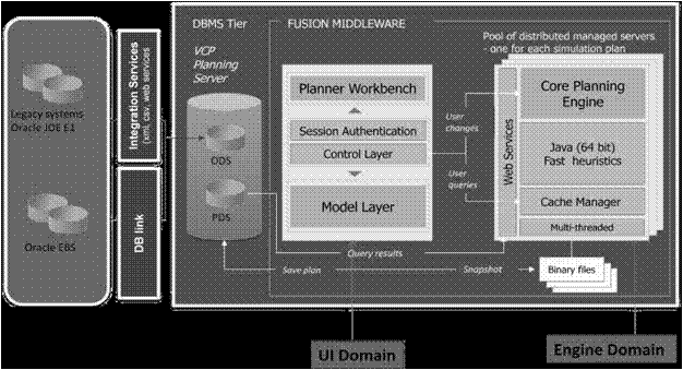

This graphic shows the Rapid Planning engine.
You deploy Rapid Planning in two domains of the WebLogic Server:
User interface: ADF components, for example faces and business components.
Engine: Multiple managed servers that you can scale to handle as many plans as you need.
They communicate using web services.
Rapid Planning stores completed plans as binary files in the WebLogic Server. When you close a plan, the binary files remain. When you re-open a plan, Rapid Planning loads the data into the user interface.
You request Rapid Planning to save completed plans to the database. Use the Save Plan action.
When you save the plan, Rapid Planning selectively flushes records into the database. For example, it flushes the records from the Supply/Demand view that display in the view to table msc_supplies. The Cache Manager of the Rapid Planning solver eliminates duplicates in the database.
