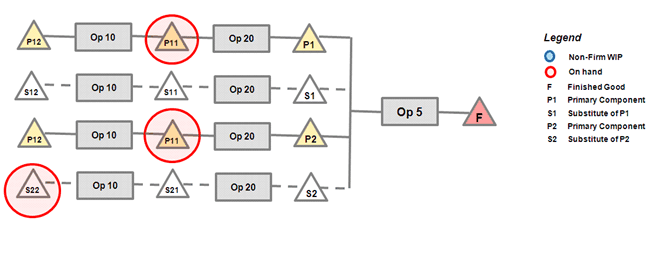

Applies safety stock lead time when scheduling components that are MRP Planned and have a safety stock percent
Schedules using safety stock lead time of the end item substituted and the substitute components

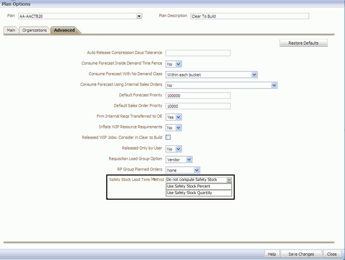

To calculate safety stock, there is a new plan option, Safety Stock Lead Time Method. This plan option has three possible settings:
Do not compute safety stock
User Safety Stock Percent
Use Safety Stock Quantity
To calculate safety stock using quantity, this plan options must be set to Use Safety Stock Quantity.

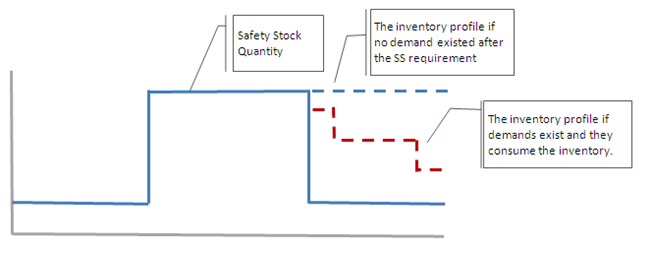

Planning safety stock, based on quantity, starts by planning all safety stock demands across the supply chain prior to planning all other real demands. This allows the Rapid Planning engine to consume any transient safety stock by demands that occur after the fall in the safety stock level. This logic ensures that there will be no excess inventory due to transient safety stocks. The diagram below and the example that follows illustrate this behavior:
Example:
Lead time = 5 days
| D1 | D2 | D3 | D4 | D5 | |
| Sales Orders | 10 | ||||
| Safety Stock | 20 | 20 | 20 | 20 | 20 |
| Onhand | 20 | ||||
| Planned Order | 10 | ||||
| Available (excluding Safety Stock Quantity) | 0 | 0 | 0 | -10 | 0 |
| Available (including Safety Stock Quantity) | 20 | 20 | 20 | 20 | 20 |

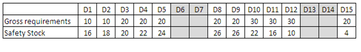

a. Calculate the daily gross requirements for every item in the supply chain. Daily gross requirements is the independent demand + dependent demand.
b. For every day, Day-n, calculate the sum of gross requirements for the safety stock demand window. Note that all days are working days based on the organization's manufacturing calendar. The demand window is derived as follows:
Start Date of the window = Day-n + m days
where m = Safety Stock Bucket Start Offset Days. This is based on a new profile option, MSC: Safety Stock Bucket Start Offset Days. This profile option is also available as a plan option.
Both Day n and m days are working days based on the organization's manufacturing calendar.
The start date of the safety stock bucket is offset from the current day. This allows Rapid Planning to ignore the impacts of high near term demand which may occur due to high backlog demand.
End Date of the window = Start Date of the window + n days
where n = Safety Stock Bucket Days (Item Attribute)
c. The bucket days serve as a rolling window, based on working days in the organization manufacturing calendar.
Safety stock is (Sum of gross requirements for Bucket Days working days * Percent) / (100 * Bucket Days).
Calculate safety stock as follows where:
Working week = 5 days
Bucket Days = 5
Safety Stock Percent = 100
Note: Safety stock is not calculated on non-working days.

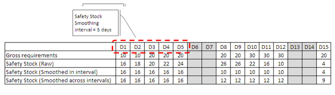

Safety stock on D1 = (Average daily Gross Requirements in bucket days from D1) *(SS % / 100)
= [ (10 + 10 + 20 + 20 + 20) / 5 ] * 1.0
= 16
Safety stock on D21 = (Average daily Gross Requirements in bucket days from D1) * (SS % / 100)
= [ (10 + 20 + 20 + 20 + 20) / 5] * 1.0
= 18
and so on.
Because Rapid Planning is a day-level planning tool, the safety stock level is a target, which is satisfied by the end of the day.

For Rapid Planning plans, if you want to account for the variability in demand and lead times in their supply chain, you can specify any Inventory Optimization Plan in the demand schedules area of Plan Options. For such items, the Safety Stock Method = MRP Planned % and will be part of the Inventory Optimization plan.
A Rapid Planning plan can be made up of a combination of items from any of the following groups:
MRP Planned%
Some of the items have their safety stocks calculated in an Inventory Plan (demand schedule)
Some of the items have their safety stocks calculated in Oracle Rapid Planning
If an item of this category (SS Method = MRP Planned %) is coming from an Inventory Optimization plan as a demand schedule , then the IO generated safety stock takes precedence and the other safety stock attributes, that is safety stock percent, are not considered. Rapid Planning does not calculate the safety stock for that item.
Non-MRP Planned
Some of the items have user-defined safety stock quantities.
Some of the items have safety stock quantities generated in Oracle Inventory.
Plan Option for Safety Stock Planning
The current plan option in the advanced options section, Safety Stock Lead Time Method, which configures safety stock planning method, is changed to Safety Stock Planning Method. It has the following values:
Do not plan Safety Stock
Use Safety Stock Quantities
Use Safety Stock Lead Time from Safety Stock Percent
There will no longer be Safety Stock Lead Time using Safety Stock.
Safety Stock Smoothing
In some cases, you may want to reduce the fluctuations in safety stock in the plan but do not want to directly use the raw safety stock numbers that come out of either of the above mechanisms such as an IO plan, generated in Oracle Inventory or user-defined. The following profile options are available so you can control if and how the smoothing occurs. For example:
MSC: Safety stock change interval (Days): The number of working days in the interval for smoothing.
MSC: Smoothing method to calculate Safety stock within Change interval: Starting from plan horizon, in every interval, the raw safety stock quantities are smoothed. The result is always rounded up to nearest integer. Valid values are Min, Max, and Average.
MSC: Apply Safety Stock Change interval to non MRP Planned Safety Stock: Valid values are Yes and No. If it is set to No, smoothing occurs only when the item has the safety stock method set to 'MRP Planned %', that is, when Rapid Planning calculates the safety stock quantities or when they are fed in from IO.
MSC: Maximum Percentage variation in safety stock values: This decides how the smoothing occurs from one interval to the next. For example, using the table above,
In the 2nd interval, Interval = 5 days
Safety stock after smoothing within the interval using Min option = 10
Safety stock after smoothing across intervals using Max % of 25% = 12
MSC: Minimum Percentage variation in safety stock values: This option indicates the minimum required percentage that triggers an interval to have a different safety stock qty. For example:
Safety stock (after smoothing) in Interval (1) = 20
Safety stock (after smoothing) in Interval (2) = 25
Min % variation in SS stock values profile = 50%
In this example, since the Interval (2) is below the Min % (Interval (1) + 50% = 30), the plan further smooths the safety stock by not triggering any change between these two intervals and moves to next interval. The result is:
Safety stock (after smoothing) in Interval (2) = 20

Target Safety Stock: This will represent the time-phased Safety Stock Quantities that are considered as "input" to Rapid Planning after smoothing. You can edit the Target Safety Stock only if the item's safety stock method attribute is Non-MRP Planned.
Raw Target Safety Stock: This is the Target Safety Stock prior to smoothing.

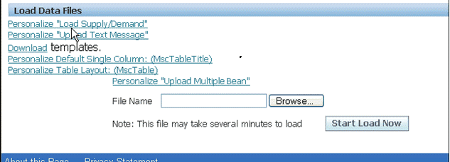

They are populated using the existing custom self-service load feature:
Role: Advanced Planning Administrator
Drill path: Navigator>Collections: Oracle System> Load Transaction Data Using Self Service Loads
When you click Load Transaction Data Using Self Service Loads, the Load Data Files window appears.
On this screen you can point to the file that contains the attributes that need to be uploaded. Each upload of this file replaces all the data that currently exists in the system.
You can use the Download Template link to obtain the format that is required to uploading attributes. The names of the attribute template files are:

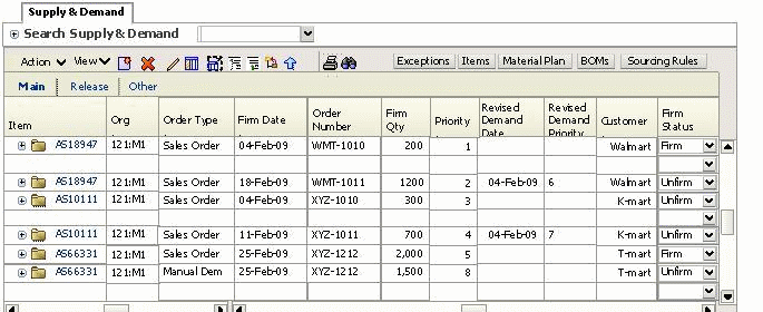

An example of an Upside and a Pull-in created using the Revised Demand Date and Revised Demand Priority fields is shown below:
In the above example, order numbers WMT-1011, XYZ-1011 and XYZ-1212 have either been pulled-in or have an upside. Order numbers WMT-1011 and XYZ-1011 are pulled-in. Notice the Revised Demand Date and Revised Demand Priority for these orders. Upside is planned for Order number XYZ-1212 by creating a new manual demand.
To make sure that Oracle Rapid Planning respects the Order Priorities that were set by the user or by an offline process, it is important to identify the Pull-ins and Upsides.
In Oracle Rapid Planning, upsides are defined as a new demand line with type Manual Demand. The priority assigned to this order, its due date, and quantity defines where it is planned in the order sequence
A Pull-in is created on a demand line if the Revised Demand Date is populated. The priority of the Pull-in is populated in the field Revised Demand Priority. The Revised Demand Date should typically by less than the Firm Date. If the Revised Demand Date is greater than the Firm date then it is a Pull-out which is possible but this is not normal.
In the example shown in the previous section on the new item attributes, note the partial pull-in, fully pull-in and upside in the results. The explanations use the information from that example.
Explanation 1
Order Number WMT-1011 is partially pulled-in as shown below:
Firm Date = 18-Feb-09 and Firm Quantity = 1200; Priority = 2
Revised Demand Date = 04-Feb-09 and Revised Demand Priority = 6
Revised Demand Date is less then Firm Date hence the order is pulled-in. The amount pulled-in is 1200 and will be planned with Revised Demand Priority 6.
Explanation 2
Order Number XYZ-1011 is pulled in fully as shown below:
Firm Date = 11-Feb-09 and Firm Quantity = 700, Priority = 4
Revised Demand Date is less then Firm Date hence the order is pulled-in. The amount pulled-in is 700 (entire quantity) and planned with Revised Demand Priority 7.
Explanation 3
Order Number XYZ-1212 has an upside as shown below:
Firm Date = 25-Feb-09 and Firm Quantity = 2000 with Priority = 5
Manual Demand created with Firm Date = 25-Feb-09 and Firm Quantity = 1500 with Revised Demand Priority = 8
The manual demand is an upside planned with the lowest priority, in this case 8.
In this case, 2000 units of the Order will be planned with the priority of a regular sales order while 1500 units will be planned with priority of a Manual Demand as an Upside. The due date for both demand lines is the same.

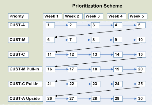

In this example, four customers are competing for supply from a common hard disk vendor. For simplicity, assume the production lead times are zero. Demands are due at the start of the week. Step one to five determine the weekly customer demands.
The demand priority (customer, pull-in, and upsides) is as shown below:
| Customer | Priority |
| CUST-A | 1 |
| CUST-M | 2 |
| CUST-C | 3 |
| CUST-M Pull-in | 4 |
| CUST-C Pull-in | 5 |
| CUST-A Upside | 6 |
Last week's customer requested demands are as shown below:
| Week 1 | Week 2 | Week 3 | Week 4 | Week 5 | Total | |
| CUST-A | 500 | 500 | 500 | 500 | 2000 | 4000 |
| CUST-M | 200 | 200 | 200 | 1200 | 1200 | 2000 |
| CUST-C | 500 | 300 | 700 | 100 | 200 | 1800 |
The incoming supply picture for the hard drive HDD1 is as shown below:
| HDD-1 | 1200 | 1700 | 1800 | 1500 | 1600 | 7800 |
Given the prioritization, the demand prioritization is as shown below:
Oracle Rapid Planning uses the above prioritization scheme in planning the customer demand.
Based on Oracle Rapid Planning's Planning logic, the weekly customer demands are planned. A temporary excess in bold in the tablet below:
| CUST-A | 500 | 500 | 500 | 500 | 3500 | 5500 |
| CUST-M | 200 | 1400 | 200 | 0 | 200 | 2000 |
| CUST-C | 500 | 1000 | 0 | 100 | 200 | 1800 |
Based on the chart above, there is an upside of 1500 units in Week 5 for Customer-A. Customers M and C have a Pull-in of 1200 units in Week 2 and 700 units in Week 3 respectively.
Normally, Rapid Planning is able to plan for the revised demands for this week, as shown in Step 6, because it has the temporary excess, (see Steps 5 and 6). If it can't plan the upsides and pull-ins from this week's revised demand, it goes back to the plan and reverts to the solution shown in in Step 5, which does not consider the revised commits.

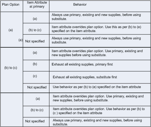

Oracle Rapid Planning supports component substitution and allows you to control how the substitution occurs and in which order it occurs. As long as demand can be met on schedule, Rapid Planning follows one of the following behavior:
When substitute parts are very similar in their specification and cost to the primary component or the substitute component is in its end-of life phase, you can use up the supply before buying or making the primary component. In such cases, you may want to use the Unhand and Scheduled Receipts of the substitute component before you create a new order for the primary component.
Sometimes it is advantageous and cost effective to create new supplies on the primary component, for example, when the substitute component is either more expensive than the primary component, or it is over-specified, such as a 4 GB card being substituted for a 2 GB card.
Perhaps it is just a poor replacement for the current item, such as replacing the required 2% resistor with 1% resistor. In a case like this, it only makes sense to substitute the primary component if you cannot meet the demand on time using either existing or new supply for the primary component.
You can switch between the two behaviors as the need arises.

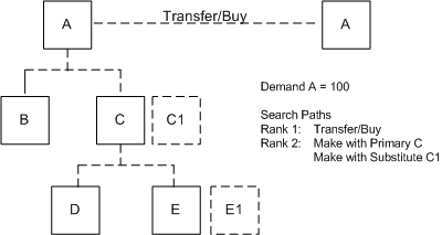

Finished good A has a sourcing rule setup of Rank 1 as Transfer and Rank 2 as make, with B and C components. C1 is a substitute for C. The search order is to transfer A to meet demand on time. If this is not feasible, then Rapid Planning uses existing supplies of C first and then existing supplies of C1.

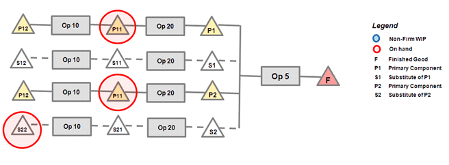

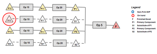

In the following example, the Finished Good (F) is made of 2 primary components (P1, P2) which have substitute components (S1 and S2 respectively). Each of these components is made using the BOM shown below.
Assuming there is on hand upstream of the substitute component, S1, the configured search path is:
Existing supplies of primary
Existing supplies of substitute
Create new supplies of primary with existing supplies of upstream components, level by level
Create new supplies of substitute with existing supplies of upstream components, level by level
Create new supplies on primary
Create new supplies on substitute
If the Demand is due on D10 and creating a planned order for S1 with existing upstream supplies (step 3 above) satisfies the Demand on D11 and creating new supplies on primary (step 5 above) on D10, the logic creates new supplies on Primary as it is the alternative that satisfies the demand on time.

| Demand Quantity | Due Date | Path | Satisfied Quantity | Date | Selected |
| 100 | D10 | P1, P11, P12 | 100 | D10 | |
| 100 | D10 | S1, S11, S12 | 100 | D11 | Yes |

For example:
Consider the case where there is upstream on hand for a component of both the primary components P1 and P2 as well as the substitute S2.
If the demand is due on D10 and if item attribute on P is set to not participate in this multi-level search, then the solver picks the option to use P1 and S2. It ignores the fact that there is existing supply upstream of P2.
Lateness Threshold = 0 days
| 100 | D10 | P1 and P2 | 100 | D10 | No used because the item attribute, Consume Before Making Primary, on $21 is set to No. |
| 100 | D10 | P1 and S2 | 100 | D10 | Yes |

The interplay between the new plan option and item attribute control is as follows:

To view and change ship sets, use view Supply/Demand, field Ship Set. The field does not have a list of values. You can use both letters and numbers for the ship set name.
To query ship sets, use search fields Sales Order Number (not Order Number) and Ship Set. Different sales orders can have the same ship set name, but a ship set only applies to one sales order. Ship set A of sales order 2222 is a different ship set than ship set A of sales order 1111. Search field Ship Set does not have a list of values.
The planning solver gives constraint details only for the order line that causes the delay in the ship set. Oracle recommends that you click on all of the order lines in the ship set, then click Constraint Details.
You can simulate adding, changing, or deleting ship sets and the planning solver plans for them:
You cannot simulate changing a sales order line to another sales order.
As you add ship sets to sales order lines, the view immediately updates the firm date of the lines to the ship set's common date.
As you change firm dates and revised demand dates of sales order lines in a ship set, the view asks if you want to change the firm dates of all lines in the ship set to this new date. If you answer No, you must remove the firm date that you changed.
You cannot mass update lines with no ship set names so that they have ship set names. Your mass update could include multiple sales orders, and the planning solver cannot calculate a common date.
You cannot mass update sales order line firm dates and revised demand dates if any of the lines has a ship set. Your mass update could not have all of the lines in the ship set, and the planning solver cannot calculate a common date.
If you give multiple manual demands the same ship set name, the planning solver plans them to ship together. However, it does not associate them with any sales orders, even if some sales orders use that same ship set name.
