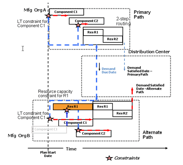

There is distribution center demand for the finished good
The distribution center sources from manufacturing organization A, rank 1, and manufacturing organization B, rank 2.
The planning solver tries to make it in organization A
Organization A satisfies the demand two days late because of lead time constraints on components C1 and C2.
The planning solver reports two constraints.
The planning solver tries to make it in organization B.
Organization B satisfies the demand three days late because of lead time constraints on components C1 and C2 and a resource constraint on resource R1.
The planning solver reports three constraints.
The planning solver recommends organization A because it is the least late.

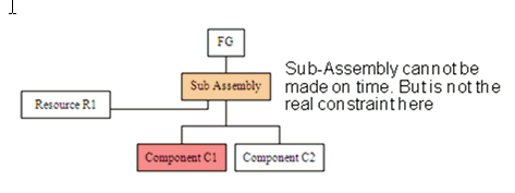

Intermediate Level Reporting
The planning solver reports the root or leaf cause of a delay
x
Finds a constraint failure on Sub Assembly because of a lead time constraint on Component C1.
Does not report the constraint failure on Sub Assembly.
Reports the lead time constraint on Component C1.

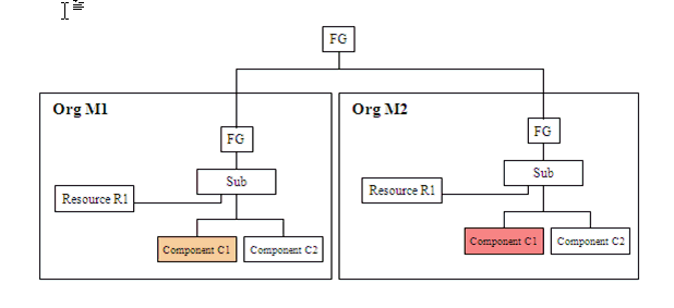

Partial Quantity Shortage Constraints
If the planning solver plans to satisfy partial quantities of a demand from multiple organizations, it reports failure constraints from all organizations involved.
In this example:
FG sources from organizations M1 and M2
The planning solver satisfies a partial demand quantity on time from organization M1. It can't satisfy the rest because of a lead time constraint on component C1.
The planning solver tries to satisfy the remaining demand quantity form organization M2. It can't satisfy it because of a lead time constraint on component C1.
It reports both failure constraints.

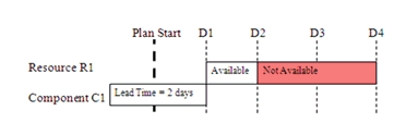

Material Constraint Caused by Resource Constraint
Sometimes, the report of a lead time material constraint is actually caused by resource unavailability. For example:
A resource is not available on the day the planning solver needs it to complete a component.
The resource is available earlier.
The planning solver plans to use the resource earlier.
Using the resource earlier causes a lead time material constraint on the component, because work on the component is scheduled to start in the past.
The planning solver reports a lead time material constraint against the component and does not report a resource constraint against the resource. However, the resource availability is the root cause of the late demand.
You can detect this situation by looking at the Pegging View and searching for time gaps.
