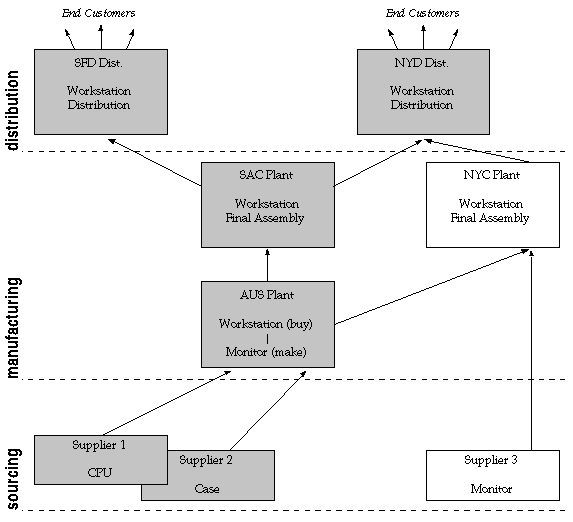

Large manufacturing and distribution enterprises, often made of a complex and interdependent network of separate inventory locations and business entities, require flexible, modular, and easily maintained plans. By consolidating enterprise-wide planning activity into a single process, Oracle Supply Chain Planning automates much of the implementation and control of material policies, reducing the need for labor-intensive monitoring and manual control of the planning process.
In Oracle MRP, the planning process satisfies requirements for multiple inventory locations, but within a single network. For example, demand is passed down from Org 1 (SAC) to Org 2 (AUS) and a Org 3 (SFO), and the supply is replenished in the opposite direction.
The disadvantage is that this model requires at least two planning runs, as each organization plans its own specific requirements. It also requires significant human intervention to ensure that information generated by one organization is passed to the other. If, for instance, SAC wanted to replenish its workstations from an additional organization (NYC), SAC would have to maintain a separate set of plans, and manually coordinate the supply coming from both.
Oracle Supply Chain Planning makes it possible to support a much more diverse and flexible enterprise. Demand for an item may be met through one or more networks of replenishment organizations. These organizations may be geographically remote, clustered into interdependent groups, but remain semiautonomous within the enterprise; they may also be members of a supplier's or customer's enterprise.
In the supply chain model, SAC produces final assemblies, which it distributes through SFD and NYD. SAC is replenished by AUS, which supplies one purchased component and one assembled component.
The advantage is that all this planning occurs with a single planning run, with attendant gains in runtime and consistency. Requirements of different organizations are planned transparently and seamlessly. You no longer need to load interorg planned orders separately. The enterprise-wide distribution requirements have been incorporated into the planning process. Sourcing strategies, formerly controlled manually by a planner implementing planned orders, can now be automatically assigned to the correct source, whether that is an internal organization or a supplier. Oracle Supply Chain Planning also allows you to expand your planning capability as your enterprise expands. SAC can easily incorporate NYC and Supplier 3 into the global plan.

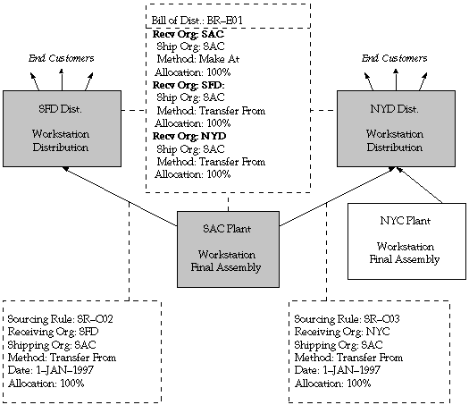

Example - Sourcing Rule/Bills of Distribution
In the following scenario, distribution centers SFD and NYD receive finished goods from manufacturing plan SAC:
Sourcing rule SR-C02 describes the replenishment of SFD by SAC. Since no other plants supply the part (which is assigned to this rule separately), the allocation is 100%. SR-C02 is a local sourcing rule because it applies to SFD only. Similarly, SR-C03 describes the replenishment of NYD by SAC.
The bill of distribution (BR–E01 in this example) can define a specific set of receiving organizations, and for each organization it can define any number of shipping organizations - each with its own allocation percentage, ranking, and shipping method. Bills of distribution are more flexible than sourcing rules because, for each organization you list in the bill, you define a range of dates and a sourcing strategy to apply within those dates. Sourcing rules can only define the dates and strategy for one organization or all the organizations in your enterprise.

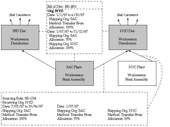

The following scenario illustrates this flexibility:
As the demand from NYD expands and exceeds SAC's capacity to meet the demand, the enterprise decides to build a new plant, called NYC. While NYC is brought online, SAC continues to meet 100% of demand from NYD. From 1-JUL, however, NYC begins to supply a small percentage of this demand, taking some of the burden away from SAC. The planning process can quickly and easily support this transition. Sourcing rule SR-C04 can define the dates during which the transition will occur, include NYC, and split the demand replenishment between it and SAC. Bill of distribution BR-E01 can accomplish this as well, but the bill can incorporate it into an enterprise–wide sourcing strategy.

Choose Copy From to copy the receiving and shipping organization information from another bill of distribution into this one.
Enter the effectivity dates for each receiving organization in this bill of distribution.
For each receiving organization, you can enter a number of shipping organizations. For each shipping organization, select a sourcing type to specify whether you make, buy, or internally transfer the item. You can also copy a list of shipping organizations from an existing bill of distribution.
Note: Suppliers and supplier sites must be predefined in Oracle Payables. See: About Suppliers, Oracle Payables User's Guide
Enter an allocation percentage for each shipping organization. Allocation percentage includes the number of planned orders issued to the part for the entire the planning horizon. Your total allocation may not exceed 100. If the allocation percentage for all the shipping organizations included within a range of effectivity dates equals 100, Planning Active is checked. If the sourcing rule is not planning active, the planning process will use the rule to assign planned orders.
Note: For bills of distribution that are already named in assignment sets, you cannot set the allocation percentage to less than or greater than 10
Enter a numeric rank value to prioritize each sourcing type. If you have two sources with the same allocation percentage, planned orders are sourced in rank order.
Select a shipping method, such as FEDEX, UPS, or rail. See: Defining Shipping Methods, Oracle Inventory User's Guide.
Save your work.

Once you have defined your sourcing rules and bills of distribution, you must assign them to particular items and/or organizations. These assignments are grouped together in assignment sets. This is where your various sourcing strategies define a particular supply chain network.
Each assignment set to represents selection of organizations and/or items you want planned. To influence the planning process, you must include an assignment set in your plan options.
In an assignment set can assign your sourcing rules and bills of distribution at different levels, as follows:
Item-Instance: An item across all organizations. If the Item field is empty, use the Reduce Criteria Window to restrict the selection.
Item-Instance-Organization: A single item in an inventory organization
Instance-Organization: All items in an inventory organization
Category-Instance: Categories of items
Category-Instance-Organization: Categories of items in an inventory organization
Instance: All organizations
These levels allow you to assign a replenishment rule to as many or as few items as possible. For example, a category of items could be defined as packaging material, and a sourcing rule that identifies the suppliers could be assigned.

You can walk up and down the bill of material and display the organization, effective dates, and assignment information for the item in your bill.
Navigate to the Items window.
Check the Item.
Choose Sources to display the Sources window.
Choose a tabbed region:
Sourcing: you can review the source organization, supplier, allocation percent, and ship method.
Effective Dates
Assignment Information: you can review the sourcing rule and assignment type.
Check the Item.
Choose Destinations to display the Destinations window.
Effective Dates
See Also
Sourcing Rules and Bills of Distribution
Defining Sourcing Rules
Defining Bills of Distribution
Assigning Sourcing Rules and Bills of Distribution

Supply Chain Planner Workbench
Setting Up and Implementing Sourcing Strategies
The Supply Chain MDS is a statement of interorganizational demand. It contains details of the anticipated shipment schedule, loaded from several sources. You can use the time–phased master demand schedule as input to the master production scheduling process, the material requirements planning process, distribution requirements planning, and, indirectly, the replenishment strategy.
Some of the demand types that the Supply Chain MDS considers are:
Item forecasts
Spares demand
Sales orders
Internal requisitions
New products
Internal material transfers
Master Production Schedule (MPS)
The Supply Chain MPS is a statement of supply required to meet the demand for the items contained in an MDS or another MPS. You can use the Supply Chain MPS to level or smooth production so that you effectively utilize capacity to drive the material requirements plan or distribution requirements plan
Loading the Supply Chain Master Schedule from Multiple Sources
In addition to standard sources, Supply Chain Planning users can derive the master schedule from DRP Planned orders. You can manually define your supply chain master schedule or modify entries loaded from other sources.
Review the section Loading the Master Schedule from Multiple Sources for further information.
