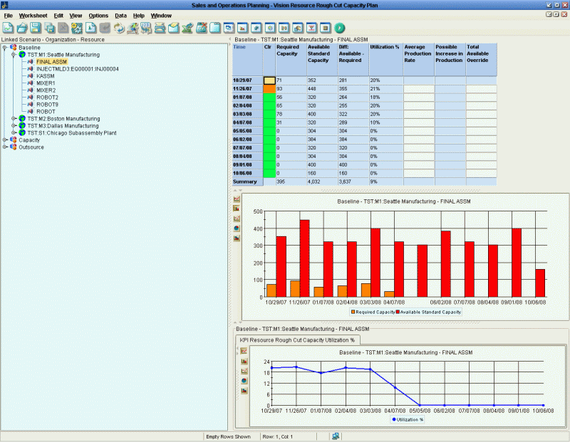

| Resource Rough Cut Capacity Plan | Machine and crew capacity-planning worksheet by scenario. |

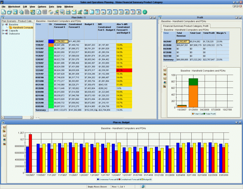

The financial review reconciles the consensus demand and operational plans with financial performance metrics.
The following worksheets are used during the financial review process:
| Worksheet | Description |
| Financial Forecast | Compares consensus plan with the financial forecast and budget. |
| Financial Summary Product Category | Compares operational plan with budget. |
| Cost Breakdown Product Category | Shows revenue and cost breakdown analysis. |

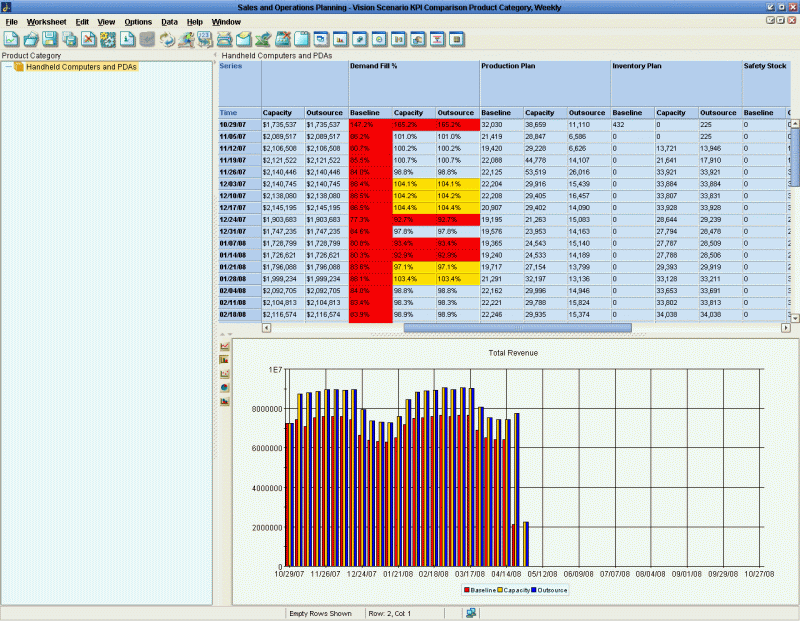

| KPI Dashboard Product Category | Displays S&OP Key Performance Indicators by scenario and category. |
| KPI Scenario Comparison Product Category | Compare S&OP scenarios by key performance indicators. |

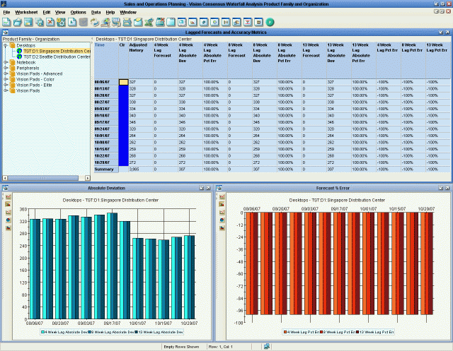

The first step in the demand review process is to look at your previous cycle and determine how accurate your forecasts were. Using the Waterfall Analysis worksheets you can compare actual versus forecast demand for individual product categories, organizations, and regions (zones). By comparing actuals to forecast, demand planners can identify problem areas, and deduce why forecast demand did better (or worse) than planned.
Note: This worksheet is essentially the same as the Demand Management Consensus Waterfall Analysis Product Category worksheet, except that the Consensus Forecast series is used for archiving, instead of Final Forecast.
The Waterfall Analysis worksheet is aggregated at the Product Category and Organization level. The following archived forecasts are used in these worksheets:
4 Week Lag Forecast: The forecast series for the current week minus four.
8 Week Lag Forecast: The forecast series for the current week minus eight.
13 Week Lag Forecast: The forecast series for the current week minus 13.
4, 8, and 13-Week Lag Absolute Percentage Error: A measure of forecast accuracy, which is calculated as actual demand minus forecast demand, and displayed as a percentage.
4, 8, and 13-Week Lag Absolute Deviation: A measure of forecast accuracy, and represents the average amount that the actual demand varies from forecast demand.
| Accessing this Worksheet | In My Worksheets (in Collaborator Workbench), click Consensus Waterfall Analysis Product Category. |
| Levels you can select | Product Category and Organization |
| Time Aggregation | Weekly |
The following series are available in this worksheet:
| Series | Description |
| Color | Legend indicating Color indicator for rolling horizon. Values are:
| Adjusted History | Unconstrained historical sales. |
| 4 Week Lag Forecast | Forecast archived four weeks prior to the current time bucket. |
| 4 Week Lag Absolute Deviation | Absolute Deviation for the forecast archived four weeks prior to the current time bucket. |
| 4 Week Lag Absolute % Error | Absolute percentage error for the forecast archived four weeks prior to the current time bucket. |
| 4 Week Lag % Error | Percentage error for the forecast archived four weeks prior to the current time bucket. |
| 8 Week Lag Forecast | Forecast archived eight weeks prior to the current time bucket. |
| 8 Week Lag Absolute % Error | Absolute percentage error for the forecast archived eight weeks prior to the current time bucket. |
| 8 Week Lag Absolute Deviation | Absolute Deviation for the forecast archived eight weeks prior to the current time bucket. |
| 8 Week Lag % Error | Percentage error for the forecast archived eight weeks prior to the current time bucket. |
| 13 Week Lag Forecast | Forecast archived 13 weeks prior to the current time bucket. |
| 13 Week Lag Absolute % Error | Absolute percentage error for the forecast archived 13 weeks prior to the current time bucket. |
| 13 Week Lag Absolute Deviation | Absolute Deviation for the forecast archived 13 weeks prior to the current time bucket. |
| 13 Week Lag % Error | Percentage error for the forecast archived 13 weeks prior to the current time bucket. |

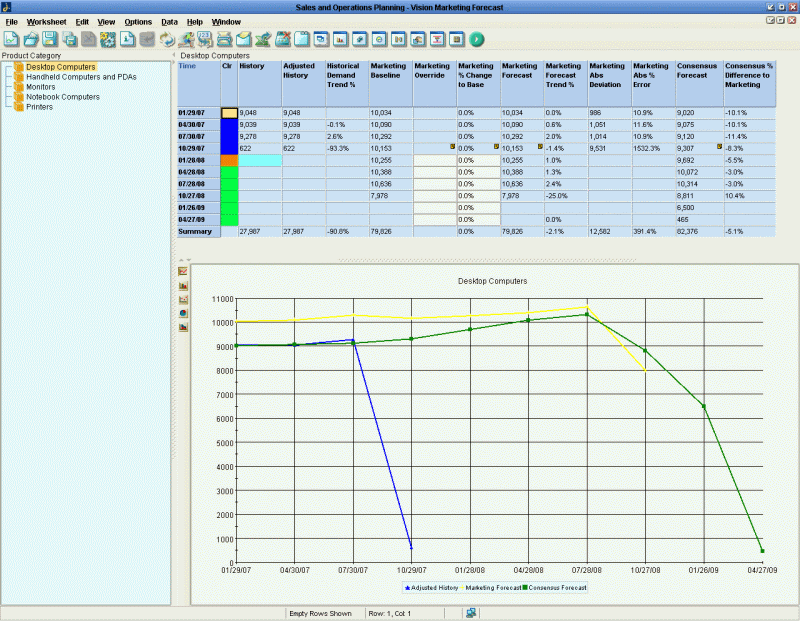

Use the Marketing Forecast worksheet to examine historical demand trends, forecast accuracy and trends for marketing stakeholder forecasts, where data is aggregated in quarterly buckets. It also provides the means to observe the difference between the Marketing Forecast and Consensus Forecast by category.
The Marketing Forecast worksheet displays a table and graph showing demand and forecast values. You can override the baseline forecast by entering either a baseline quantity or percentage.
Note: The Marketing Baseline series is not populated automatically during data collections. The administrator must specify a source for this data.
| Accessing this Worksheet | In My Worksheets (in Collaborator Workbench), click Marketing Forecast. |
| Levels you can select | Product Category. |
| Time Aggregation | Quarterly |
| History | Actual historical sales (adjusted). |
| Historical Demand Trend % | A read-only, calculated series (history only) that defines the period-over-period change in actual demand. |
| Marketing Baseline | Baseline forecast for the Marketing stakeholder. This field is read-only. |
| Marketing Override | The quantity override to Marketing Baseline forecast. This field is only editable for the forecast range. |
| Marketing % Change | User-input field representing the percentage change to the baseline marketing forecast. |
| Marketing Forecast | Marketing stakeholder forecast. |
| Marketing Forecast Trend % | A read-only, calculated series (history only) that defines period-over-period change in the Marketing Forecast. |
| Marketing Abs Deviation | Historical absolute difference between the Marketing Forecast and Adjusted History series. |
| Marketing Abs % Error | Historical absolute forecast error between the Marketing Forecast and Adjusted History series. |
| Consensus Forecast | One-number forecast derived during Demand Review (history and forecast) through weighting and/or override. |
| Consensus % Difference to Marketing | The percentage difference between the Consensus Forecast and the Marketing Forecast. |

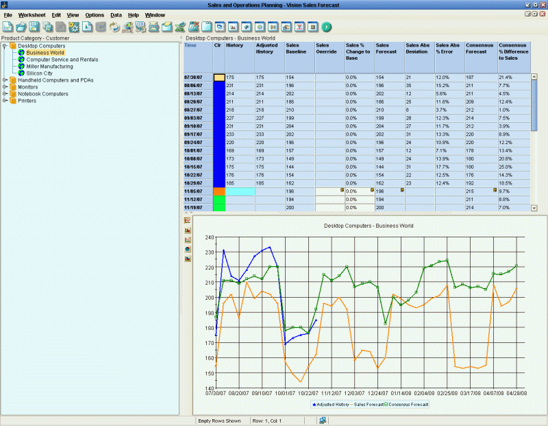

Use the Sales Forecast worksheet to analyze and update the current sales stakeholder forecast before the demand review meeting. The Sales Forecast worksheet displays a table and graph showing actual sales, forecast accuracy, and forecast values. You can override the baseline forecast by entering either a baseline quantity or percentage.
Note: The Sales Baseline series is not populated automatically during data collections. The administrator must specify a source for this data.
Sales managers can enter forecasts and observe the difference between the Sales Forecast and Consensus Forecast.
| Accessing this Worksheet | In My Worksheets (in Collaborator Workbench), click Sales Forecast. |
| Levels you can select | Product Category and Customer. |
| Time Aggregation | Weekly. |
| Sales Baseline | Baseline forecast for the sales stakeholder. This field is read-only. |
| Sales Override | The quantity override to the baseline sales forecast. This field is only editable for the forecast range. |
| Sales % Change | User-input field representing the percentage change to the baseline sales forecast. |
| Sales Forecast | Sales stakeholder forecast. |
| Sales Abs Deviation | Historical absolute difference between the Sales Forecast and Adjusted History series. |
| Sales Abs % Error | Historical absolute forecast error between the Sales Forecast and Adjusted History series. |
| Consensus % Difference to Sales | The percentage difference between the Consensus and Sales forecasts. |

Use the Resource Rough Cut Capacity Plan worksheet to plan future machine and crew capacity by plant and resource.
You can filter the worksheet to only display critical resources. If resource groups are available, then the worksheet displays resource capacity load by plant, resource group, and resource.
| Accessing this Worksheet | In My Worksheets (in Collaborator Workbench), click Resource Rough Cut Capacity Plan. |
| Levels you can select | Organization and Resource |
| Required Capacity | Amount of resource capacity required to meet demand. This series is read-only. |
| Available Standard Capacity | Regular, planned resource capacity. |
| Available Premium Capacity | Planned overtime for resource capacity. This series is read-only and not shown by default. |
| Total Available Capacity | Total planned resource capacity. This series is calculated as: (Available Standard Capacity + Available Premium Capacity). This series is read-only and not shown by default. |
| Difference Available and Required | Difference between Total Available Capacity and Required Capacity. This series is read-only. |
| Utilization % | The percentage capacity load on a resource. The series color indicates:
| Average Production Rate | Average rate of production on this resource. This series is used to calculate the Possible Increase in Production (PIP). This is a user-defined series that can be manually maintained in S&OP. |
| Possible Increase in Production | Potential available production increase. This series is calculated as Average Production Rate * (Diff: Available - Required). |
| Total Available Override | User-input override of a resource. Upon review of the capacity load, the S&OP Manager can request a revision to Total Available Capacity. For example, if Utilization % is heavily loaded (e.g. > 90%), then a request to increase Total Available Capacity is appropriate. |

Use the Financial Summary Product Category worksheet during the financial review to compare your operational plan with the budget. This worksheet displays the consensus, constrained forecast, and financial forecast (in currency) by product category and planning period. Review the quarterly financial breakdown using an embedded worksheet. When integrated with Hyperion Planning, this worksheet displays financial forecast and budget amounts imported from Hyperion.
Quickly identify below-budget plans where Diff Constrained Fcst Value Budget series < 0 and Diff Consensus Fcst Value Financial Fcst Value < 0.
| Accessing this Worksheet | In My Worksheets (in Collaborator Workbench), click Financial Summary Product Category. |
| Levels you can select | Product Category |
| Consensus Forecast Value | One-number forecast derived from Demand Review history and forecast, representing the aggregate value of items multiplied by unit prices. This series is read-only. |
| Constrained Forecast Value | Demand amount, in currency, that can be achieved given the plan's current constraints. This series appears red if Constrained Forecast Value is less then the Consensus Forecast Value series. This series is read-only. |
| Financial Forecast Value | Financial revenue forecast including actuals to date. When integrated with Hyperion, this series contains the Financial Forecast scenario. |
| Diff Consensus Fcst Value Financial Fcst Value | The difference between the consensus forecast value and the budget. This series is read-only. |
| Budget Value | The budget forecast, in currency, by which a company wants to track against financially. The series color indicates:
| Diff Constrained Fcst Value Budget | Difference between the Constrained Forecast Value and Budget Value series (for both history and forecast). If this series is less than zero then the plan is below budget. This series is read-only. |
| Abs % diff Constrained Forecast Value and Budget | Percent difference between the Constrained Forecast Value and Budget Value series (for both history and forecast). |
| Total Revenue | Total plan revenue in currency. This series is calculated as ((History or Constrained Plan) * Unit Price). |
| Total Cost | Cost, in currency, of producing goods sold. This series is calculated as ((History or Constrained Plan) * Unit Cost). |
| Total Profit | Total Revenue – Total Cost. |
| Margin % | Percentage gross profit. This series is calculated as Total Profit / Total Revenue. |

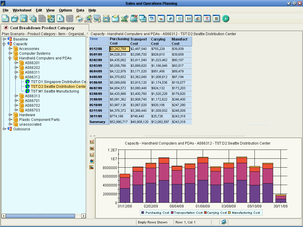

Use the Cost Breakdown Product Category worksheet to understand the cost trade-offs between plan scenarios and to make the most profitable choice. It analyzes revenue and cost data from planning.
For example, an Oracle Strategic Network Optimization scenario might indicate higher transportation and supply costs due to outsourcing but another scenario might reflect higher manufacturing and storage costs.
Reference
| Accessing this Worksheet | In My Worksheets (in Collaborator Workbench), click Cost Breakdown Product Category. |
| Levels you can select | Plan scenario, product category |
| Time Aggregation | 4-4-5 |
These are the series in the worksheet.
| Revenues | The revenue generated by fulfilled demand. |
| Total Cost | Purchasing Cost + Transportation Cost + Carrying Cost + Manufacturing Cost |
| Purchasing Cost | The supplier sourcing cost. In the KPI view, it is Supply Cost. |
| Transportation Cost | The cost of inter-org transfers and customer shipments. |
| Carrying Cost | The cost of storing inventory, for example, safety stock. In the KPI view, it is Inventory Cost. |
| Manufacturing Cost | The operating cost of machines and crews. |
| Total Profit | Revenue - Total Cost |
| Margin % | Percentage gross profit. Total Profit/ Revenue. |
These series are available in the stacked bar chart graph.
| Purchasing Cost | The sourcing cost of items from suppliers |
| Transportation Cost | The cost of inter-org transfers and shipments to customers |
| Carrying Cost | The cost of storing inventory, for example, safety stock. |
SNO KPIs include cost category Other Costs. You can also use this category to model costs, for example, receiving and shipping costs from an organization.

The KPI Dashboards are worksheets that display all S&OP Key Performance Indicators by scenario and category (excluding resources). At the category level, you can drill-down to other worksheets using the Open With menu.
| Accessing this Worksheet | In My Worksheets (in Collaborator Workbench), click KPI Dashboard Product Category. |

Use the KPI Scenario Comparison Product Category worksheet to compare S&OP scenarios by key performance indicators. By selecting in a column in the table, such as Demand Fill %, the graph updates to display that KPI.
To update the KPI graph for filtered scenarios, select the appropriate KPI column in the table.
| Accessing this Worksheet | In My Worksheets (in Collaborator Workbench), click KPI Scenario Comparison Product Category. |
| Total Revenue | Total plan revenue in currency. |
| Total Cost | Cost, in currency, of producing goods sold. |
| Demand Fill % | Percentage of met demand. This series is calculated as (Constrained Forecast / Consensus Forecast). This series color indicates:
| Production Plan | Planned production levels for both history and forecast. |
| Projected OnHand | Projected forecast and history inventory levels. This series appears amber if its value drops below the Safety Stock series. |
| Inventory Plan | Historical and projected inventory levels from Strategic Network Optimization (if used). |
| Safety Stock | Safety stock level (history and forecast). |
| Periods On Hand | Projected number of periods' inventory that are currently on-hand. |
| Inventory Periods On Hand | Projected number of periods' inventory for planned levels imported from Strategic Network Optimization (if used). |
| Safety Periods On Hand | Projected number of periods' safety stock that are currently on-hand. |
