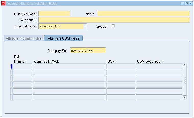

You use the Movement Statistics Validation Rules form to define and maintain the following rule types:
Attribute Property Validation Rules: used to validate movement transactions in order to properly report transaction information
Alternate Unit of Measure (UOM) Rules: used to set up alternate units of measure to the default unit of measure
Oracle's movement statistics solution provides a pre-seeded (pre-loaded) attribute property validation rule set called Standard_Validation. You may also define you own validation rule.
There is no pre-seeded Alternate UOM. If you require Alternate UOM Rules, you must define your own.
Whether you define your own validation rules or use the pre-seeded one, you use attribute property validation rules to specify what data is required for your specific reporting needs.
Oracle's Validation Rules and Exception Report work together: if required data is missing or incorrect (as specified by a validation rule) an exception will be raised and listed on the Movement Statistics Exception Report.
Movement Statistics Validation Rules Window (for Attribute Property Rules)
Movement Statistics Validation Rules Form (for Alternate UOM Rules)
Define the Attribute Property Rule Set: Optionally, define a new attribute property rule set.
Note: A pre-seeded Attribute Property rules Set name : Standard_Validation is provided.
You do not need to perform this step if you plan to use the pre-loaded rule set.
Define the Alternate UOM Rule Set: Define the Alternate UOM Rule Set.
Note: There is no pre-seeded Alternate UOM rule Set.
You use the same window to define the Attribute Property and the Alternate UOM.

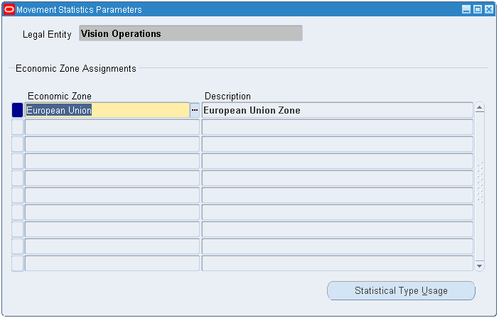

Use the Movement Statistics Parameters form to define and maintain the parameters for gathering movement statistics. The parameters that you define are used by the Movement Statistics Processor to collect movement transaction data and create movement statistics records.
The Movement Statistics Processor captures and report movement statistics by legal entity. You are required to define Movement Statistics Parameters for every legal entity to capture statistics.
You use two forms for defining and maintaining Movement Statistics parameters:
Movement Statistics Parameters Form

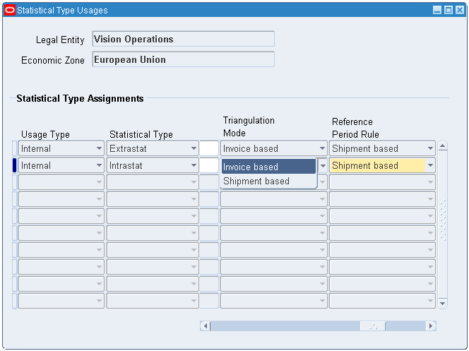

Statistics Type Usages form
Movement Statistics Statistical Type Usages Form
Define Movement Statistics Parameters Process
Define the legal entity economic zone assignment (required): You must assign the economic zones to the legal entities where you plan to capture movement statistics data.
Note: You must assign an economic zone to every legal entity that you use.
Define the legal entity economic zone parameters: Define the specific usage types, statistical types, and other parameters for the legal entity economic zones.
Note: You must assign parameters for all legal entity economic zone pairings that you define.

The Economic Zone parameter defines the behavior of Oracle's movement statistics solution. You must define the parameters for every Legal Entity - Economic Zone pairing you have defined. The following parameters must be set:
| Parameter | Possible Values | Comments |
| Usage Type | Internal External |
Internal: Movement of goods within countries of the specified economic zone External: Movement of goods from a country of one economic zone to a country outside the economic zone |
| Statistical Type | Intrastat Extrastat |
Intrastat: Declaration of imports and exports within EC Extrastat: Declaration of import and exports between EC and countries external to EC |
| Period Set | Period Set Name | Select a Period Set (from LOV) that reflects your reporting frequency (monthly, quarterly) |
| Period Type | Period Type | Select a Period Type (from LOV) to use for reporting. Note that the calendar you use for statistical reporting purposes is independent of the accounting calendar for your organization's set of books. |
| Start Period End Period |
Assign the first period for which the Usage / Statistic type assignment is valid. Optionally, enter the last period for which this assignment is valid. |
| Weight UOM | Weight Unit of Measure | Enter the default UOM. Note: INTRASTAT requires weight (mass) to be reported in KG |
| Precision | 0 to 5 | Enter the number of decimals the total weight should be rounded to. The default value is 0 (zero) meaning the weight will be rounded to the nearest digit. |
| Report Rounding | Possible values:
Set up how the calculated weight will be rounded:
| Dispatch KIT Method | Possible values:
Indicates how movement records should be created for KIT dispatches:
| Entity Branch Reference | Entity Branch Reference | Enter the name of the legal entity branch. Note: this reference is printed on the European Union INTRASTAT and EXTRASTAT declaration. |
| Conversion Type | Conversion Type | Select the currency conversion type (from LOV) to use to convert foreign currency amounts to the functional currency of your organization's set of books. |
| Conversion Option | Conversion Option | Select the conversion option (daily or last day of the period) to convert foreign to functional currency. |
| Category Set | Category Set | Select the category set that you defined for the INTRASTAT Commodity Codes. Note: you must define category sets (see: Commodity Codes using Category Sets in this guide). |
| Tax Office Code | Tax Office Code | Enter the Tax Office Code of the tax office to which your legal entity reports. |
| Tax Office Location Code | Tax Office Location Code | Enter the Name for the tax office to which your legal entity reports. |
| Attribute Rule Set | Enter the validation rule set code. | The default rule set is 'Standard_Validation'. You may define your own rule set. |
| Alternate UOM Rule Set | This parameter is optional. | You will need to define an Alternate UOM Rule Set. |
| Triangulation Mode | Invoice Based Shipment Based |
Triangulation Mode determines how the Movement Statistics Processor will process Triangulation (drop-shipments): Invoice Based: the processor will process movement transactions based on the flow of the invoice Shipment Based: the processor will process movement transactions based on flow of goods See: Triangulation Support in the following section of this chapter. |
| Reference Period | Shipment Based Invoice Based |
Shipment Based: the date that the transaction took place Invoice Based: the date the transaction was invoiced Refer to the Reference Period section in this chapter |
| Advance Invoice Days | User Defined | The number of days the processor should look for an advance invoice |
| Pending Invoice Days | User Defined | The number of days the processor should look for an invoice in the period following the movement transaction |

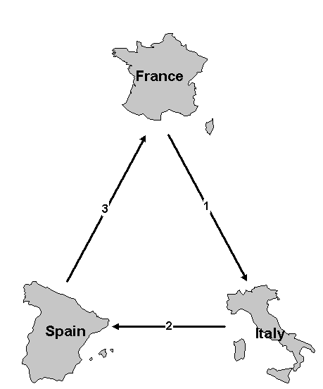

Oracle's movement statistics solution supports triangulation. This section will:
Review Oracle's movement statistics solution support of triangulation
Define triangulation using examples to illustrate triangular trade transactions
Describe the setup for making triangular trade declarations
Oracle's movement statistics solution supports triangular trade with the concept of ‘triangulation mode.' Triangulation mode specifies how the Movement Statistics Processor analyzes and generates movement statistics records when it encounters a triangular trade transaction. You must determine how you will report triangular trade transactions by setting this parameter. There are two possible values for the Triangulation Mode parameters:
Invoiced Based
Shipment Based
The default Triangulation Mode parameter is invoiced based.
Invoiced Based - the Movement Statistics Processor creates movement statistics records based on the issue of an invoice only. A movement record will be created for the invoice and not for the physical movement of goods.

This section will define triangulation using the following examples:
Transaction between three trading partners in three countries
The resulting movement records created, based on both Shipment Based and Invoiced Based Triangulation Modes, will also be described.
The example used here is a simple triangular trade transaction. Many variations are possible, including, but not limited to:
Transactions involving trading partners in countries within an economic zone
Transactions involving trading partners in countries outside an economic zone
Transactions between trading partners in two countries
Transactions between four trading partners in three countries
Note that the countries used in the examples are for illustration purposes only, you may substitute any country of your choosing.
For the purposes of defining triangular trade the following triangulation example will be used:
Your Company is located in Italy and using Oracle's movement statistics solution
Your Supplier is located in Spain
Your customer is located in France
The following triangular trade takes place:
Your customer in France places an order with you in Italy.
You source the order from Spain.
Spain ships directly to your customer in France (goods are not shipped to Italy but directly from Spain to France).
The triangular trade results in the following transactions:
You send a sales order to your customer in France
You invoice your customer in France, creating the receivable
You create a purchase order for your supplier in Spain
Supplier in Spain sends you an invoice, creating the payable
Spain creates a shipment to France, satisfying the sales order

You must set the Reference Period Parameters using the Statistical Type Usages form.
Statistical Types Usages Form
The Reference Period Parameter values determines how the Movement Statistics Processor assigns the reference date. There are two possible values for this parameter:
With this rule, the Movement Statistics Processor assigns the reference date based on the date the transaction took place (for both dispatches and arrivals). Note: this is the default Reference Period Rule.
With this rule, the Movement Statistics Processor assigns the reference date based on the invoice date (for both dispatches or arrivals).
The Invoice Based Reference Period Rule requires that two additional parameters be set:
Advance Invoice Days: this parameter specifies the number of days the Movement Statistics Processor and the Exception Report should search for an advance invoice (in the case where a transaction was invoiced before the movement transaction). The default value is 30 days, you may enter any whole number for this parameter. When the Advance Invoice Days parameter is set to 30, the Movement Statistics Processor will search for an advance invoice for 30 days prior to the date of the movement transaction.
The general rule for default Advance Invoice Days: if there is less than a 30 day difference between invoice date and transaction date, the invoice date becomes the reference date for declaration purposes.
For example (using the default Advance Invoice Days value):
| Transaction Date | Invoice Date | Reference Date |
| June 25 | No Invoice | July 15 |
| June 25 | June 1 | June 1 |
| June 25 | June 20 | June 20 |
| June 25 | May 1 | June 25 |
Pending Invoice Days: this parameter specifies the number of days the Movement Statistics Processor and the Exception Report should 'wait' for an invoice after the start of the following period, if there is no invoice on the date of the movement transaction. The default value is 15 days, you may enter any whole number for this parameter. When the Pending Invoice Days parameter is set to 15, the Movement Statistics Processor will 'wait' for an invoice for 15 days from the start of the period following the movement transaction.
The general rule for Pending Invoice Days if using the default of 15 days: if an invoice is not received by the 15th day of the month following the movement transaction, the reference date is the 15th day of that month.
For example (using the default Pending Invoice Days value):
| June 25 | July 16 | July 15 |
| June 25 | July 10 | July 10 |
To change the Reference Period Rules, the status of all movement records in all periods must be set to FROZEN. You will not be permitted to change Reference Period Rules if this condition has not been met. A message on the Movement Statistics Details form will be displayed if you attempt to change Reference Period Rules before this requirement is met.

Define Alternate UOM Rule Set
Alternate UOM rules permit you to report specific commodity code transactions in a unit of measure other than the default UOM.
Alternate unit of measure rules are used in conjunction with the default Weight UOM. You define a default weight UOM when you set up Movement Statistics Parameters. Every transaction will be reported in the default UOM you have specified.
If your reporting needs require that you report movement transactions in a unit of measure other than the default unit of measure that has been specified, you will have to define one or more alternative UOM in which to report. For example, your default UOM is kilograms. However your movement of goods declaration includes the transportation of diamonds. Instead of reporting diamonds in KG, you want to report them in carats. Using the Movement Statistics Validation Rules form, you would specify an alternate UOM for the commodity code in which diamonds falls.
Note that you define an alternate UOM for a commodity code and not an item.
Note: If you define an Alternate UOM rule set, you must assign the rule set in the Movement Statistics Parameters form.
Change the Rule Set Type to Alternate UOM.
Assign a rule number.
Select a Commodity Code from the LOV.
Select a UOM from LOV.
Update the Movement Statistics Parameters form with your new Alternate UOM Rule Set.
