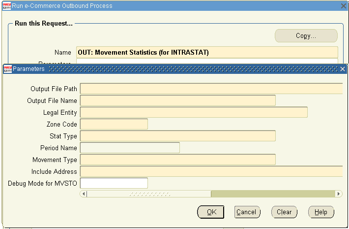

Enter all the required parameters to extract movement statistics records.
Select the Movement Statistics (MVTSO) transaction to transmit movement statistics.
From the e-Commerce Gateway, run the concurrent program OUT: Movement Statistics (for INTRASTAT). The output file for the concurrent program is generated:
At the location specified in the parameter Output File Path in the database tier, if the profile option ECE: File Location is set to Database File System
At the folder $APPLCSF/EBS_DBXFER/ec/ in the Apps tier, if the profile option ECE: File Location is set to Application File System

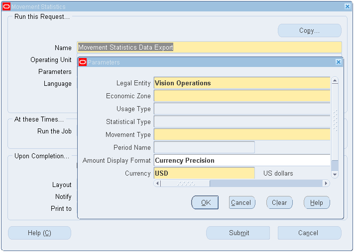

Movement Statistics Create Export Data Concurrent Program
Run the Movement Statistics Official Summary Report to update the status to FROZEN.
The status of all records for the specified period must be 'frozen' before running the Data Export concurrent program.
Run the Movement Statistics Data Export concurrent program.
Enter the following parameters to submit this concurrent program:

This concurrent program creates the data export file that can be imported into IDEP.
Verify that the concurrent program completed successfully.
